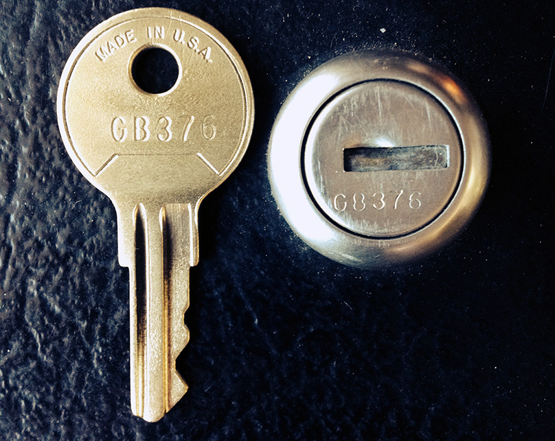

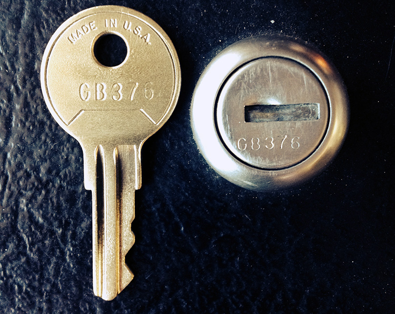

Ron, none of my accessories that I have here at the house had any serials on the locks except one. The hard pocket cover for my WJIV. The serials kinda matched.. The key is GB376 and the lock is G8376. o_O
