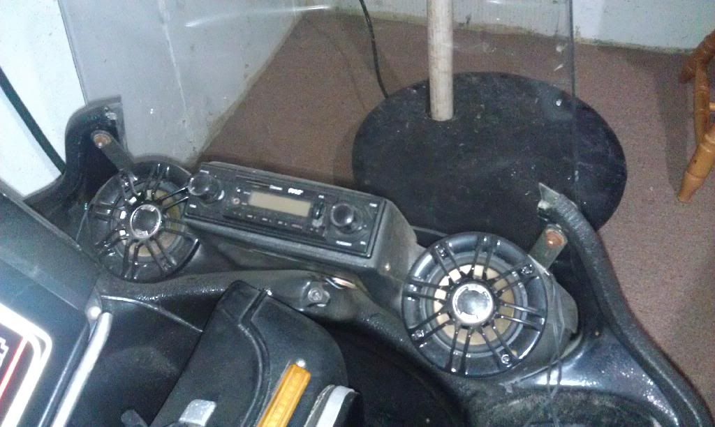

FYI: You need to use the Polk Audio Speaker covers not the stock CycleSound or VetterSound covers if you buy them. ;) I painted mine black.
Metal_Bob
Pre-painted poor view of those polk speaker covers. I'm sure I have better somewhere, or run to basement to take a dusty photo...

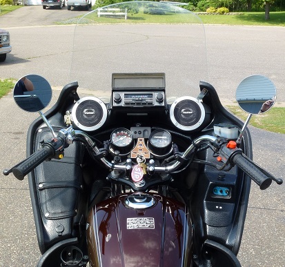

I've never used anything but the two brackets. One of these day (real soon) I might need to put those other two bolts in... I recently got the hood for the gauge cluster for my Wing and I think I might need that extra space.
roncar
I've never seen documentation on this variation, but it does not use the two brackets. Attaches to the upper bolts thru the case.
