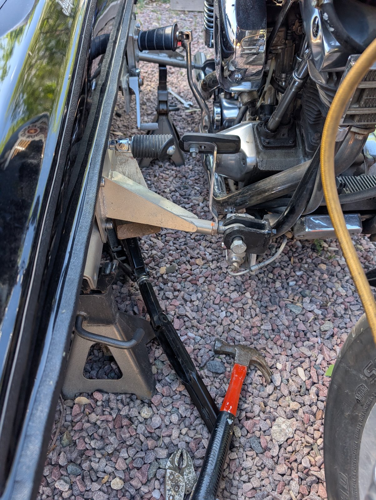

I need to get my 81 shovel into the shop without the sidecar currently mounted (to put new sprockets on it for handling the new load better). I've never taken it apart before, I just got it on the road two months ago. It has a 3 point mounting setup.
I know I need to very lightly jack the sidecar near the two lower mounts, put a couple jack stands underneath, and then I believe I'm supposed to disconnect the two lower mounts at the bike first, then the upper mount. I plan to do this with someone sitting on the bike with the kickstand down. What am I missing, to ensure I don't damage the sidecar or my bike??

Take the turnbuckle off first and have bike leaning on side stand. Swing away front mount first and set on jack. Same with back mount. Walk bike away. Single person job. Easier with an extra body.

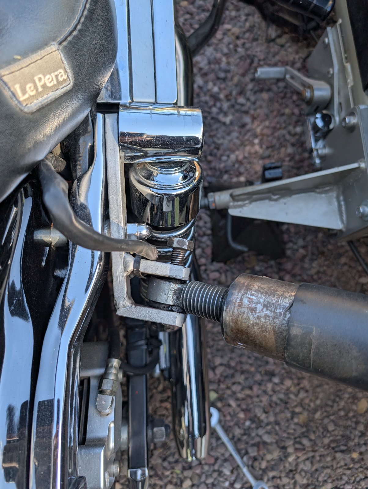

How’s the loose turnbuckle? Are you sure it turned in or did something bend?
I can say at this point that it definitely turned in. I don't see anything bent. I rolled it back out, but had to use a pipe wrench to do it. Once I get the sidecar off I'll do a little further investigation.
Mine was pipe wrench tight when I got it. Soaked in solvent. Fully extended threads and dressed with a wire brush until turning by hand. Never moved on its own.
Are the two lower mounts solid? Little wiggle somewhere changing dynamics on the turnbuckle threads?
It is hard to understand how it freely loosened but took a wrench to turn it back. Inspect those threads and amount of play with it off the bike. It’s a welded assembly. The bolts have stops inside and will not come out.
Okay, I'll do that. Thanks. I'm to bolts loose, Jack stands under, Jack available.
Front lower is going to come out if I wiggle it now, so I must have a good negative bind on the front.
I will thoroughly inspect the turnbuckle at all connections to make sure there's nothing else going on there.

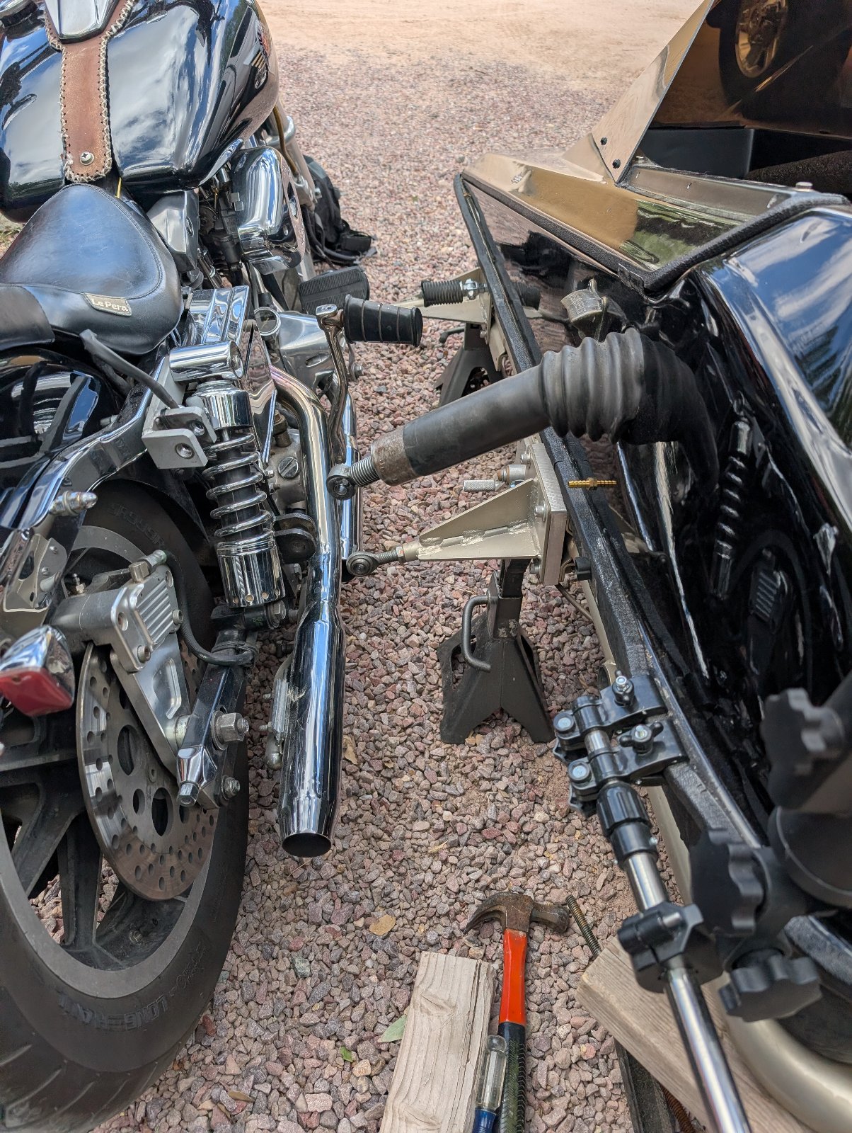

Apaart, and now safely to the shop. Thanks for the help. 👍
