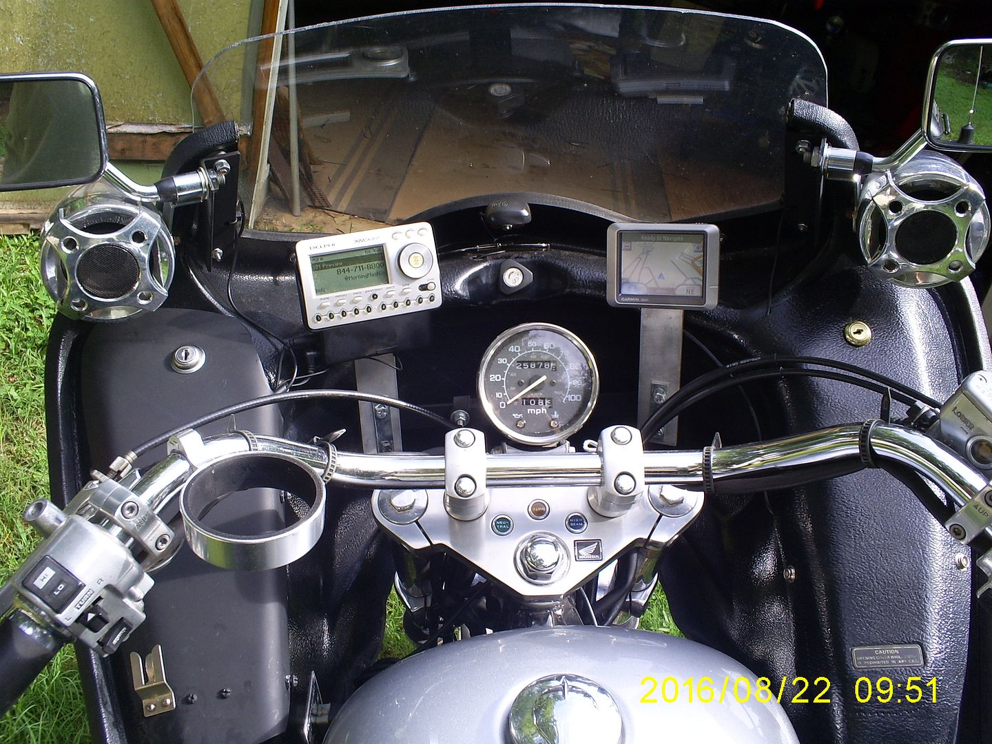

I'm not really concerned with speaker size. Just one I could modify for a DIN Radio cage and use a modern radio in it. I have a Windjammer 4 so it would need to fit that fairing as well. The one with the smaller speakers might be best for me as I can remove the 3" speakers I already have and mount them in the housing. You can see my speakers just below the mirrors. My Bike is a 2006 Honda VLX 600 so I don't want a vintage radio and speakers in it.What are you looking for? Older with the smaller speakers or the newer with larger speakers? Vetter Sound, Cycle Sound?

I don't think that over cut will be a problem even if it shows past the radio bezel. I can make the gasket a little larger so it covers it.
Unless you can flip the mirror mounts and attach them to the front-side of the fairing.I would also be forced to move my mirrors back to the handlebars as my fairing mounted mirror mounts would be in the way of the Cycle Sound housing.

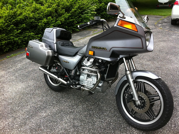

No way to mount them on the front side. The top mount is a clip so there is no hole through the windscreen for a bolt. I may make a trim peace that would attach to the lower windscreen screws and attach mirrors to it like Honda did with the old GL500 Silverwing. I'll need new mirrors to do that. I actually don't mind moving the mirrors back to the handlebar. I do miss being able to move the handlebar one way or the other so I can use the mirrors to see behind before pulling out onto the road. As it is now I must twist my head around to do that. I'd been thinking about moving them except I needed the mounts for the speakers as well. Now that the speakers are going into a Cycle Sound that's no longer an issue.Unless you can flip the mirror mounts and attach them to the front-side of the fairing.
I understand that sentiment. After mounting my W5, it took me quite a while to realize that, no matter how many times I twist the handlebars, the headlight is just not going to swivel with them anymore.I do miss being able to move the handlebar one way or the other so I can use the mirrors to see behind before pulling out onto the road.
Yep! I have a band saw I can use to make a copy of that trim peace the mirrors mount on. I'd use aluminium and paint it black so it blends in. I think I'd go with black mirrors as well.Find a pair of 1100 Goldwing mirrors on throw them out front.
