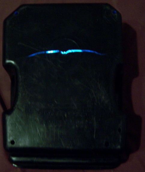

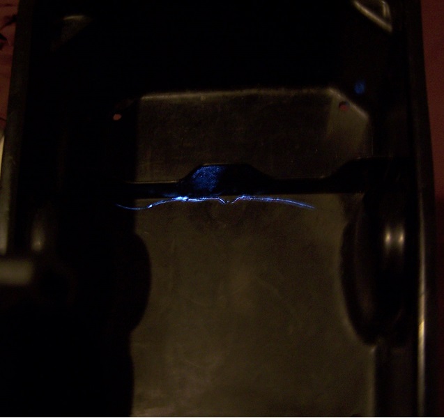

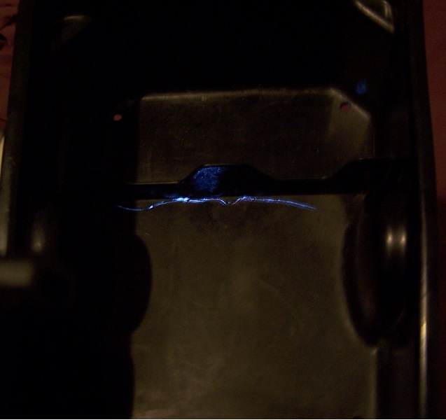

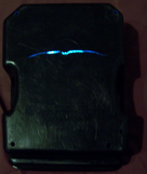

Roncar, you can take a solder gun and heat up the plastic and repair that crack. To add strength to it, just add a strip of plastic to the back side.
