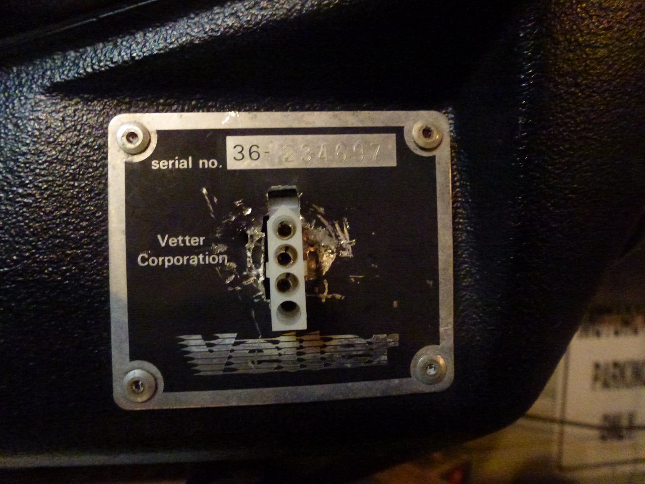

I found that if the trunk still has the original plug, a turn signal plug from a windjammer will work.
Otherwise you can replace the plug by shaving the original plug hole and replacing it with a Radio Shack 4 prong plug. This way if you want to use the trunk light as turn signals, you just need to add the extra wire.
Female: #274-234

Terraplane Tom
As you can see in the picture, whoever had this trunk before me just destroyed the serial plate. A lot of the trunks have the internal wire harness but are missing the bike harness, because people take off the trunk, sell them, and forget to remove the bike's wire harness. And because of this the next person pulls the old trunk plug and tries to replace it with a car trailer wire kit. It doesn't work well and looks like crap. That's why I went with the 4 wire plug from Radio Shack to give it a somewhat original (as best as it can be) look.

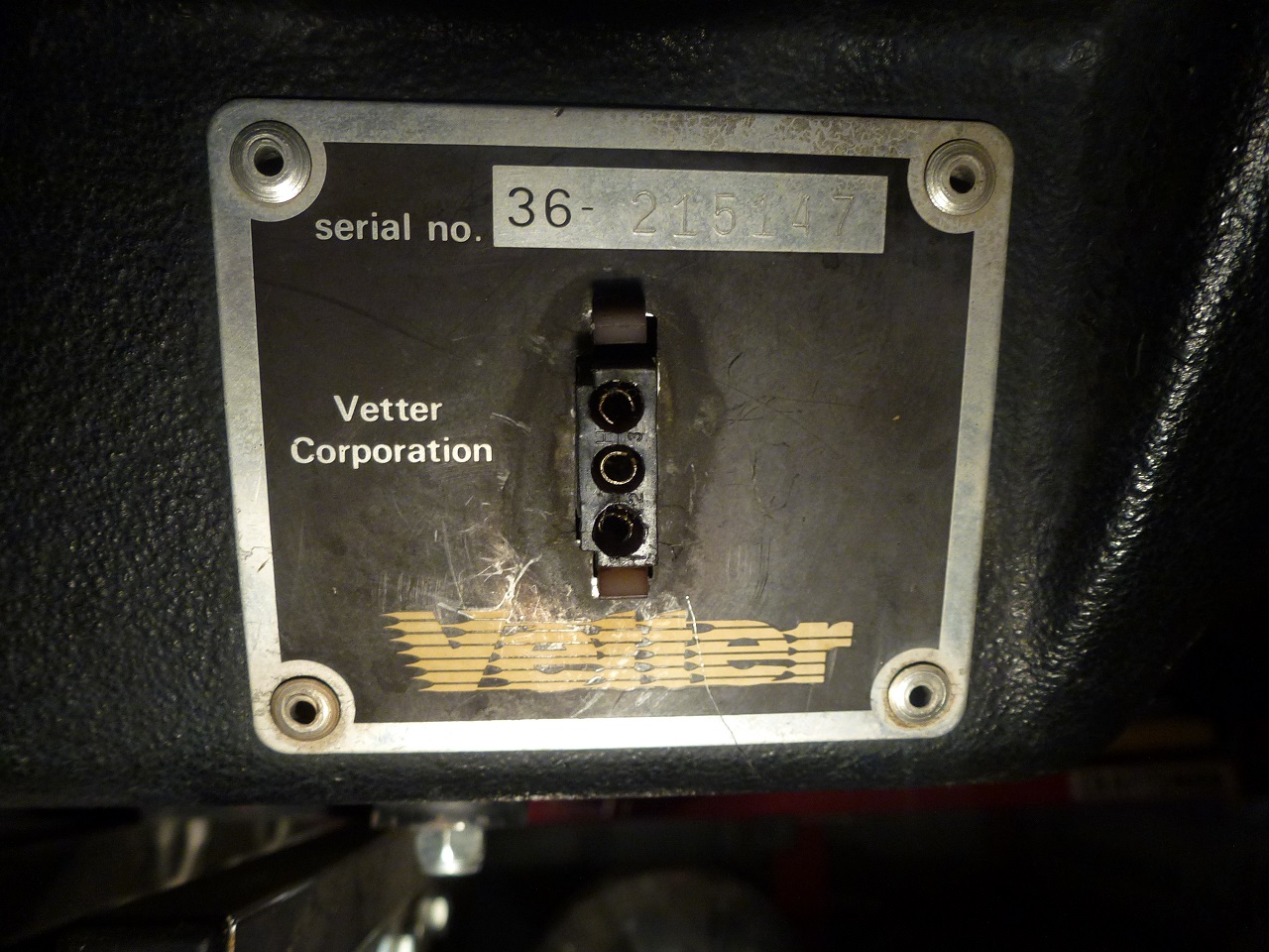

Just curious now... what does the original connector look like? I have had two trunks, and both have had no connectors: just wires running through the hole Up until this thread, I was not aware that a connector existed.
Terraplane Tom

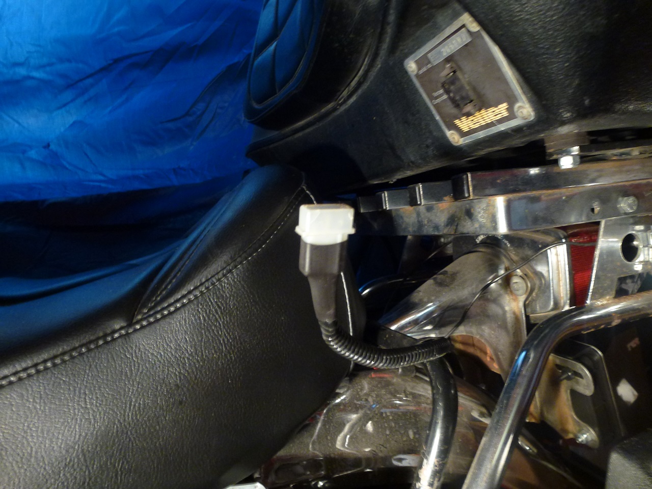

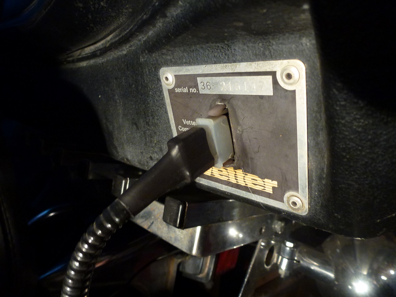

Here's 3 pictures: The first is of my original trunk plug.

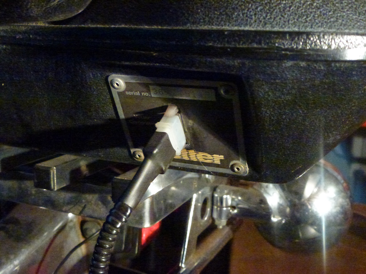

The second is the plug I made using the connector from a turn signal plug.
The third is them put together.
Sometimes when you don't have or can't find originals you have to make do with what is available.
