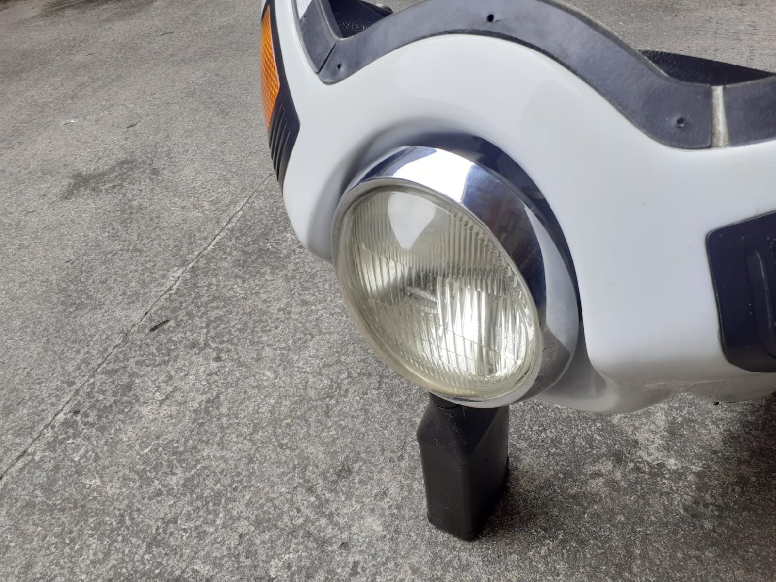

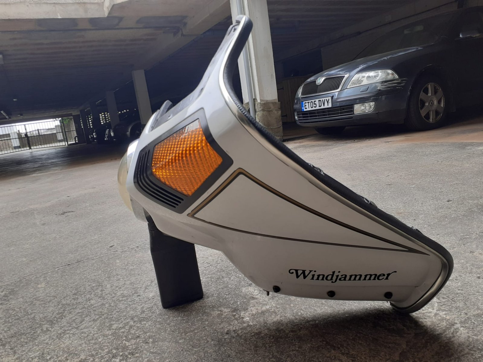

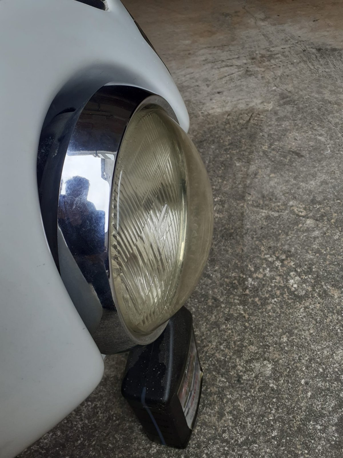

I have just acquired a Windjammer IV, serial no. 37-499383 it is immaculate in white, it is that good I'm not sure if I want to colour code it to match the bike, there is barely a mark on it, even the cig lighter is unused. There is a thin plastic bubble covering the headlight that has faded yellow a bit, is this a standard part? I can't find any mention of it anywhere, it seems to be a perfect fit. The locking lid has no key, luckily, my neighbour is a locksmith, so when I can catch him I'll get it open and see if there is any buried treasure...
There are a few features that need explaining so I'll get some pics sorted. So many questions......

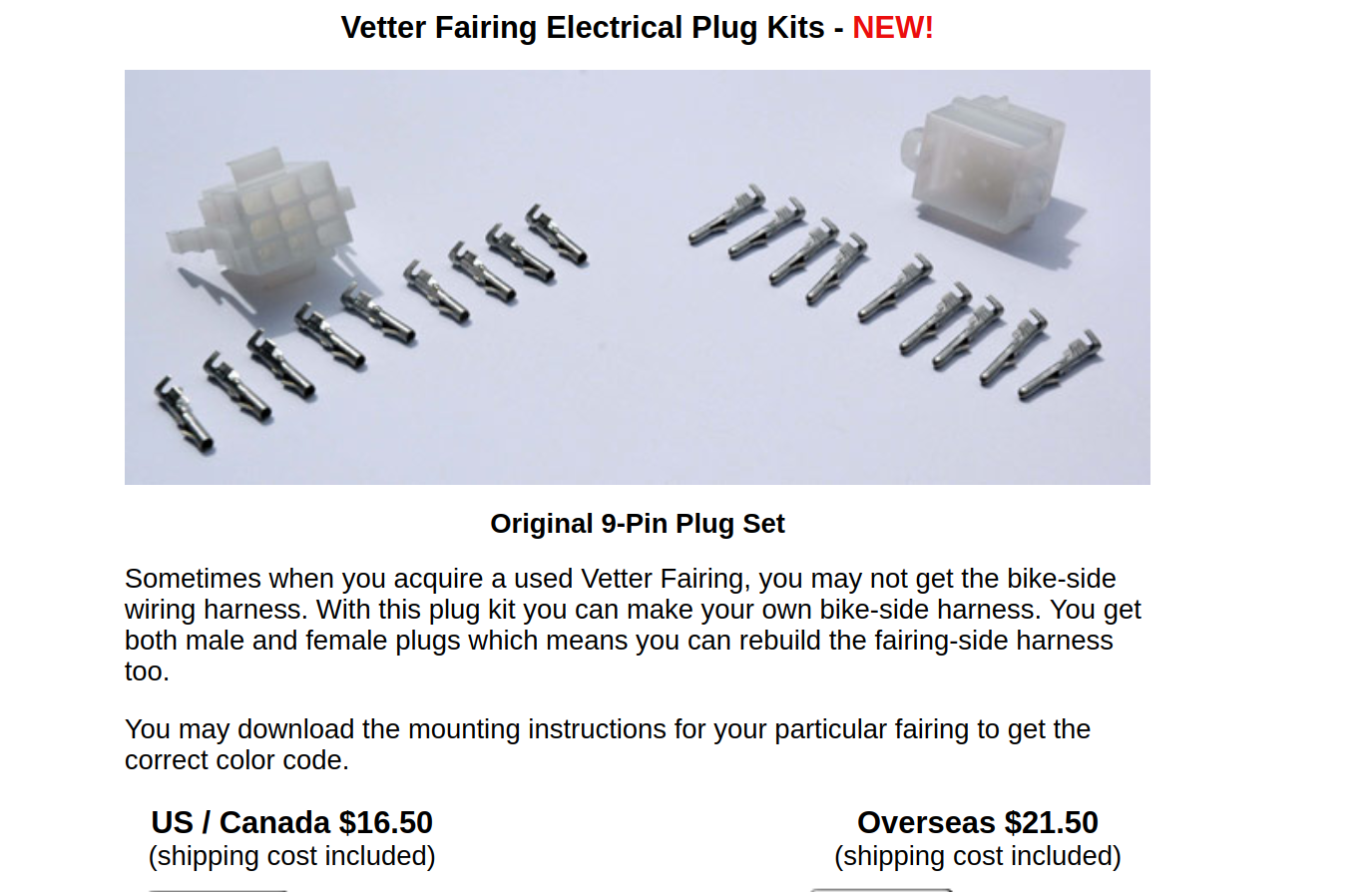

Craig used to have a replacement parts store on his website. I don't know if you are aware, but Craig had a really bad accident several years ago. He pretty much shut his store down after that. Here is a screenshot from an archive site showing what he used to offer.
I have had some success emailing his wife, and she will sell me parts, but it has been a few years since I've been in touch with her. If you like, I can try to reach out to her. Keep in mind, the prices may be quite different from what appears below.

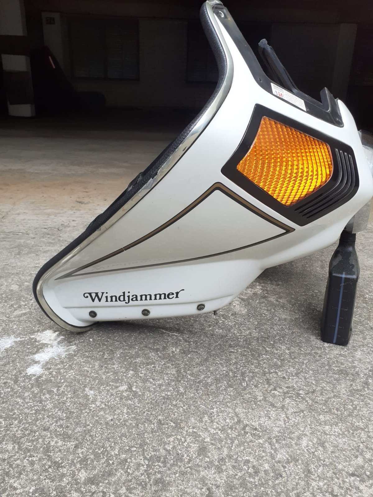

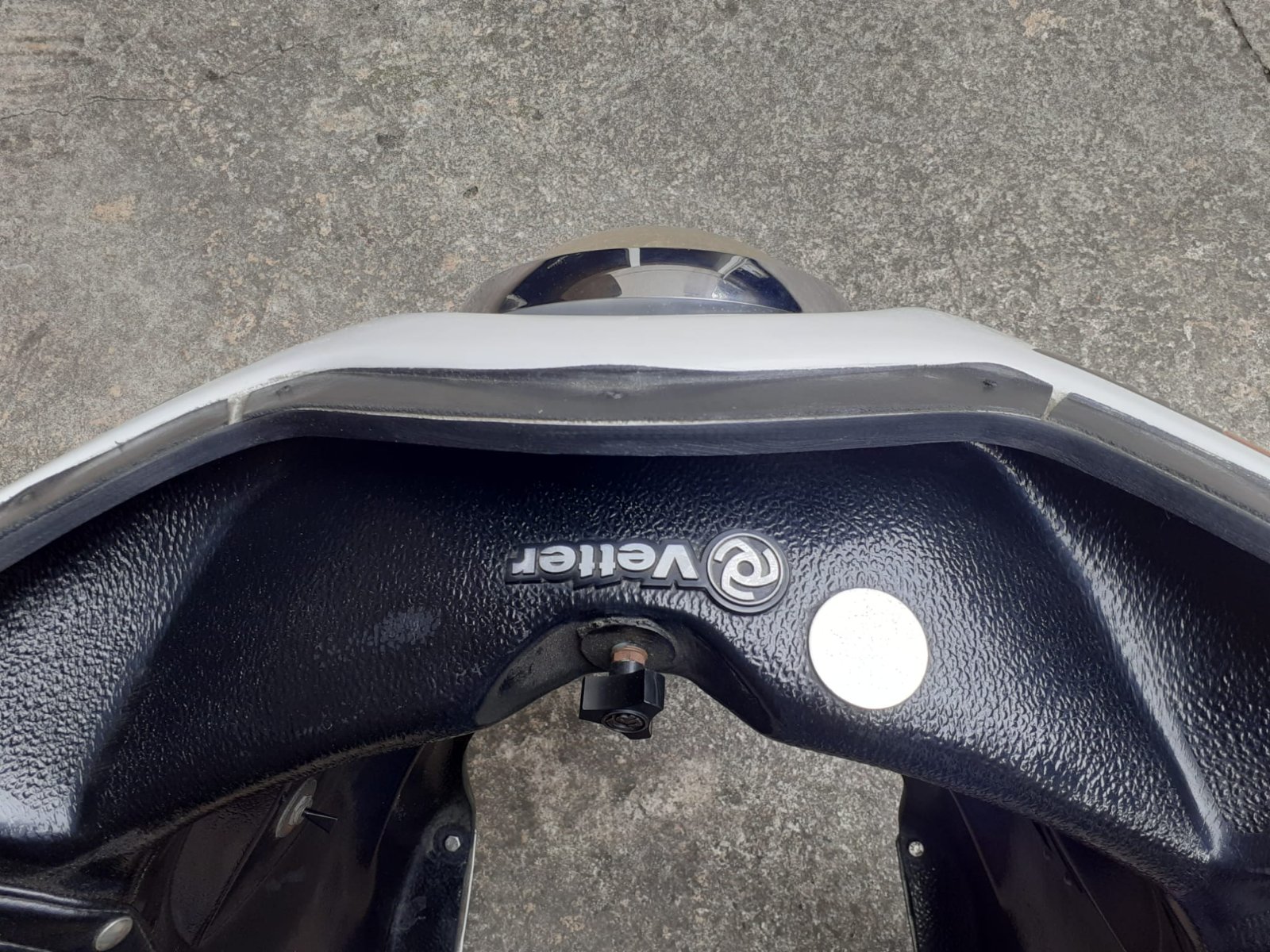

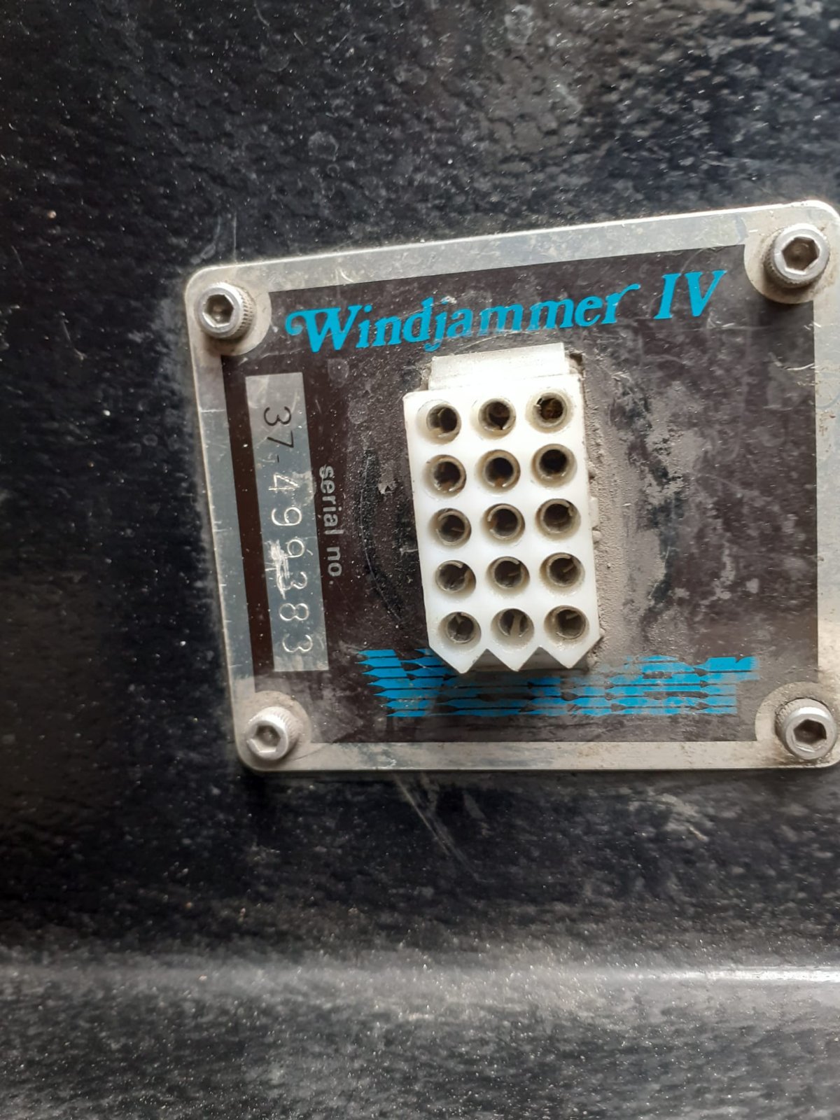

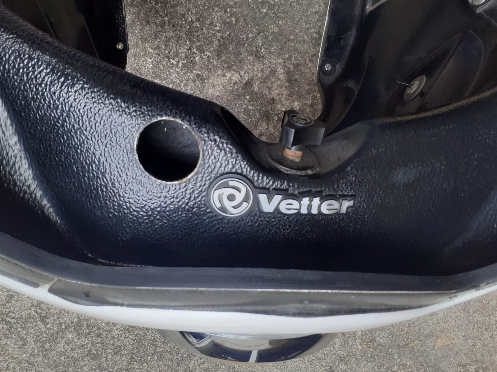

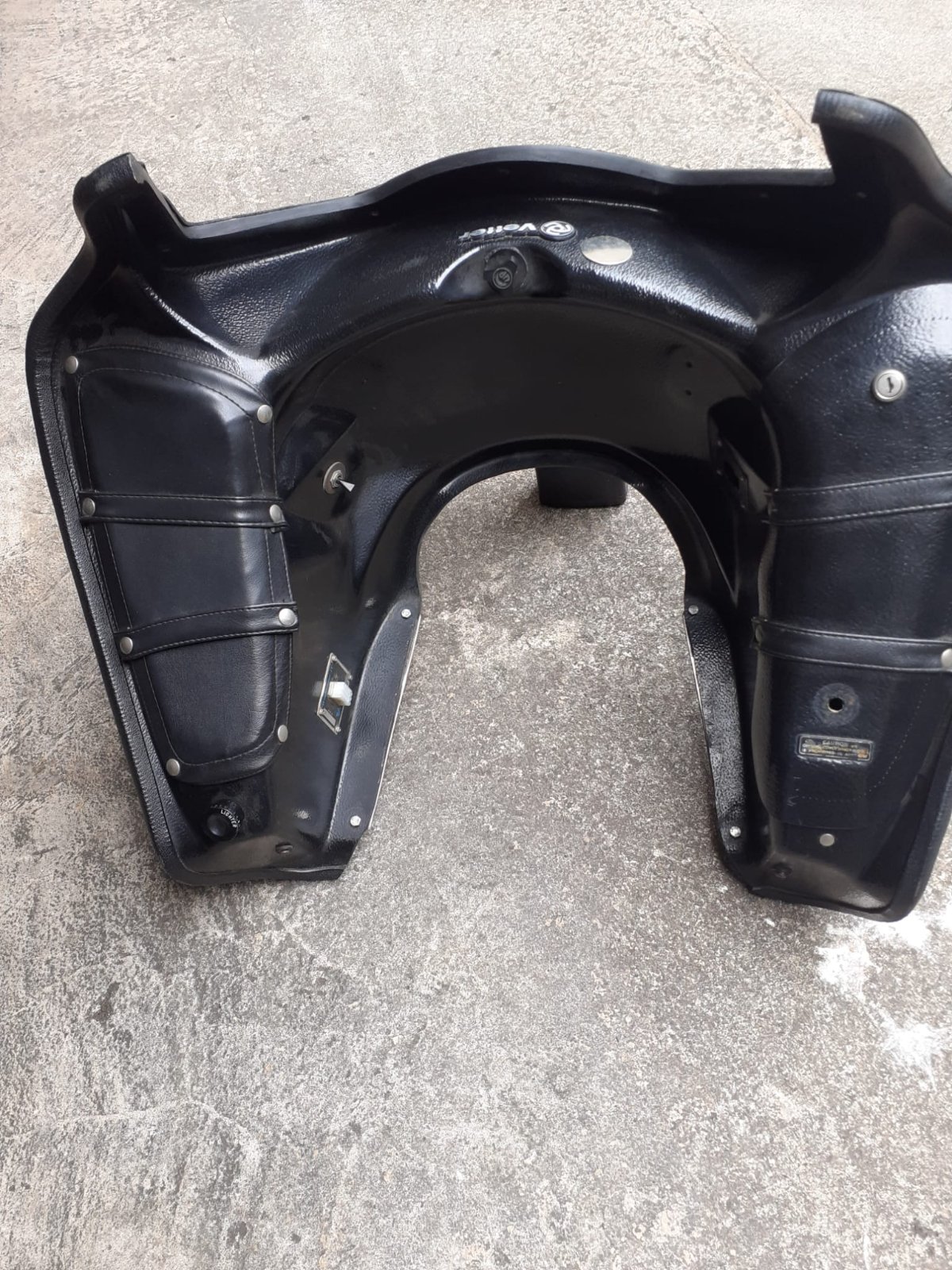

I've taken a few pics.

Yup, that is a Windjammer all right. Overall, it looks in pretty good shape. There are a few non-standard things... That switch on the inside is an add on, as is that hole on the right-side storage cover. That fifteen pin is NOT standard, so you are any good with wiring, you could go get a set of male and female connectors that match and wire it yourself. It is not hard. Don't worry about it not being original as long as it works. I think I have the wiring diagram somewhere.
That large hole on the top behind the windscreen was for an add on call CycleSound that allowed you to mount a car radio on it. I've never seen that bubble over the headlight before. That is something aftermarket as well.
Here in the US, windscreens are not hard to find. I probably have a few in storage. I couldn't tell you about availability in Europe.

I think I will remove the 'bubble', it has gone a bit yellow and looks a bit weird.

Yes, wiring is no problem, I have a lump of 12 core trailer wiring that looks like it will be pressed into service, I'll just sort out a suitable pair of plugs and whatever is needed at the other end of the pigtail, I'll get the fairing on first and go from there.

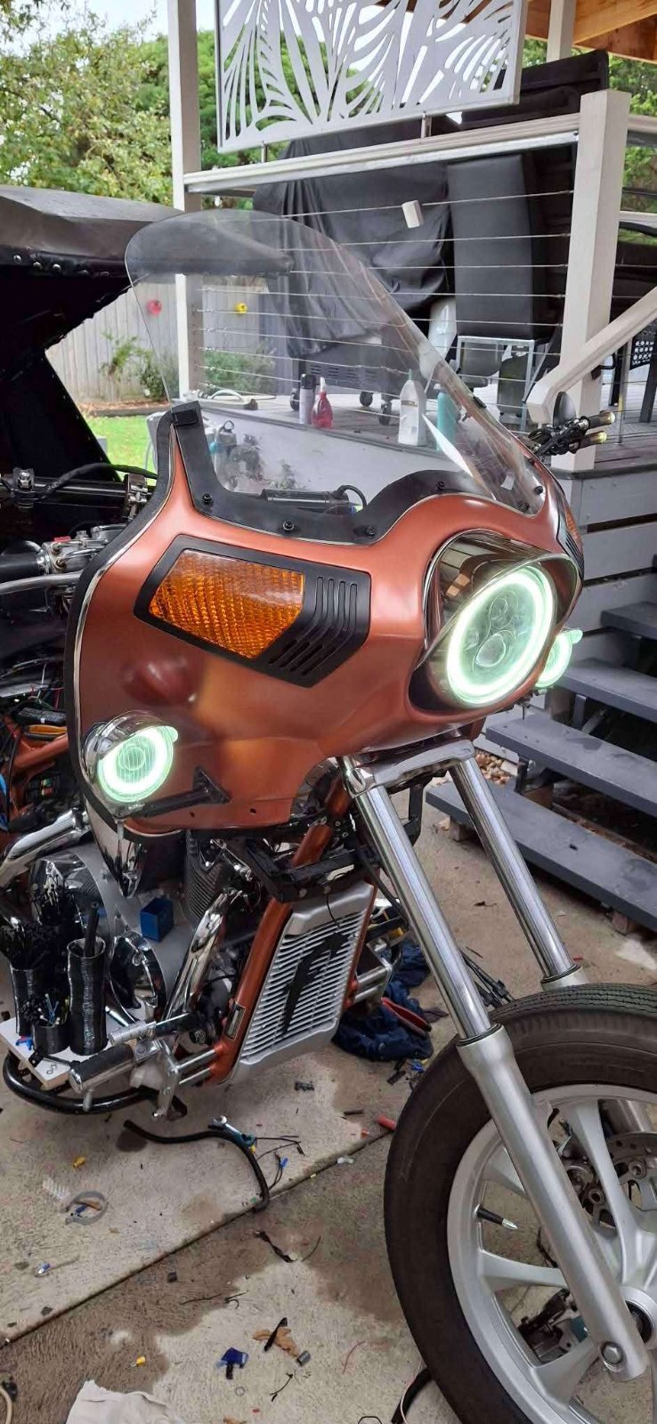

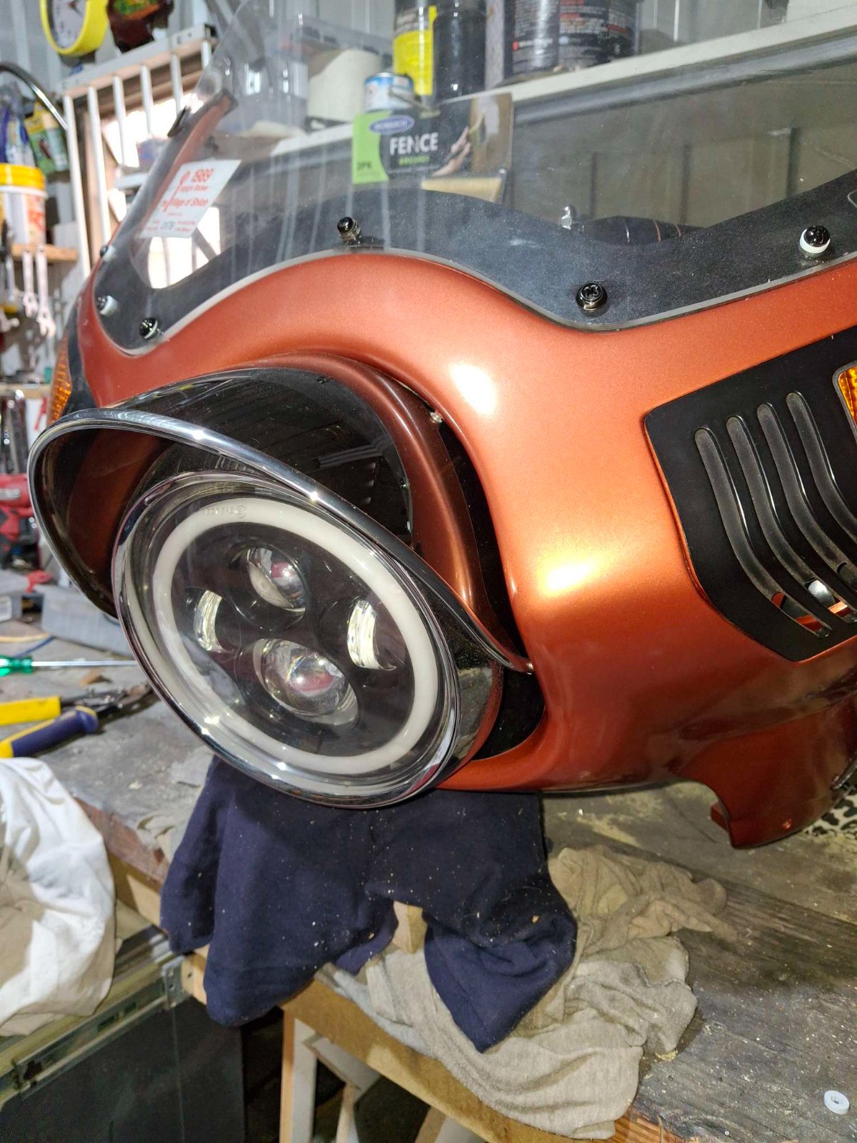

Welcome, I'm also an Aussie. You'll see in the pics how good the windjammer fairing finish is once sprayed- great.

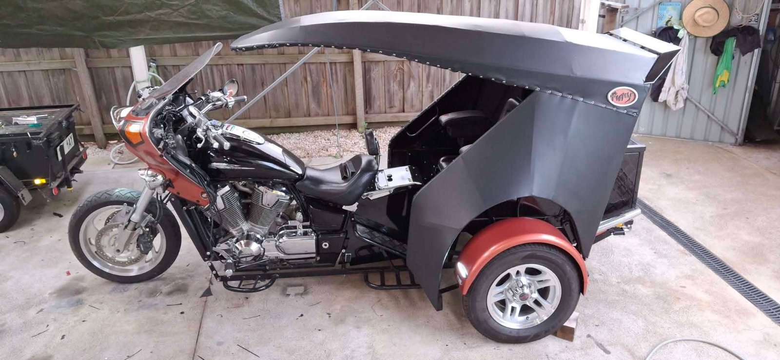

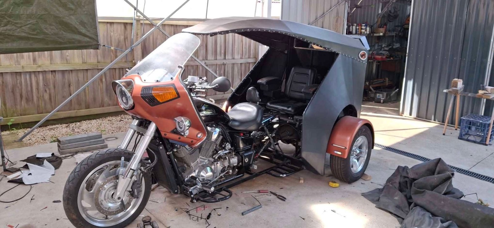

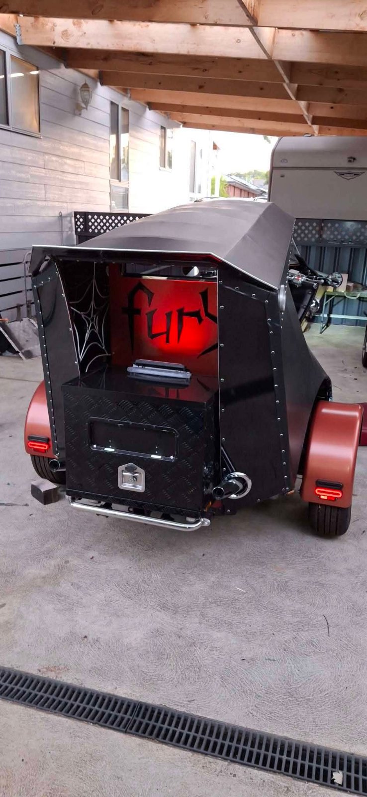

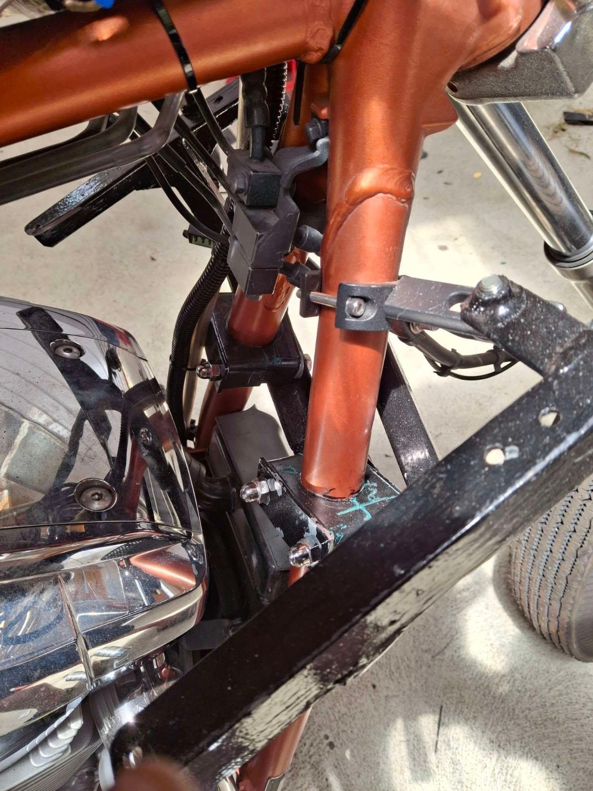

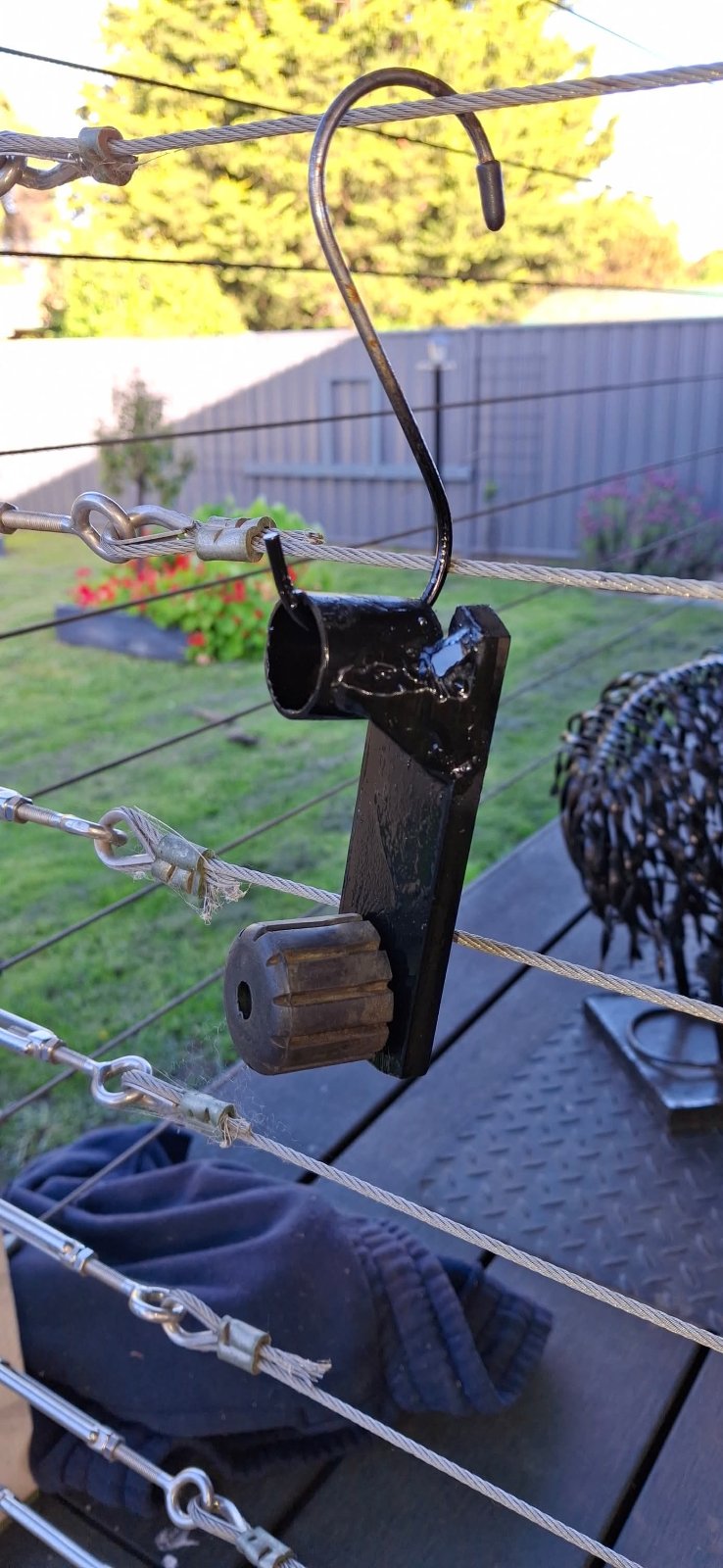

Ive got other posts on the forum about my project of my trike build. I had to fabricate brackets and this is how it was done-
Under each side of the fairing there a flat section with two holes. On top of them I have a 2.5 mm plate with two nuts welded to it. Under, I have a 2.5mm angle section bolted up. How you run 20mm square tube to the opposite side depends on the frame tubes but those tubes are clamped with "U" bolts with a flat section on the curve of the U so the frame isnt dented. With so much weight on that fabricated section I installed two 5mm rods on top behind the steering head down each side to those clamps to stop risk of dropping down from bumps
But there's one more thing. The fairing doesnt turn with steering so I installed a mount under the headlight. The mount runs each side of the steering stem section to tank mounts.
These fairings are meant for narrow bikes of the 70's not wide tanks like my vtx1800c so I had to cut out significant sections where forks are plus raise the front of my tank 75mm to fit it along with angling the fairing up on the front which suited the roof front edge. Yes a roof. That meant relocating my speedo above the bars.

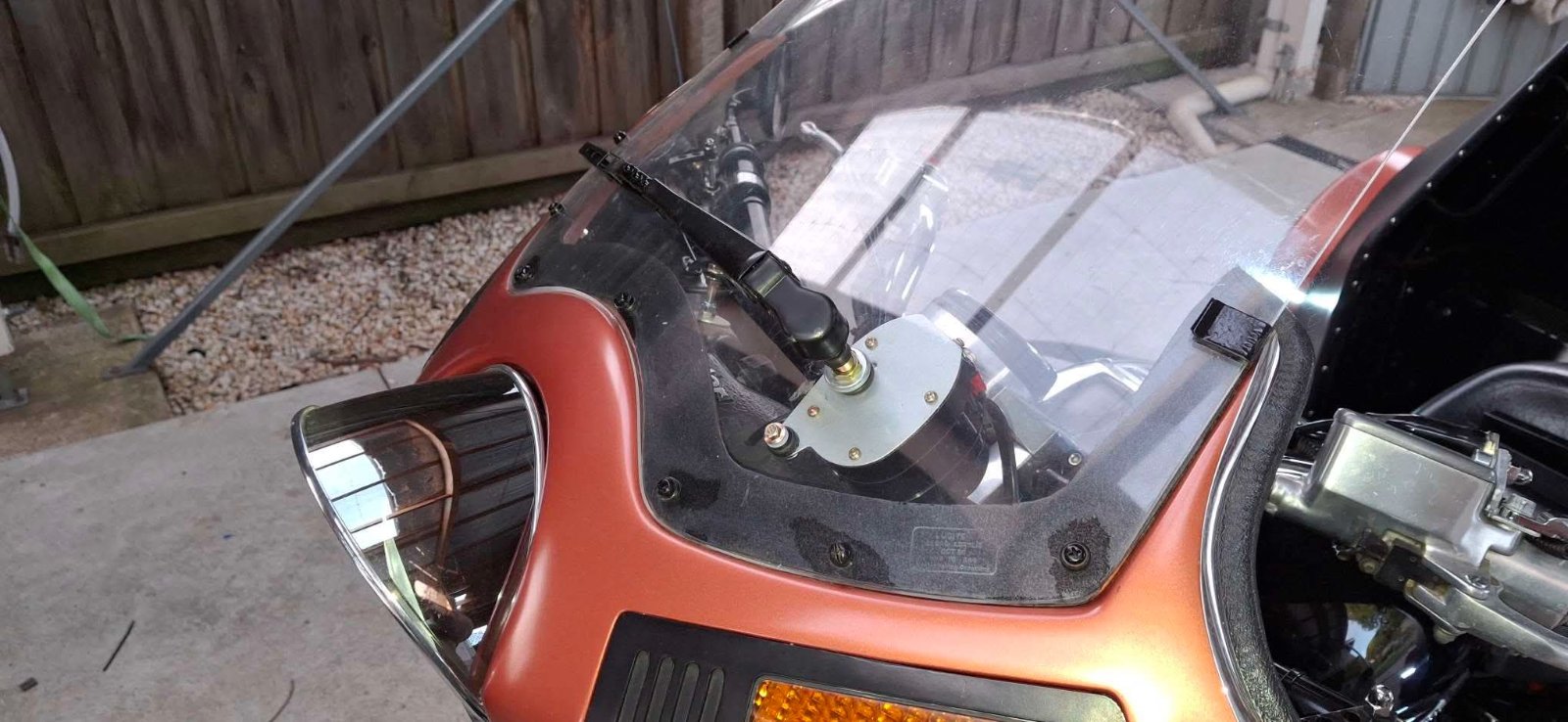

In addition to those 9 wires needed i have 2 actuators for 12v extension mirrors, hazard light needed in Oz for trikes (always hot) and horns mounted where they were designed to go next to the indicators.
I plan eventually to get a safety glass for the windscreen as the windscreen wiper scratches acrylic.
