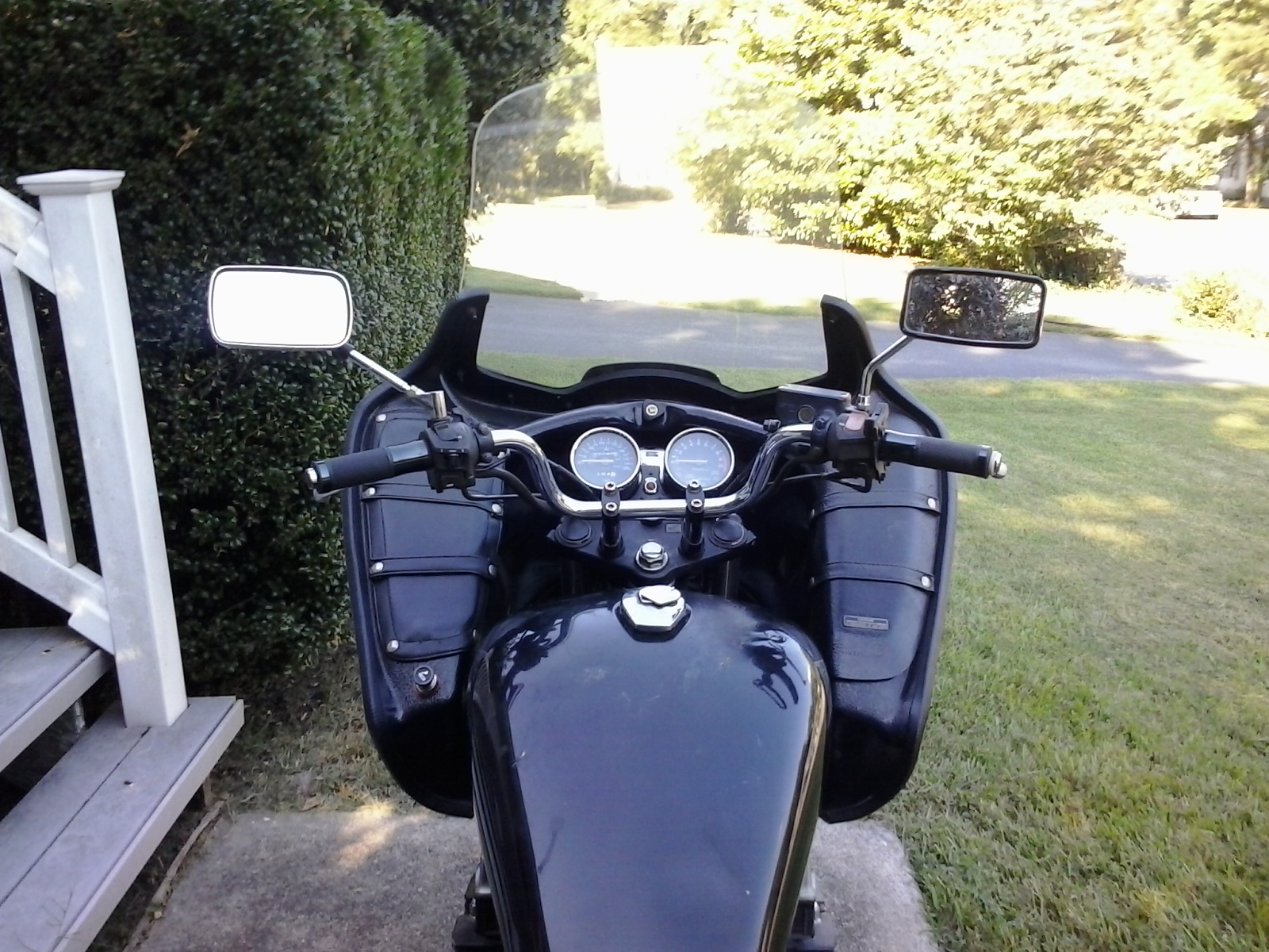

My Nighthawk doesn't have dual discs, but I would think that, with the wheel centered, one disc or two makes no difference.
Here's a rear-view pic:; no trimming was required:
