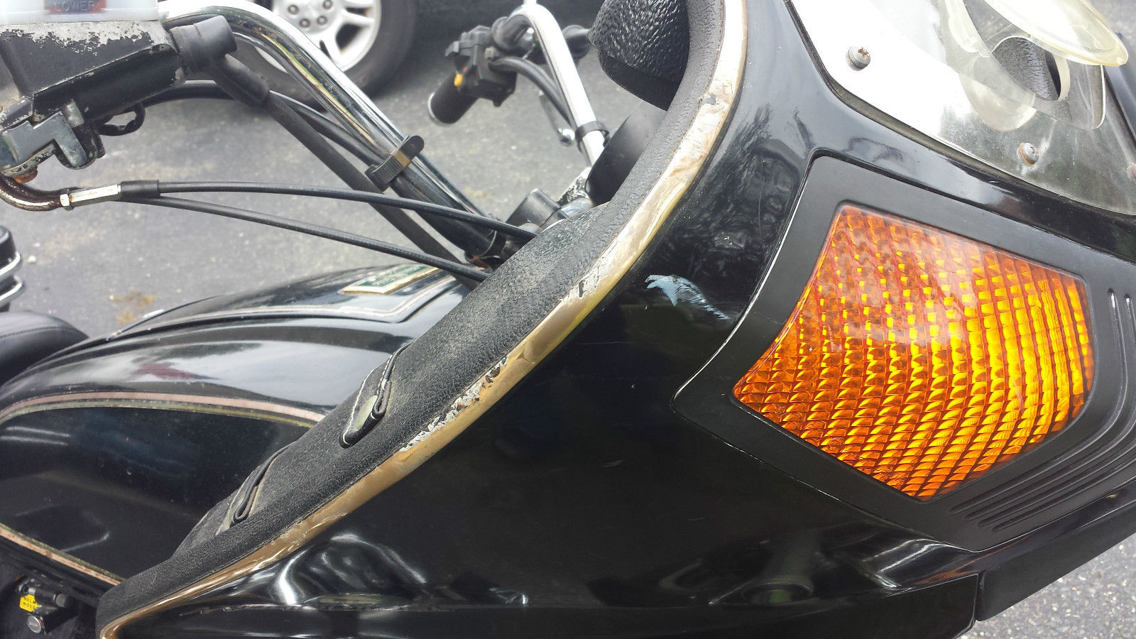

Hi, new member to the site, actually I joined specifically because of this thread. I recently found my late father's Vetter-equipped 1981 GL1100 on EBay, not seen for the last 24 years (short story is I gave it to my Dad's best friend shortly after he passed, and said friend sold it within months). Anyway, it has a Vetter WJ5 "Nightstalker" fairing on it. It had been dropped some time in the last 2+ decades, and the trim on the right side is damaged (see pic). Craig Vetter reproduces the chrome trim, but as the gold came after he sold the his company, he does not reproduce it. I am thinking there's a chance I could find the trim, or maybe even a nice entire fairing. I already found a right side KG hard bag for it in real nice shape, since the one on the bike was also damaged. My goal is not to restore the bike per se, but to take the "horror" off it. Any leads would be appreciated! Best, Scott

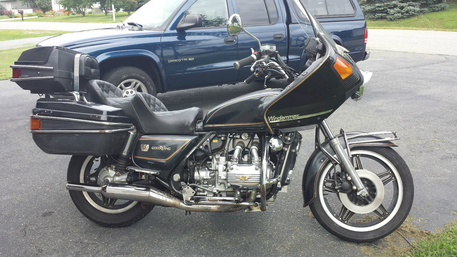

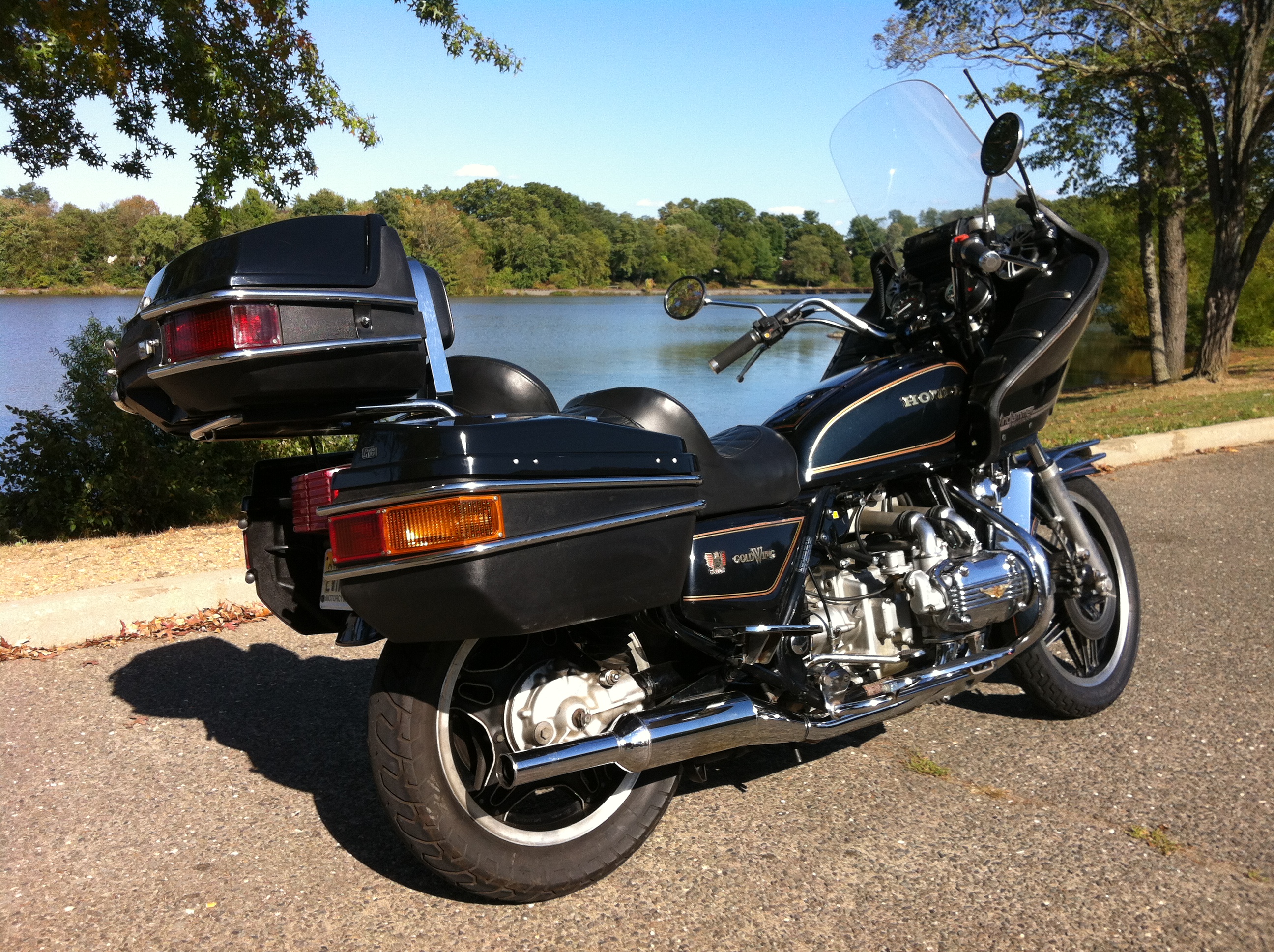

Not quite sure why, but my intention to upload a pic of the whole bike did not carry through. Here it is, for those who may be curious. Its really in fine shape considering the age. The goofy single carb setup even works well, and for now I have no plan to convert it back .

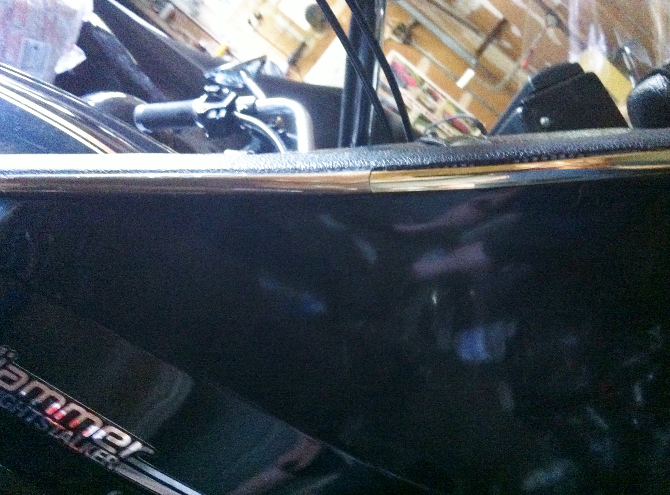

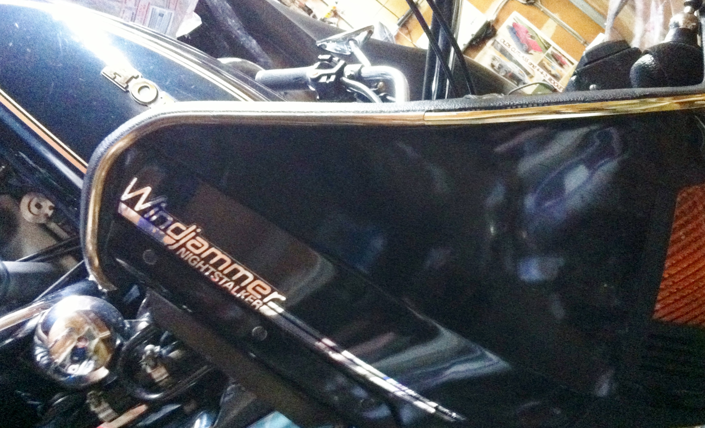

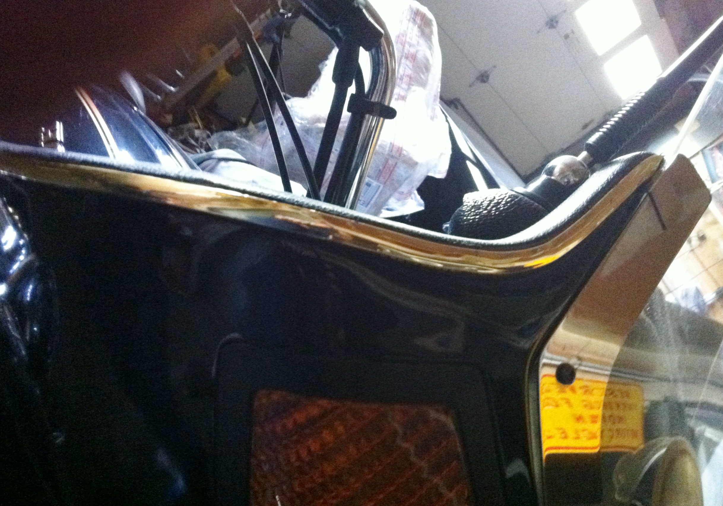

Well, I bought some flexible gold trim in 10mm (0.4 inch) width, an exact match to the gold inlay on my WJ5 Nightstalker. Stuff was cheap, like 13 bucks for 15 meters of it! I then cut out the buggered up section of trim on my fairing and installed the new stuff, using the backing tape and a hair drier to bend it / cause the tape to affix better. Where the new and old gold trim butts together, I "slant-cut" them to better mate. You can tell the new vs old trim apart due to the "shineyness" of the new vs tarnished old stuff, but I don't think it's that noticeable unless you are right on top of it. Since I have 15 meters of the stuff to work with, I may try again. Then again, I may just leave as it is, as I'd rather have the seam that do the entire side. I may also use a bit of black weatherstrip cement to fill in the spaces where I cut a bit too wide when removing the bad section. Overall not a bad first try in my opinion.

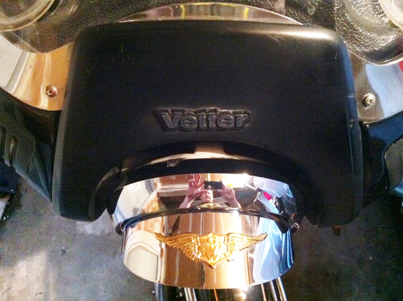

Here's something that I actually only noticed about a week ago; on Dad's old bike, someone removed the gold pinstripe and "Vetter" decal on the headlight surround and added a "chrome" emblem the same as that on the Vetter Sound enclosure (so there are actually two). I asked the prev owner, and he says its been like that for 20 years at least (his cousin owned it before him). So I'll assume Dear Old Dad did it. I had been looking for a nicer piece (the surround I mean; it may have taken me a lot longer to notice this custom touch if I hadn't looked at ones for sale on Ebay), since mine has some scratches; but right now, I think I'll leave it be. By the way, Dad must have been slightly "cock-eyed", because the emblem aint quite on there straight, haw haw!
