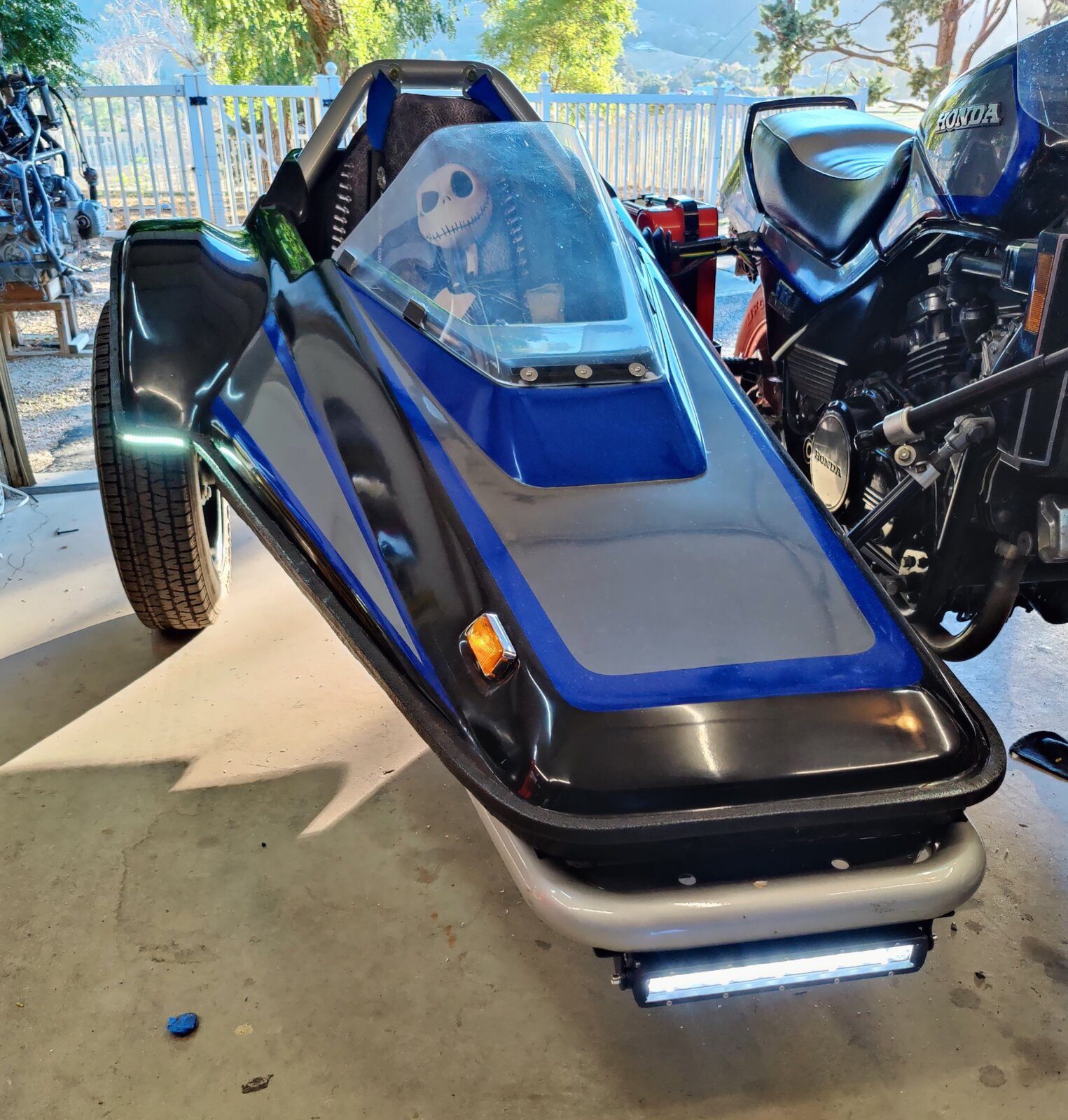

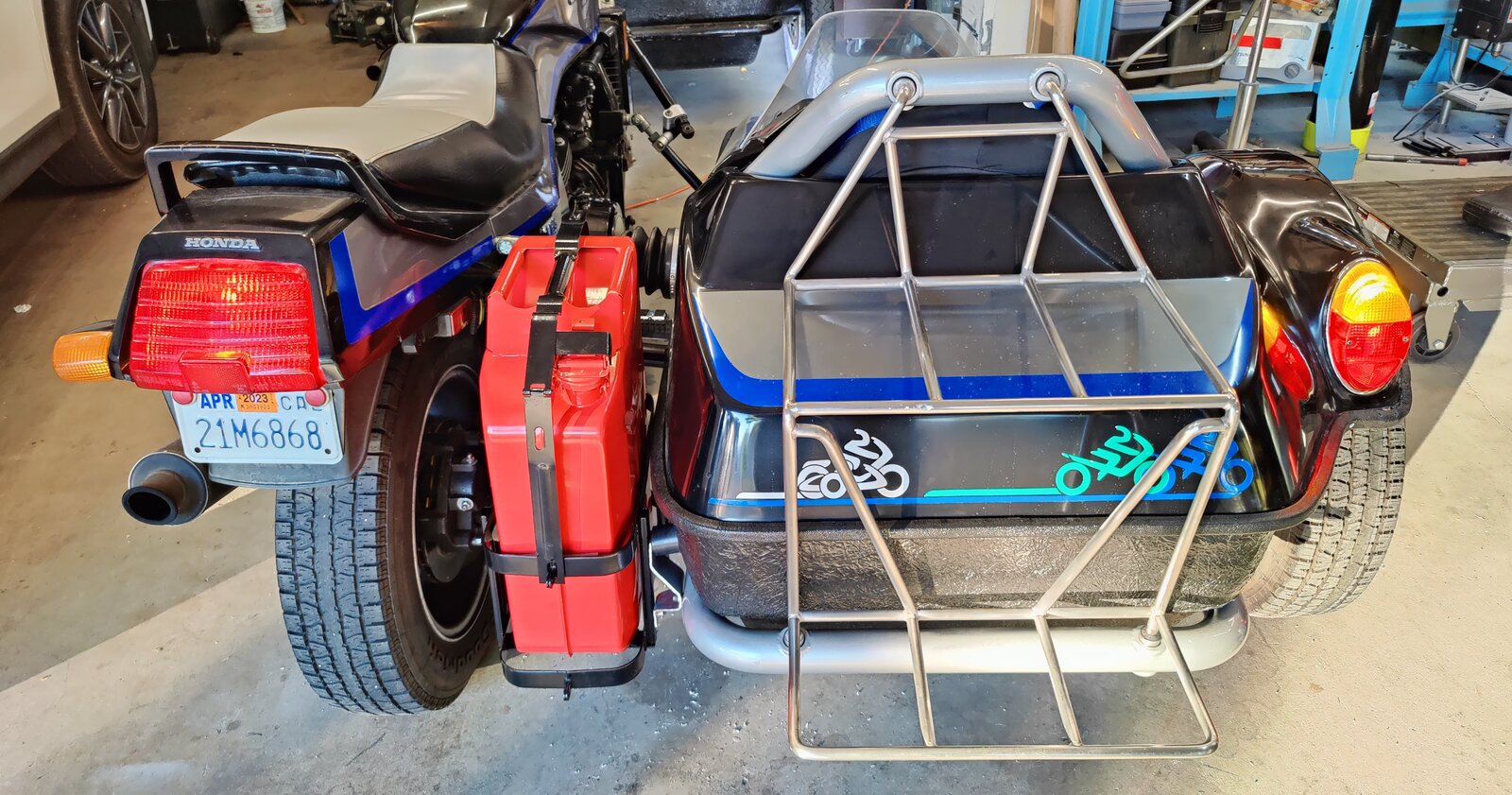

Project progress.
Bodywork - cut down and widened cockpit, repaired stress cracks in fender.
Paint - repaint modified areas, touched up original graphics, 2K clear coat upper body.
- bed liner spray exterior of lower body after repair of holes and gouges.
Wiring - clearance, driving, and turn signals added and wired with relay as needed.
Fuel - I decided against an internal tank for safety reasons. Also I seldom need the added range. Therefore a Jerry can mount was installed. I will add a vent and dip tube to allow switching to it as an auxiliary on the fly.

Looks good! How hard is it to get in and out of with the one-piece top?
With long legs, it's easy from the side. Otherwise, climb over the bike using the passenger pegs. My autistic son is 6' 3" and does both....
