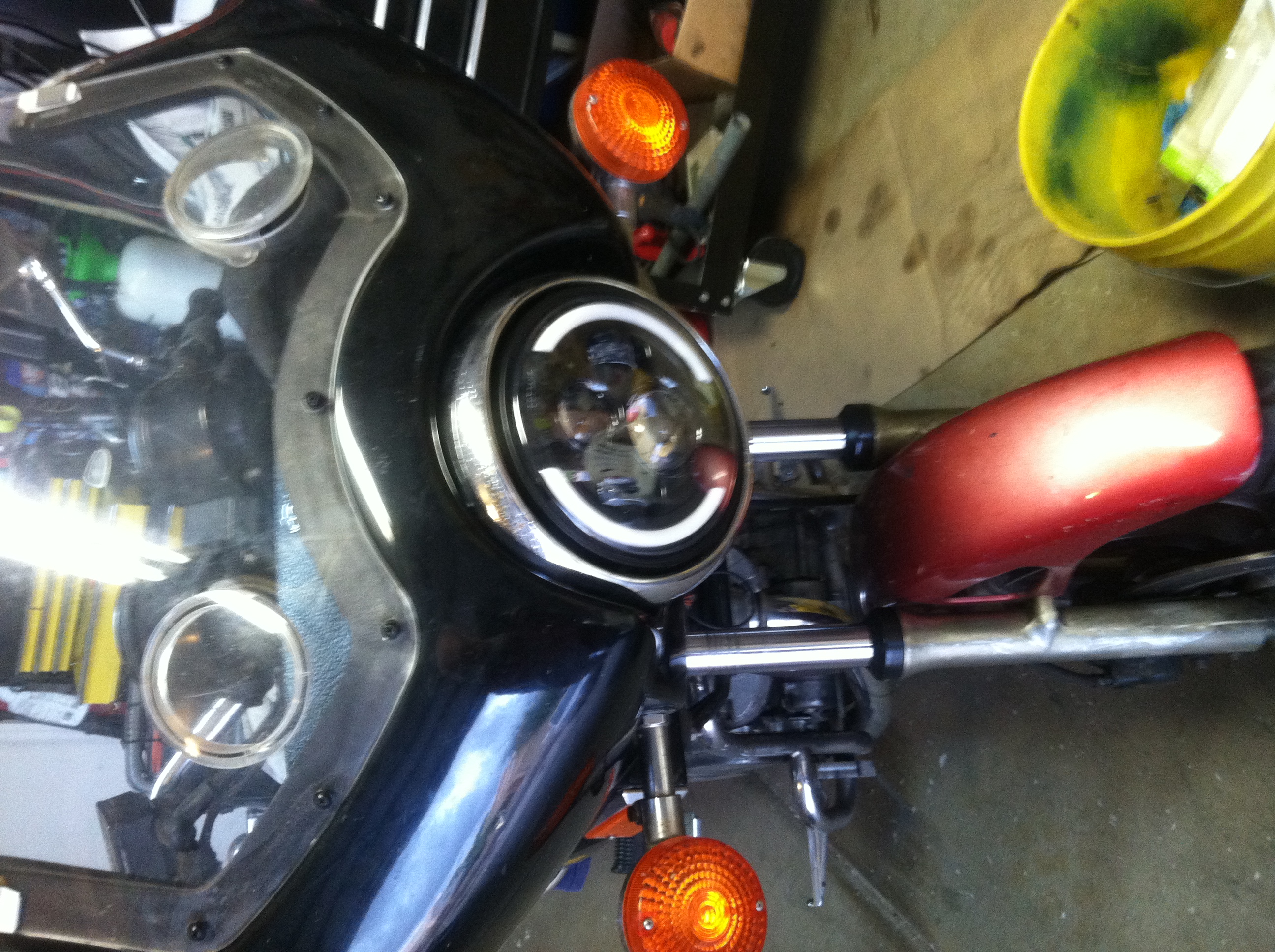

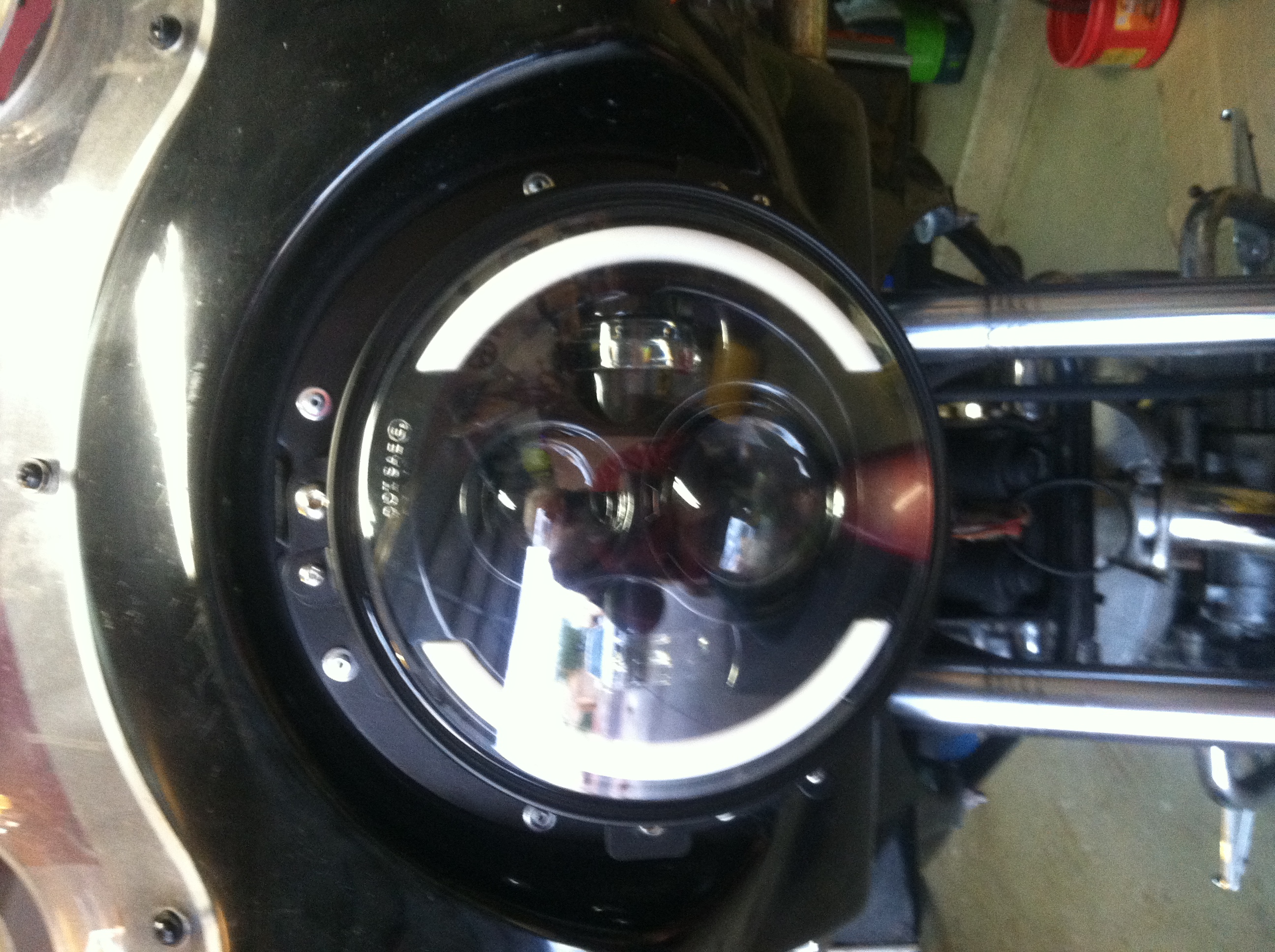

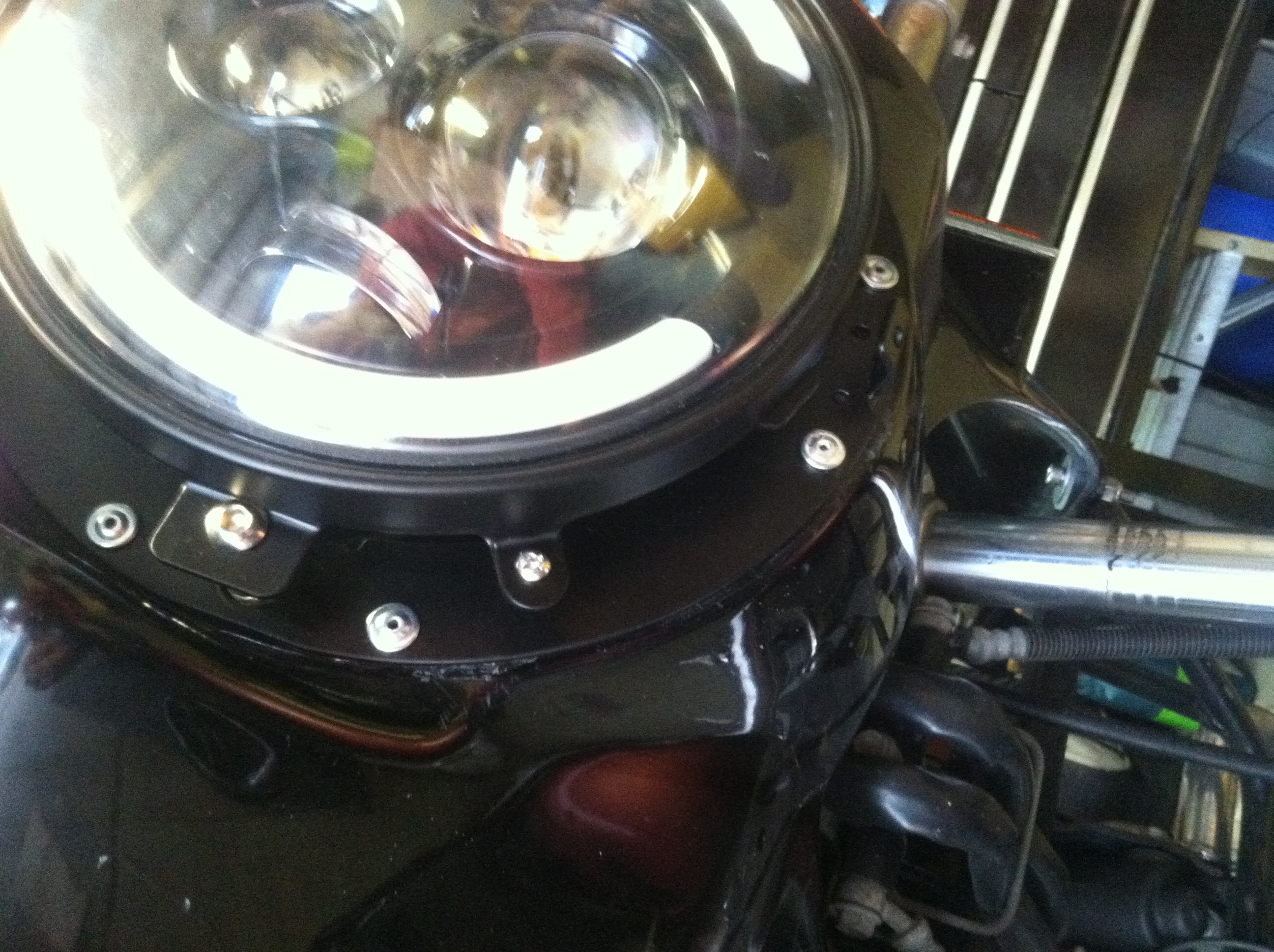

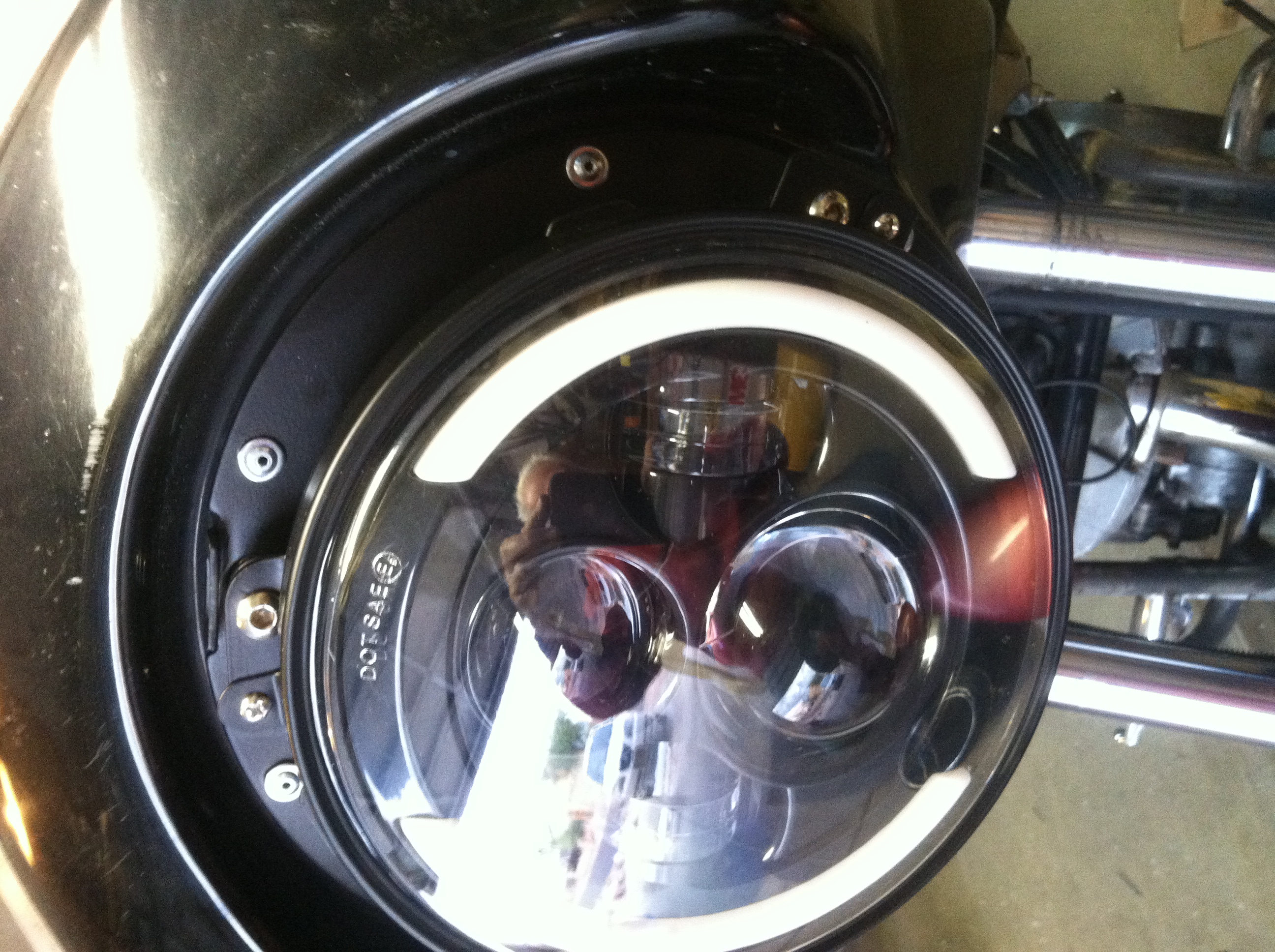

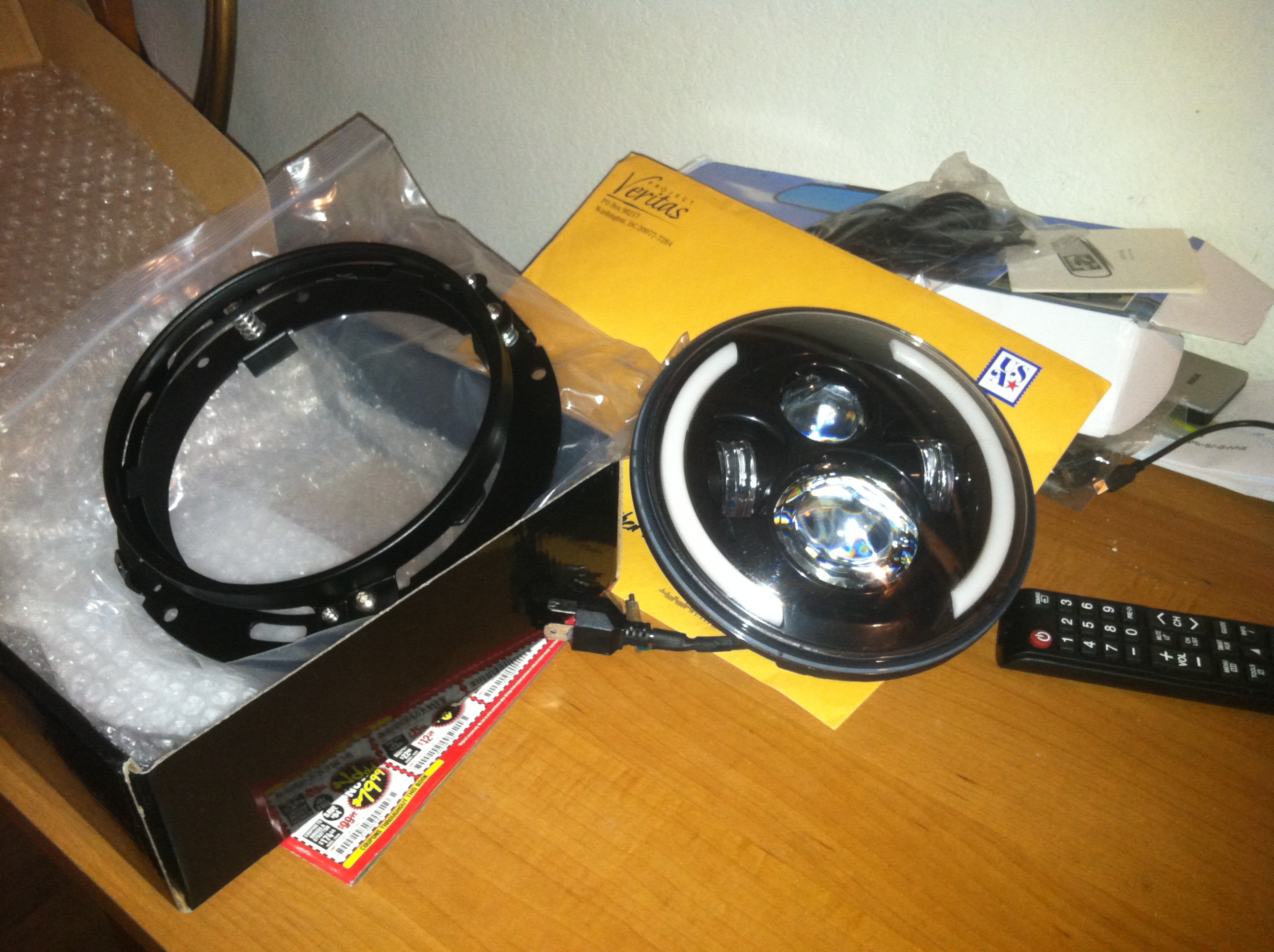

It's very east to put in a newer bucket assembly in the Vetter fairings then most any 7" headlight will fit and the headlight ring still fits too. I bought one off Ebay for a Jeep and a LED headlight. Nearly all the holes for the "keepers" that hold the original bucket assy in line up with the Jeep bucket. I used some 1/8 pop rivits with washers to install the new assy. The original bucket is held in with silicone and some plastic keepers. I had to drill 2 holes around 5:00 position where there were none in my fairing. I'm trying to attach photos...we'll see if I can.

I had been looking for an LED headlight for my Windjammer. I tinkered with a couple of different options but have now found an affordable one that I am really happy with. This is a full 7" replacement bulb and it fits inside the existing Vetter headlight shell without modification. Even the wire and connector fit inside the shell. It also looks reasonably original so it doesn't look too modern on my forty year old bike.
The light is bright and clear. I wish that the high-beam reached just a little farther, but still, I am very happy with it and feel safe riding at night. It is also compatible with my headlight modulator, so I can make it flash for visibility in the daytime.
I bought it through Amazon, but I am sure it is available through other suppliers as well. I paid $49.99 for it in April of 2021.

That's real similar to the one I bought for mine.
Everything fit perfectly, you almost couldn't even line it up wrong if you tried. Light output so far is..ok. I feel it could be better, but then I haven't really had a chance to try out it out in the sticks to see how it is in actual darkness, only in dark areas around the city where there's already light.
