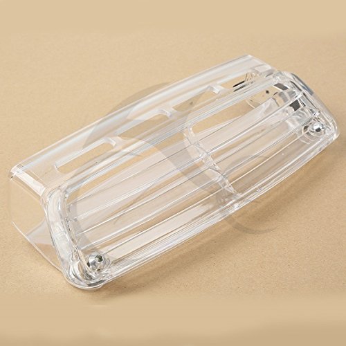

I wonder if anyone has ever tried to fit one of these in a WJ windshield?

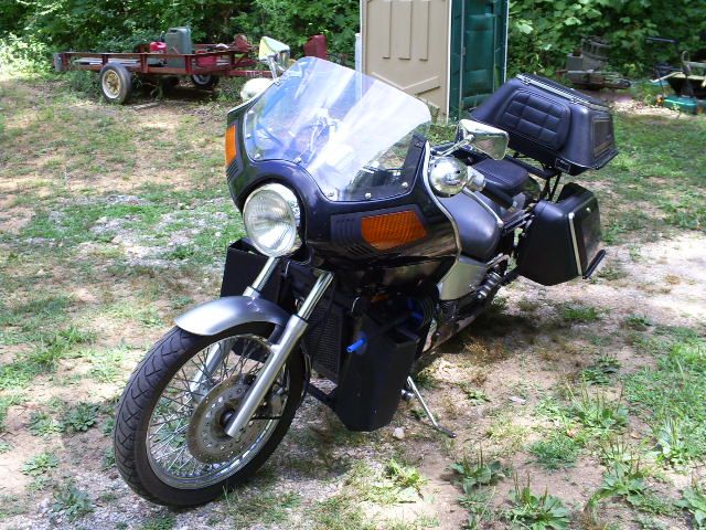

You can see how short my windshield is in the picture below.

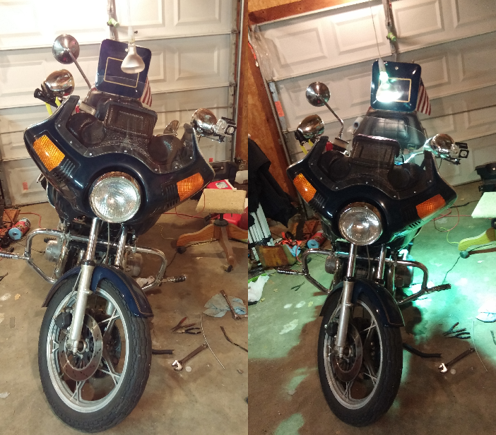

Cut some lexan tonight, a little shorter than planned due to a crack in my previous planned height, but can't wait to test it out at highway speeds.
