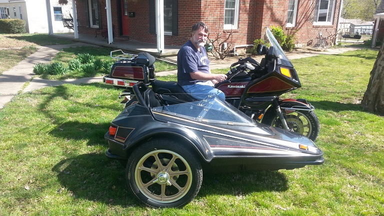

Hi, Mike! I frequently look at your gallery pics, and was just noticing that you, too, seem to have the same problem I have with the factory seat belt. I see an extension belt added to yours! Mine won't even connect! I've checked and it's as extended as possible, so Vetter MUST have also had to use an extension belt to make these work. To me, it's really no matter because I am having a full set of custom-sized belts made with double shoulder belts and lap belt. So, if originals are important to you, you can have mine. Also, as you can see in the pic below, I don't run that black plastic axle nut cover on the wheel anymore. I made up an adapter ring to mount a three spoke spinner to mine. So, again, if originality is important to you, my cap is available if you want it.
Mine came with just one side window panel, and it was broken in half, so I taped it carefully back together and use it as a pattern. I made up both new side windows, but found out when trying to fit them than one of them is shorter than the other. So, a bit of custom fitting was needed, but now I will have that one available for a pattern if ever needed. Unfortunately, mine also was missing one of the "H" couplers between the windshield and the side windows, so I mad up a coupling strip and use nylon screws to tie it all together.
Cindy says that she gets hit with too much wind and even some dust. Of course, she's 6' tall !! So, I am thinking of asking one of the companies that offer new windshields for this car to make me a custom shield that doesn't slope forward at the rear, but instead goes straight up, perpendicular to the bottom edge, giving me quite a bit of extra wind protection.
I'm doing some drawings for a model-t styled top that will not connect at all to the body of the car, but will move with the lid when flipped open. It will leave a big gap at the rear to clear the roll bar when flipping it open, but we are mostly concerned with wind and rain deflection when on the road. Your tonneau cover and it's snap connections have given me inspiration on how to make my own, too!

The spinner you made looks great and the side panels too. Thank you for the offer of seat belt and hub cover but I think mine are in good enough shape so I should be okay. There are probably others who would like them though and need them if they want to go original. I do like going original with my bikes simply because I am not a fabricator and finding original parts, getting the few bikes I own to run reasonably well, and detailing them to look clean is enough of a challenge for me - seems to take all the spare time I have! Glad your wife likes the sidecar and the new windshield design will probably make it an even better experience. My wife prefers sitting on the back of my bikes still to the TP. Not sure why - must be an aquired taste. I had a trusted friend take me for a slow, straight ride on a deserted country road so I could experience it and I loved the experience. I thought it was extremely comfortable and relaxing. Looking forward to seeing what you come up with regarding your model-t top! Mike
