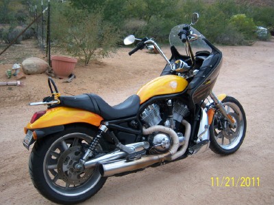

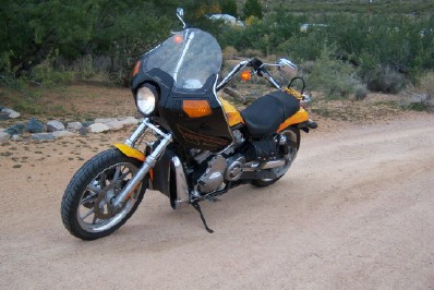

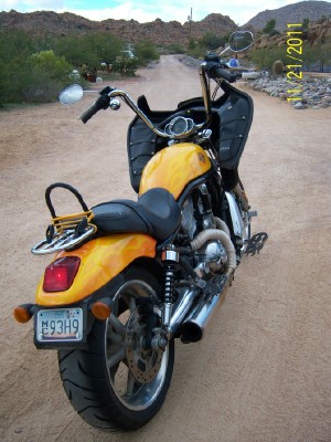

I have a W5 on a Harley-Davidson Vrod, and it's been, once, to just a touch over 150mph. It does tho spend a lot of time between 80 and 110, and goes to 130+ almost every day on empty stretches of Rt 66. Short time only. It's spent quite a bit of time at 110-120, I've had no problems whatsoever at those speeds.
There are these alterations from original Windjammer design that might have an effect:
The windshield is cut down quite a bit, to where the wind blast is just at the top of my head. Several inches were cut off.
The fairing is mounted in a laid back position from what C Vetter recomends. That is, the rear of the bottom flat is considerably lower than the front of the bottom flat.
That was needed to clear engine/frame/etc.
But I can say, that in the configuration it's in, the wind/rain protection is very, very good.
Yes pictures please, I would also guess the windshield angle is almost parallel with the front forks , that's the best for looks
