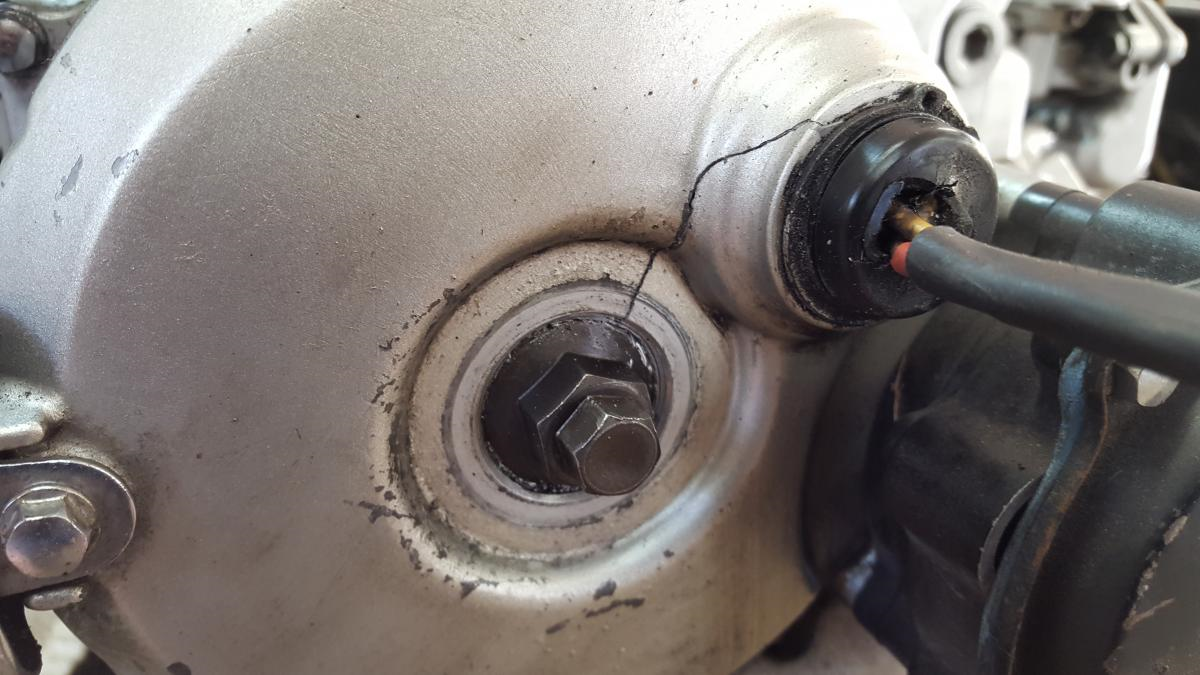

In July, I experienced a minor set-back with my 1100. The bolt that secures the rotating member or the charging system to the internal engine shaft, back out and the rotor backed off of the shaft and cracked the rear case of the motor.
I had just gotten off from work, went to the bike, fired it up and started putting my gear on. Luckily, while I was doing this, the motor made a “Tink” sound and then it made a “Clunk” sound and then there was silence. Why do I say luckily? It’s hard to image what may have happened if I was running down the road at 45 mph and 4,000 rpm.

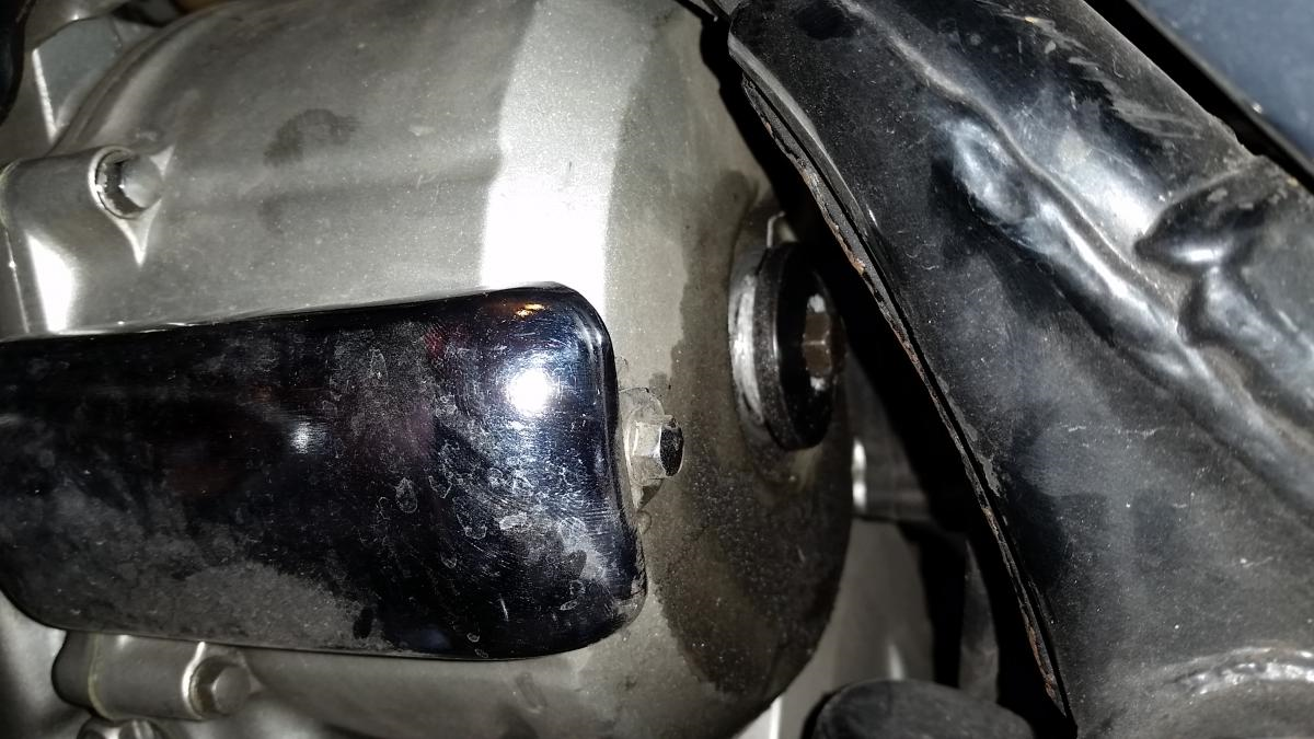

One thing was certain, I was not riding it home, so the next day I rented a trailer and towed it home. When I started to look, nothing obvious stood out, so I decided to try to turn the motor through by hand… using the bolt on the back side of the rotor shaft. To get to that bolt, you need to take off a 17mm cap, so I stuck my wrench in to take off the cap and quickly found that the wrench was too big for the cap… what the hell? I found the problem.

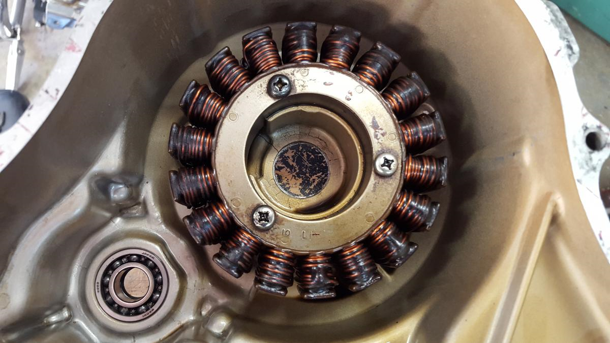

So I set about to getting things done. I opened the back of the motor up and found that there was no damage to either the rotor or the stator and I didn’t see any other obvious internal damage…
Maybe I dodged a bullet and didn’t need to overhaul the motor. So I put it back together again with a new rear case, but it back together, installed the carb and got it running and idling fine.

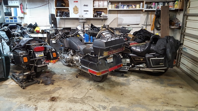

The one in the middle is a donor for the one on the left. Yes, I could register it, but there isn’t a piece of plastic on it that isn’t broken. It would require a LOT of work to get it road worthy. No it isn’t a 1100 it’s a 1200, so I will be putting a 1200 motor inside an 1100 frame, and I am still planning on going the single carb route with my C5 ignition system from the 1100 motor. There are a couple of other tricks I could do it, but I am an not sure just how exotic I want to go with it yet… but there are lots of options .
Oh, and the price for the entire bike: less than any 1100 motor that I found on fleabay. So while there are minor set-backs I still have the eventual plan of keeping the 1100 on the road with the WJ 3 in front - it's just going to take a while.
