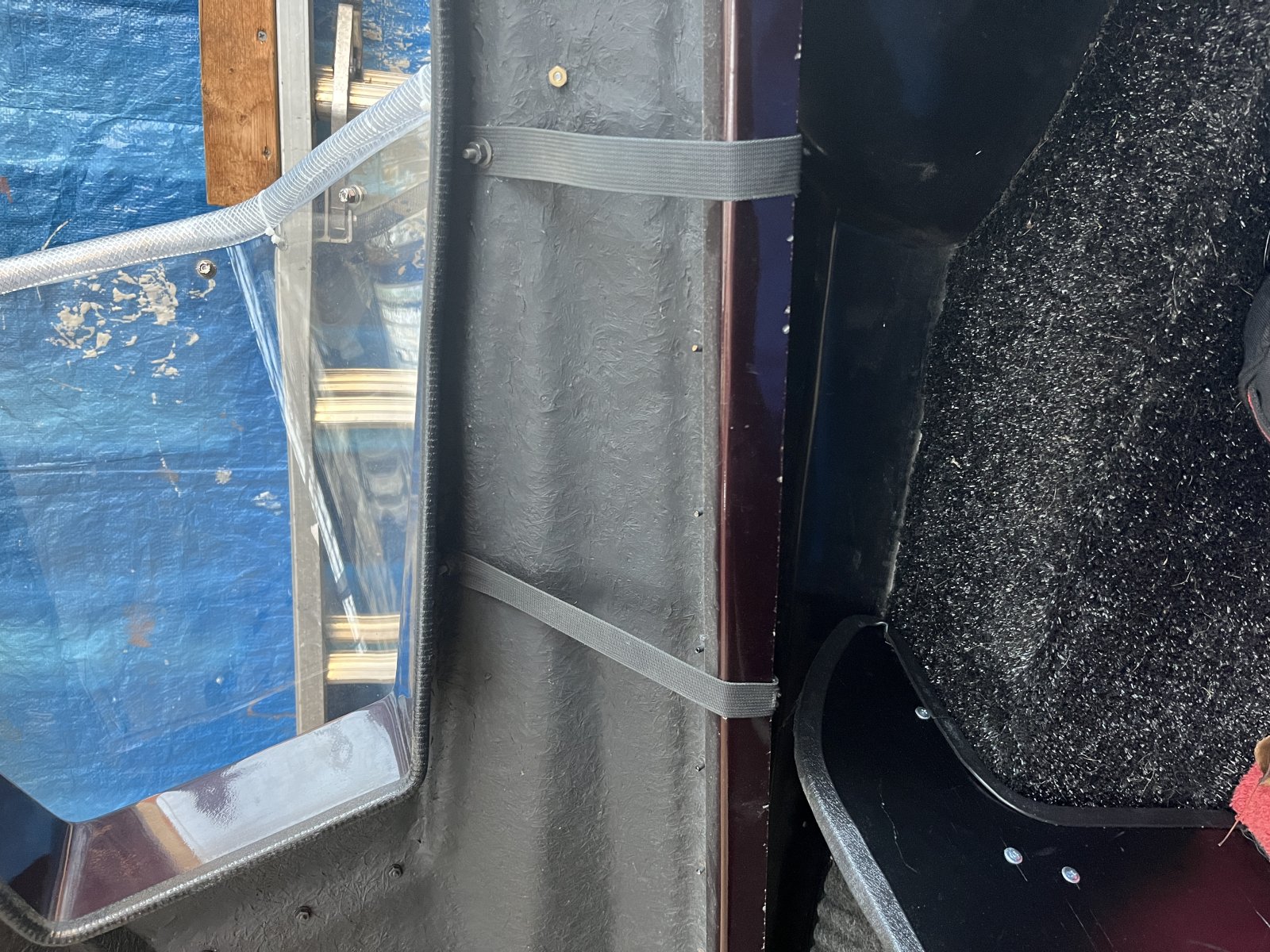

Hello all,I have a Terraplane attached to a Suzuki GS850G, took me a while to make the attachments but very pleased with it. A question for you, how are the restraints for the hood attached to the hood? I assume some sort of attachment fibreglassed in place which is missing on mine. Some photos of what was there originally would be very helpful. Thanks

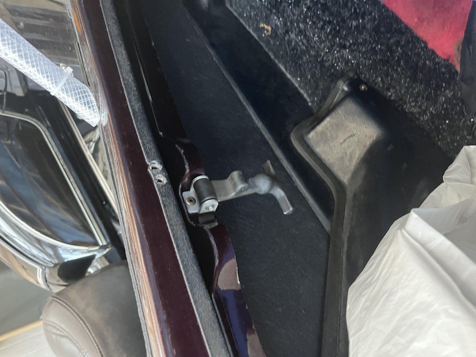

Let me see where I put the clip. I’ve dog proofed the interior. My lid doesn’t really need secured. Rubber seal is sticky and wind holds it down at speed.
Thanks, what I am looking for is details of where and how the straps that prevent the hood from opening too far are secured to the hood. There is nothing obvious on this one. Thanks
Let’s give this a try. Changed a setting on my phone. There’s an upper rail right behind that edge the straps wrap around. Loops back to itself with a rivet.

Yes, definitely a gold star from me too! That answers my my question, thank you! Incidentally I have failed to post photos on this site, gave up trying.
