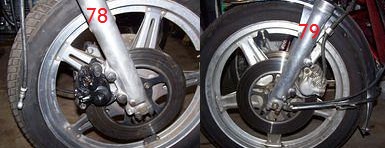

A couple of things to consider.
1. There is very little difference between the 78 and 79 GL1000 Goldwings. Most obvious are the turn signals (rectangular instead of round) and the 'spokes' on the wheels are slightly different. Very very little was changed as Honda was concentrating their efforts on the GL1100 for the 1980 model year.

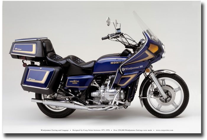

Thats great advice Ron. Thank you. My goal is to make a exact replica of the 78 GL Vetterized that Craig has in his poster.

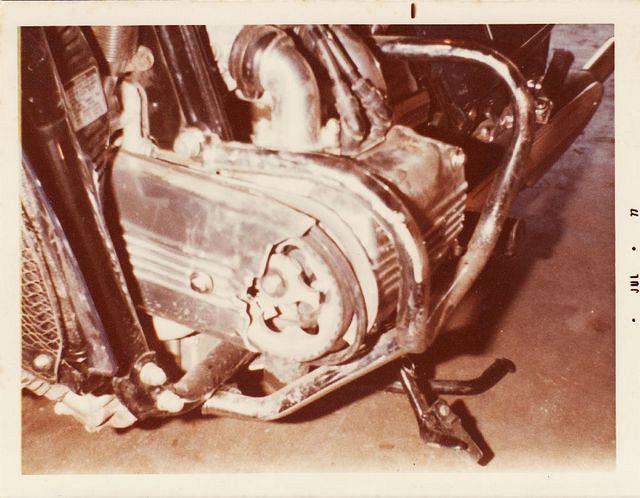

Just from what I can see, there are several aftermarket items on there, besides the Vetter equipment.
1. king/queen seat.
2. rider floorboards. Most likely coupled with a heel/toe shifter.
3. passenger floorboards.
4. oops bars or engine protectors. I hate to call them crash bars due to personal experience. Don't do much in a crash. The style pictured, looks like the 'Hondaline' which are rare to find. Like most accessories, many manufactures jumped on the GL1000 bandwagon.
Only when placed side by side can you tell the differences between 78 and 79 (or the hardcore.)
That said, I have found and acquired more 78's (and parts for 78's) than any other year.

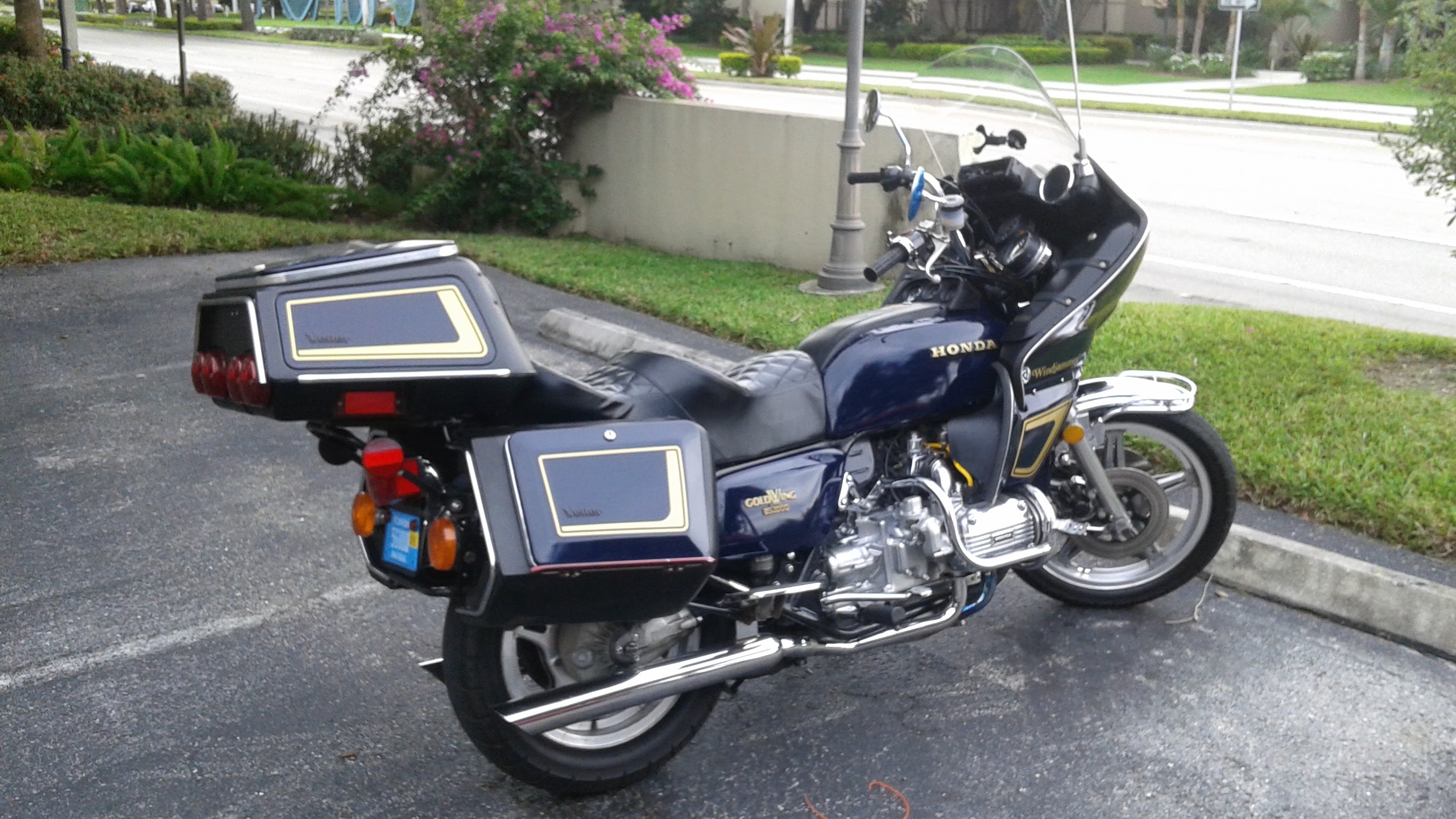

As you all know I have a 77 GL1000 to do up. Now here is my issue. I really like the WindJammer Fairing look on my 78 for many reasons. The first one to me is the most important one and I'm sure most would agree. can hear if the engine in in some kind of trouble. Vacuum driven C/V slide tend to lean out a engine and cause it to get hot and fail. The first sign of this is engine knocking harmonics. This is never good on a engine. The second is not needing to deal with road debris and wind or rain. Finally what it was made to do. So this is a big deal to me. I have spent a lot of money on this 78 and to tell you the truth I don't want to go that deep. Plus this bike is older and in better shape then what I started with when doing up my 78. So to simple it Just a fairing out front would be fine then again stock would be okay too. If I could find another fairing for a good price I would get it I'm guessing but still not sure. The old one was cracked in to many places and was not wanting to spend the money in a repair kit to fix it when there still to be had. Again unsure need some input on this thanks again..
Paul, I totally understand the dilemma. Since you already did a Vetterized GL, maybe a different direction for this one? The real question is do you want a fairing and, or touring setup on this GL. Maybe your 78 is your more touring bike, and the 77 is more your naked bike?
roncar
Personal preference, but I have always preferred to have a wind screen. Thinking back, every bike I've owned (except the Honda XL350 I played in the dirt with) has eventually had a windscreen/fairing on it.
My project bike, (one of them ;)) I wanted to put a clear windscreen on, but Vetter fairings are more plentiful and less expensive and I am extremely budget conscious (ie $0.00 budget.:()
Fairings you either love or hate. Lots of hate out there which is good for me.:bliss
It is nice having one bike that isn't as dressed up as the other, but bugs hurt and they do not taste very good.
PAUL politsch
This is my point. I think I will take the ladder. I think I will just get a fairing to have painted the same color just in case.. . I'm just getting older and don't want all the wind. I'll fix it up I have two of them. Plenty of important parts engines. When I got my 78 it was not much to look at but now a looker it is ..! Thanks again..
