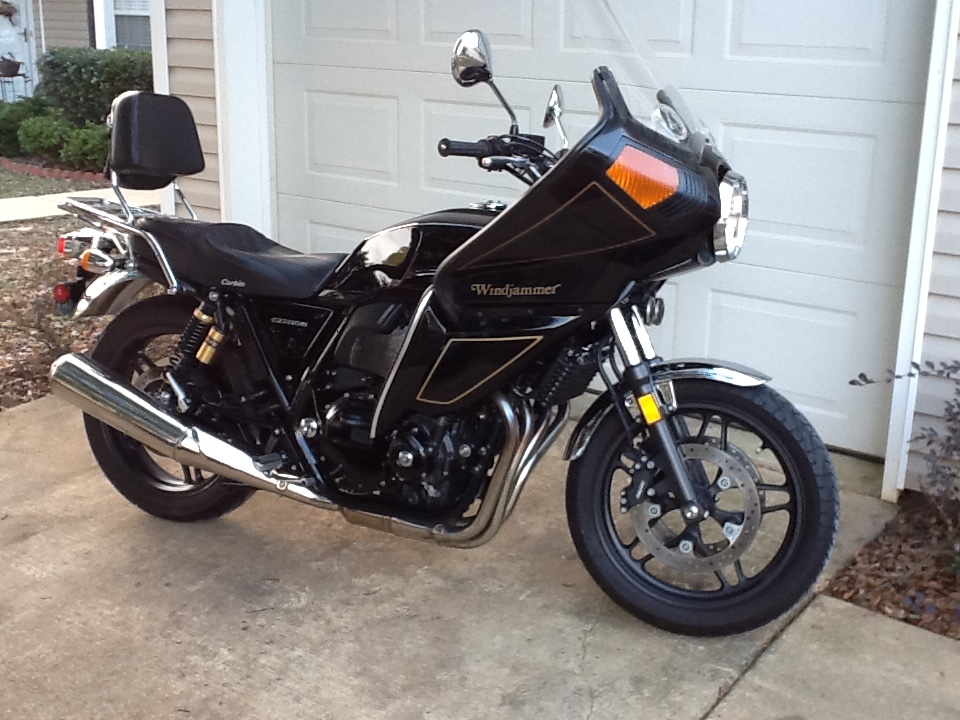

Hello Husky, after further investigation, I think the mount I used on my 14 CB1100 is from a mid late 70's CB750. I found some on eBay that look almost exactly like mine. I have put a better fairing on my bike and found some lowers that had the same pattern. Here is a recent picture.
Now that new fairing makes your bike look fantastic.

Just curious, are you a member on the CB1100 forum? Basically I measured everything (about 20 times). Then I removed head light, turn signals, oil cooler from motor. Than I worked on the bracket until it fit, flairing out the mounts, I had to trim the one that is long on top. I tried to make sure I had it as high on the frame as possible. Never did I cut or alter the bikes frame. Once I had the bracket mounted I turned the fork to full tilt each way. Then trimmed the braket until the forks didn't hit. When you get that far you will know what I am talking about. After that, I put the oil cooler back on and mounted to the bracket. Easiest thing to do for me. Then I mounted the fairing, had to trim the bottom a bit, no shimming needed. I used the factory head light from the 14 and made it fit in the factory housing of the fairing.
There is also about 10 other things I had to do, measure both sides of the bracket and make sure it is even in the back and front on both sides.
Also the bracket for the gauges had to be bent forward a bit to clear the fairing, this wasn't a big deal.

Thank you for the detail on what you did to make the mount fit, I have a mental picture on what you did.
Larry those pictures are literally worth a thousand words. I believe I have enough ammo to make this work.
