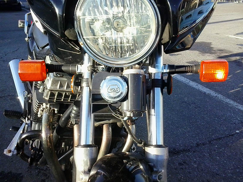

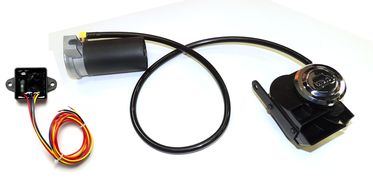

I put this one inside my Fairing there's no way when you honk this they can say they didn't see you.

Oh, it works quite well. It's supplied by a heavy wire directly from the battery (as is the ground wire) and controlled by a relay which is operated by the original horn wires. The headlight, also relay-controlled, is likewise supplied by these heavy wires, as is the audio system in the Rooster.
