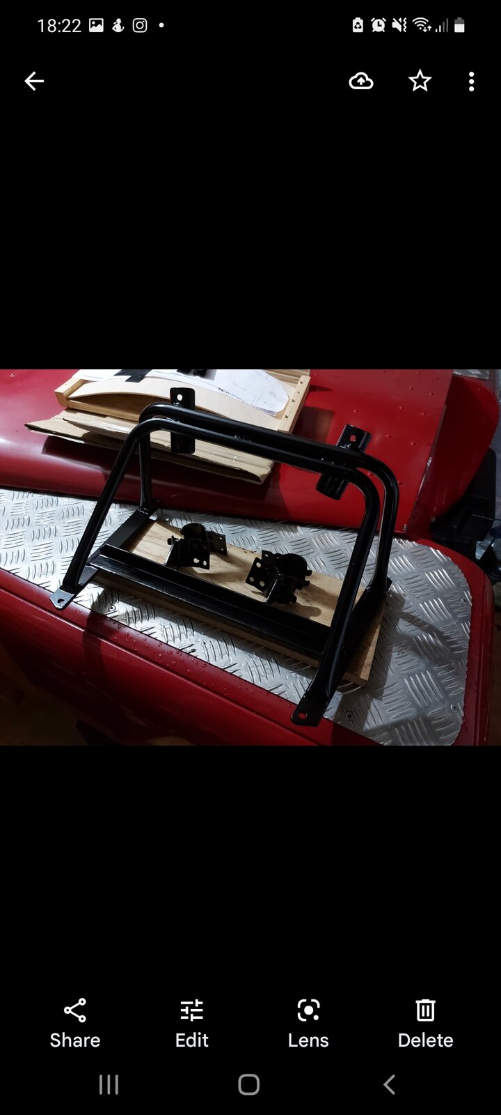

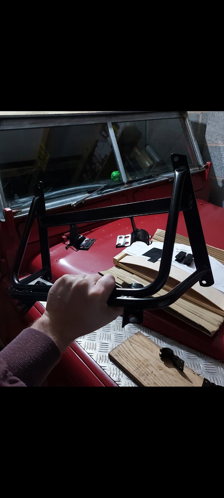

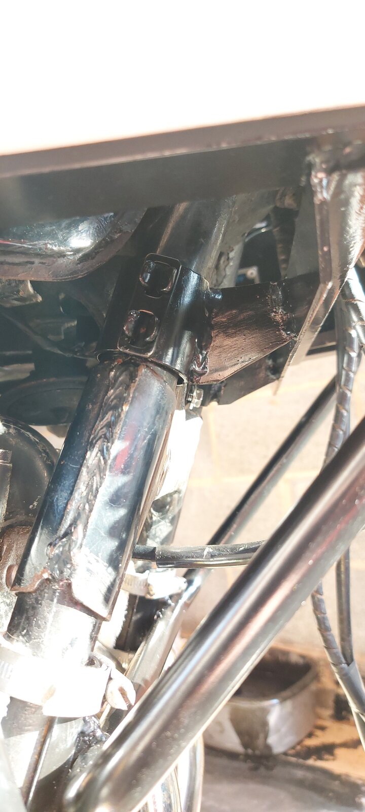

Sorry for my crude images. My mount was off a Honda or some sort apparently (not a goldwing) and it clamped to the frame tubes at the front.
I made some extensions to fit it to my GS850g as you can see (after 3 different mounting attempts this is rock solid!). I didn't want only jubilee clips holding it on like most mounts you see for sale.
The original 850g mount had an obtuse angled cross rail with holes in it, and then 2 U clamps mounting the the same section of frame mine uses.
Hope this helps even a little!

Not in the UK but in Uxbridge Ontario Canada. Love the pictures that helps alot this is my first attempt at adding a Windjammer and I was unsure of the hose clamps too. I'm a welder by trade so I'm going to go with a mount like yours love it. Thanks! Once the temp goes above 0°C next week I will be out in the garage doing some fabrication.
