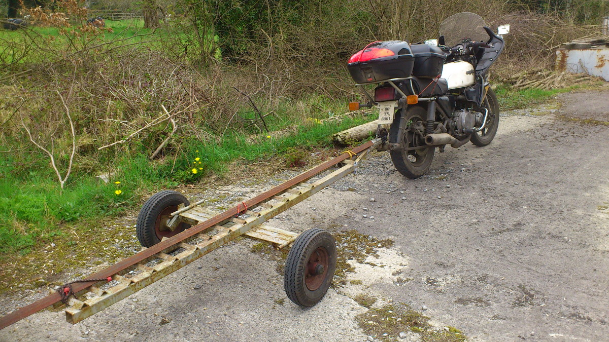

I spent 6 years in the US Navy and 19 years in the US Army. I ended up visiting other countries all over the world. In some countries a motorcycle is the most common form of motorized transportation. In most cases it's the family’s only transportation. I was especially impressed by the ingenuity of the people in the Philippines. The largest motorcycle a citizen could own was 125cc. I was amazed by what they could do with those little bikes. One thing that really impressed me were the trailers they built. Traffic is crowded on narrow streets. In most instances even small oncoming cars can't pass each other. One of them must pull over into a parking space to allow the other car to get by. They use a single wheel on the trailer and it's no wider than the handlebars so they can get through tight traffic conditions. I was so impressed I copied their trailer design they pulled behind small motorcycles. This is a picture of my bike and it's trailer before I put my Windjammer fairing and Vetter saddlebags on it. I pull my foot locker with it when I need it so I can leave the truck with my wife if she needs it while I'm gone for 1 weekend a month and 2 weeks a year. Yes, that is a 20" bicycle wheel. I figured if those guys in the Philippines could get away with it, so could I. I've pulled that trailer for several years and I've never had tire problems with it. I do carry a spare tube and even a new tire as well but I've never use either of them.
Just a quick question ,is the trailer on a ball hitch so you can backup easily?

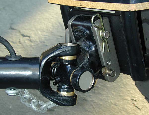

A ball hitch will not work. The trailer would fall over and never stay aligned with the bike. The hitch is a two axle universal joint. The vertical axle allows the trailer to move right or left as it follows the bike. It also keeps the trailer in line with the bike. When you lean into a curve the trailer leans with the bike. A horizontal pin allows the trailer to move up and down. Some commercially manufactured single wheel motorcycle trailers us an actual automotive universal joint like the one in the picture below.
Makes sense,I didn't know.Thanks..good way to do it.
