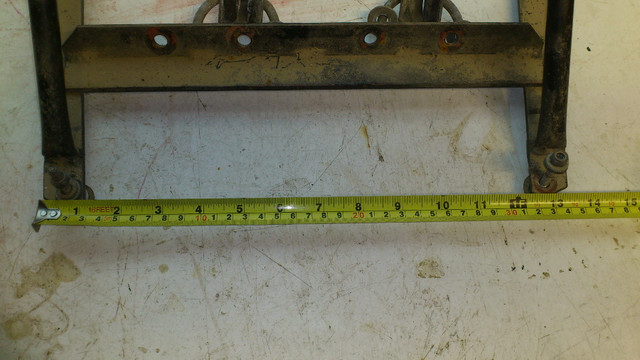

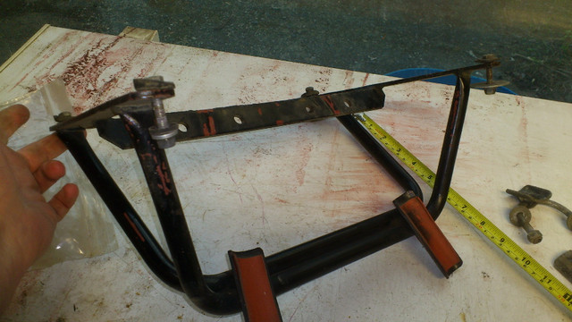

The bracket the fairing came with was "from a Honda" I was told so I welded some bits on it to make it fit the GS. There is a little bit of flex in the bracket which results in some wobbling when going over our lovely UK roads... Has anyone else on here got a GS850/1000 and has a photo of the bracket that they have?
See pictures below if I manage to upload them!

Thanks for the images! They are very different to what I started with & what I created!
Do the U-bolt clamps pull the angle section into contact with the front of the frame? I'm guessing that is why the black paint has worn off.
Yep, that's exactly what they do, with a thin rubber layer (piece of old tyre tube cut to size) under them to protect the frame paint.
I've no doubt it also helps the location stay a bit more located through some friction too, but I've never noticed it being a problem.
