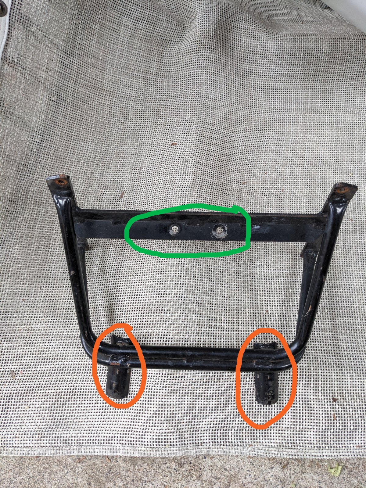

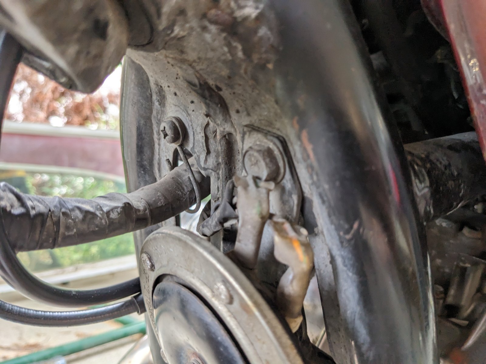

The bracket has arrived! After looking at the instructions @KGBnut sent me I'm fairly confident that I know how to install the bracket and where; The two mounting holes I've circled in green at the mounting points the horn hangs from, and the down tube sections I've circled in orange on the down tube with hose clamps.

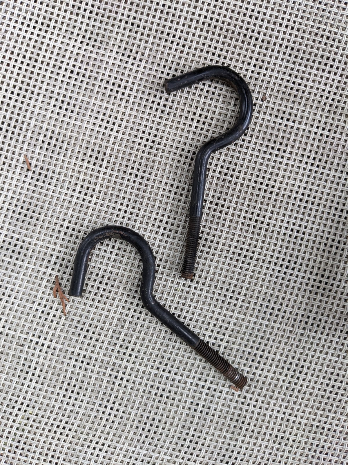

That being said, I do have some parts that I'm not sure of their function or placement. The bracket came with two threaded hooks that I'm sure are used to keep wires in the proper place, but I can't tell where they're supposed to be mounted and the instructions don't mention them. Does anyone know where they're supposed to go?

They may hook around the upper center frame tubes and pass through those two holes.
If the holes happen to line up with the horn bracket, then try to use them.

The lower 'half pipes' should marry up with the down tubes. They are then held in place with hose clamps. Double-check your wiring so nothing binds when turn the handlebars lock to lock.
