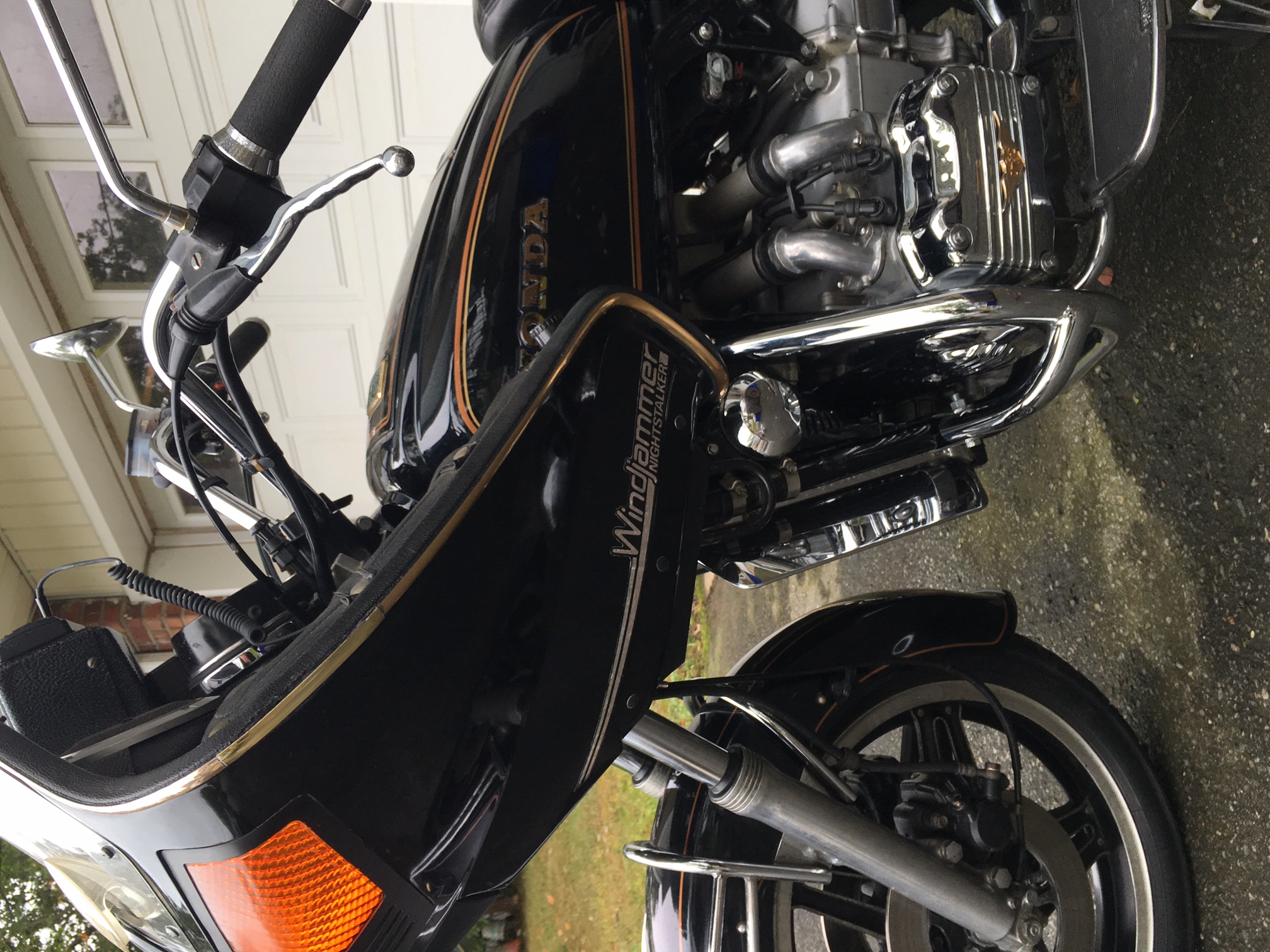

Went out for short jaunt in the morning to meet a friend for coffee and a roll; guy turned left in front of me on the way home, causing m to drop the bike. I had slowed down when I saw the guy coming from the other direction and about to turn (just not ebough I guess). We managed to avoid hitting each other..thankfully Broke a few ribs, got some roadrash, and a contusion. But I can say based on the other people I saw in the hostpital truma ward that I was (apparnently) very lucky. I wish i can say it was the first time I fell victim to the dreaded "left turner" (nearly the same thing happened to me on a different bike 21 years ago.) I am 50 now, have to wonder if I will ride again.
Amazingly, the bike is nearly undamaged, but for some road rash on the left side crashbar and scuffed fairing edge (see pic). I have a spare crash bar, and some gold trim that I used to repair some road rash on the other side. Being that it is my Dad's old bike, there is no question that I will repair the damage. The joy I have derived from finding, buying back and riding his old bike after a 24 year gap is hard to describe. I fear that joy will be replaced by fear now. I am not getting any younger, and can't relay on being able to heal as well the next time...assuming I am even as "lucky" the next time. It just sucks. Thanks for listening.
What I will say about the fairing is it is amazing how it and the crash bar (OK, engine guard) sacrificed themselves to probect the bike, and me too (quite likely keeping me from being pinned under the bike). In the case of the fairing, the damage was almost nonexistent. It is a testiment to its superb design.

Apologies for spelling...I am on painkillers. BTW, anything other than the edge scuff you see on the left fairing is just a reflection. Tyical of us types is to be more worried about the bike than ourselves, huh?

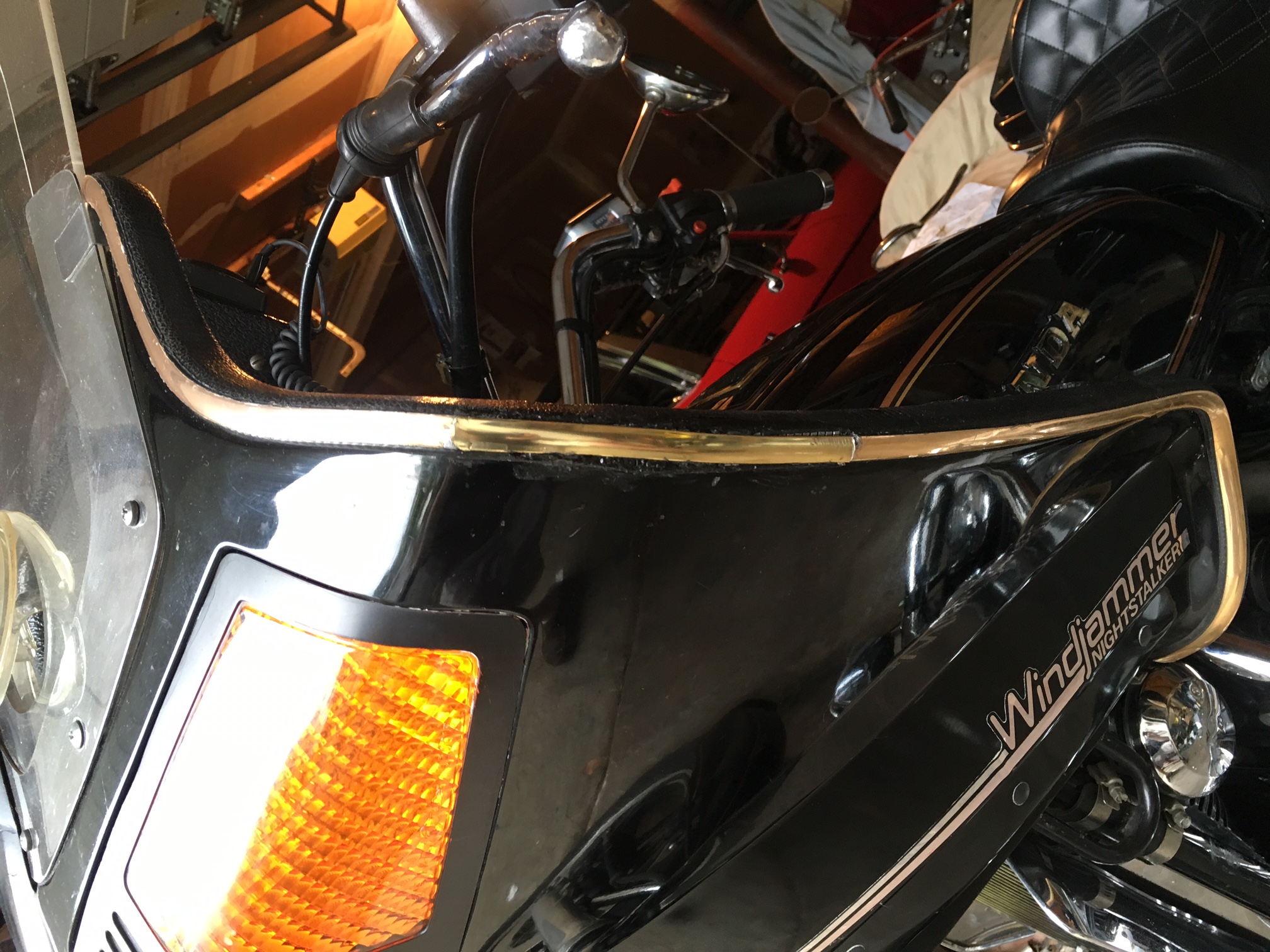

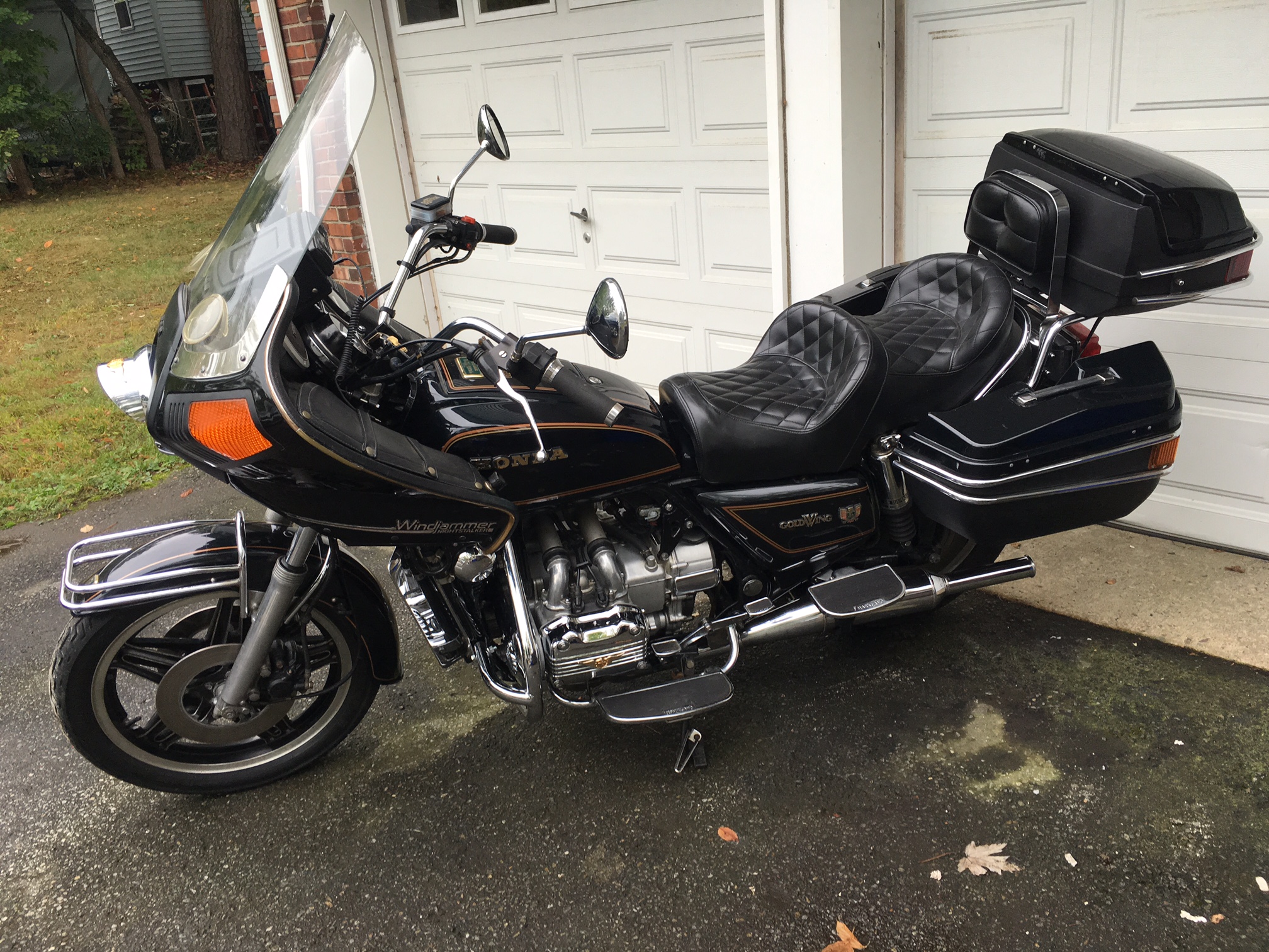

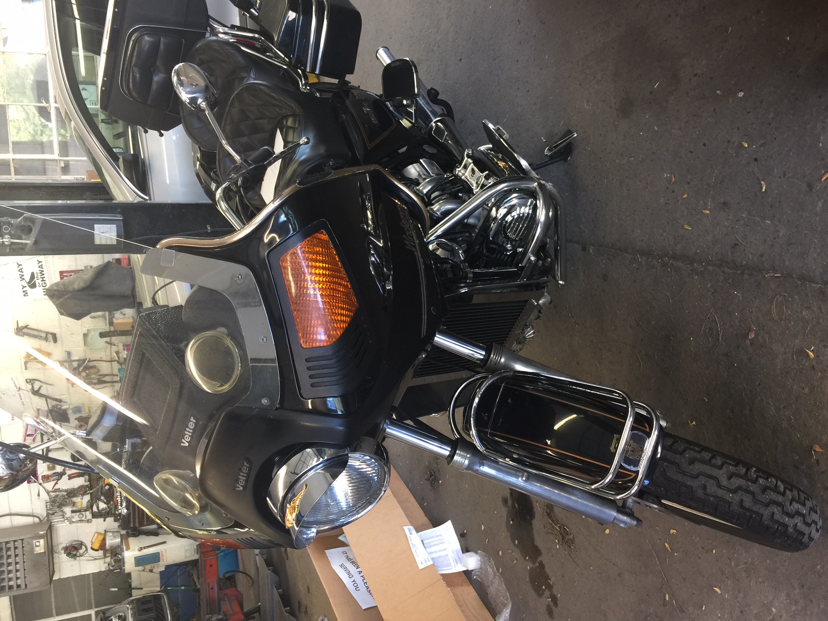

Well, here we are 9 days later after the accident. I am healing, slowly. Was able to replace the left side crash bar (had a spare). Was also able to do a decent repair to the fairing edge trim, using some leftover gold trim I had used to repair the other side after buying the bike. Did not come out quite as good as the other side, but it is serviceable. Have a left side mirror on order as well, as the orginal apparently hit the ground. There is s slight scuff to the clutch lever ball end, but mild enough that I can look past it. So the bike is healing, too. I even took it out for short spin up and down my dead-end block, and it seems to ride true and straight, so no obvious damage to the rims, forks, or frame. I feel a bit better, though still not sure how I wil deal with oncoming traffic moving forward (with abject terror?). Wife was less than pleased about my short trial run today, haw haw! Anyway, I am serious that I am more than a bit fearful that the "next time" I won't be as lucky.
ON EDIT: Uploaded a third photo (this one a closeup) showing my second attempt at fariing edge repair; I've decided I can live with it as is.

After looking at your last picture I dont think you had to lay your tank down!

For some reason your bike just looked BIG and that I wouldn't think anyone would want to pull out infront of you.

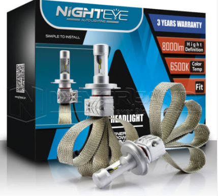

I use one of these...
And there's a 2"dia hole cut into the rear of the outer headlamp bowl. It might have squeezed in, but I didn't trust it to do so without damage, especially when the adjuster would be dragging it up and down against the shell. Also, the hole allows the feed cable and connector to be easily got at.
Ignore the totally bogus claims of lumen output on that box - all I can say it, it's 'adequate' and then some :)
Probably at least twice what the H4 lamp was putting out.
With these, you have to trust in a bit of luck that the position of the LED elements is close to the original position of the filaments, and that the overall reflector / lens and LED combination is good. Some combos just aren't and you will dazzle oncoming drivers, while thinking you've got plenty of light to see by. Ironically, if you had a good combo you'd have much more light to see by, as much less of it would be shooting off in uncontrolled directions.
The lamp unit I'm using is from an '80s Shogun, and is reckoned to be as good as anything produced by Cibie back in the day - Koyto cranked up some early CAD software to do it, and did rather well, by the looks of it. As a result of these being fitted to a million vehicles, they're unrecognised for what they are, and are as cheap as chips in your breaker's yard.
The Autopal one mentioned above is also reckoned to be a good one - as it should be, since it is a straight copy of one Cibie made forty years ago.
