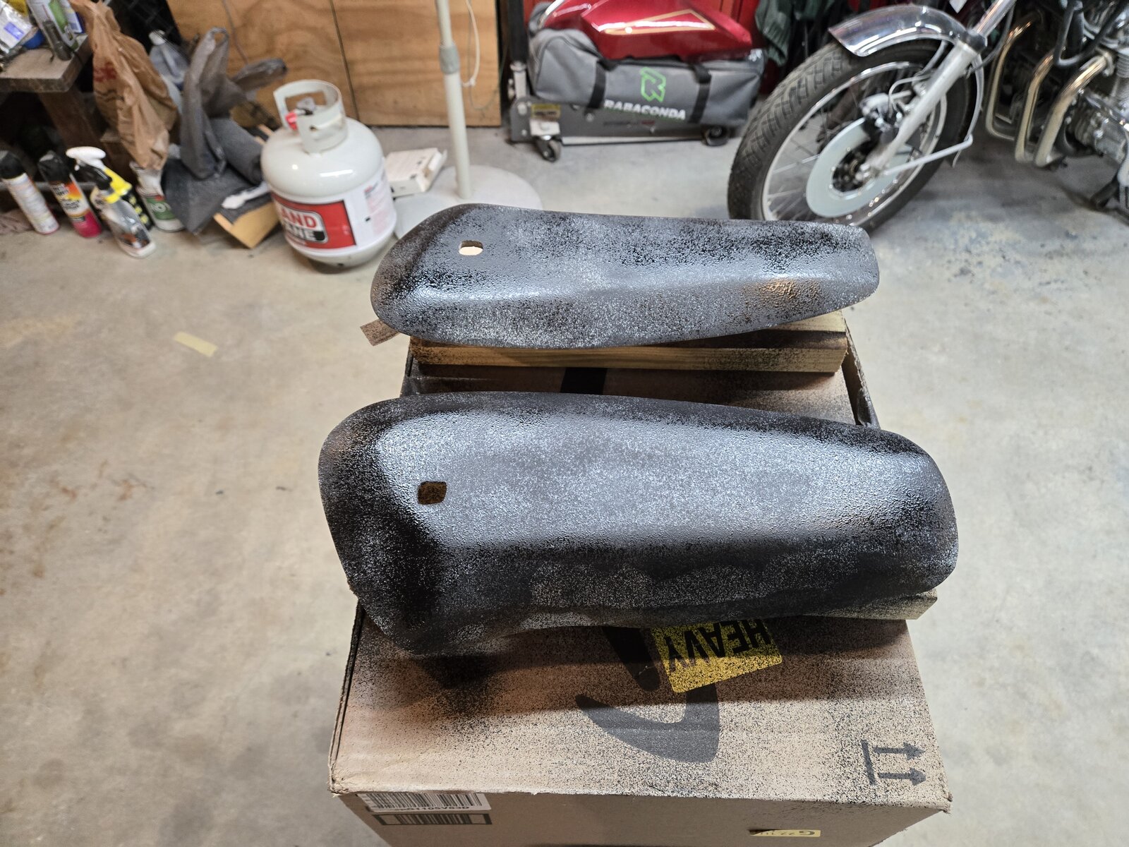

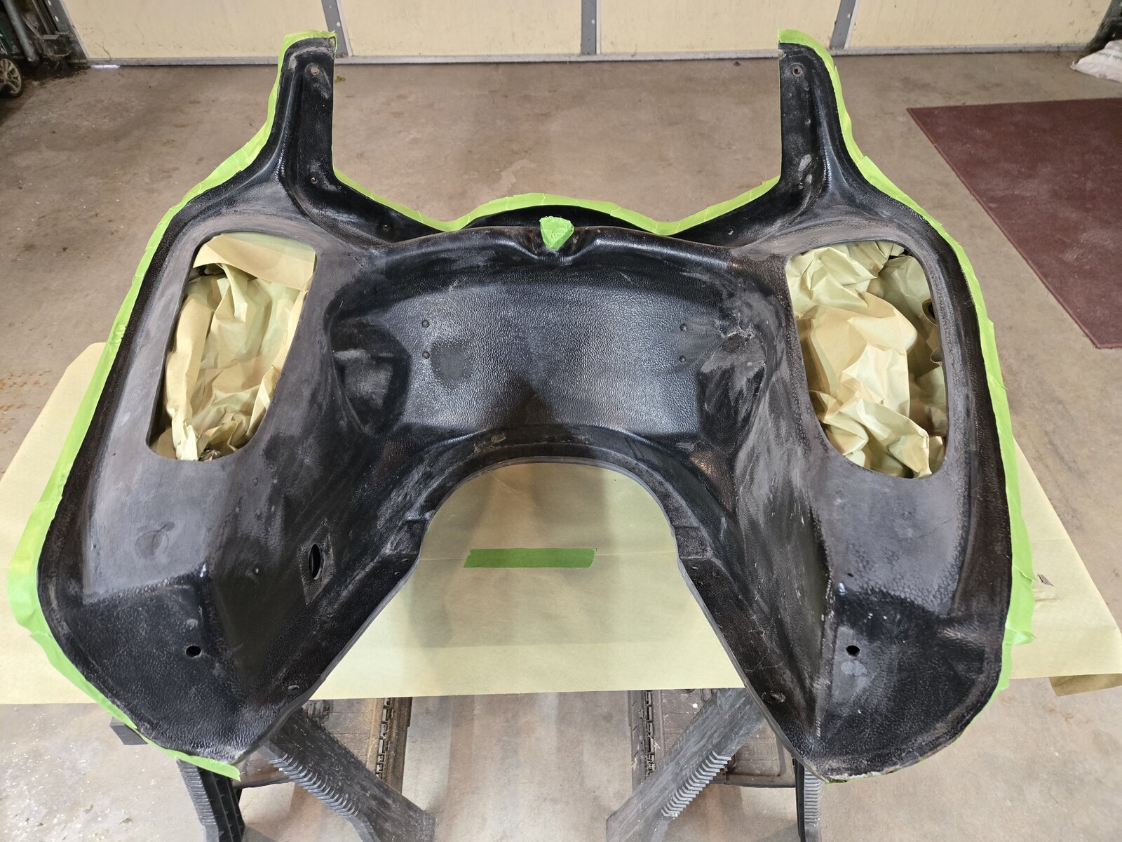

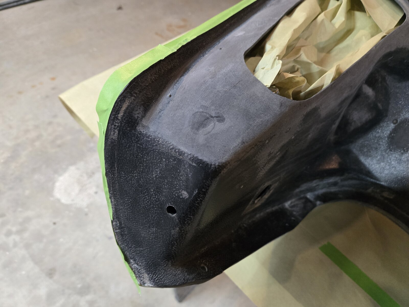

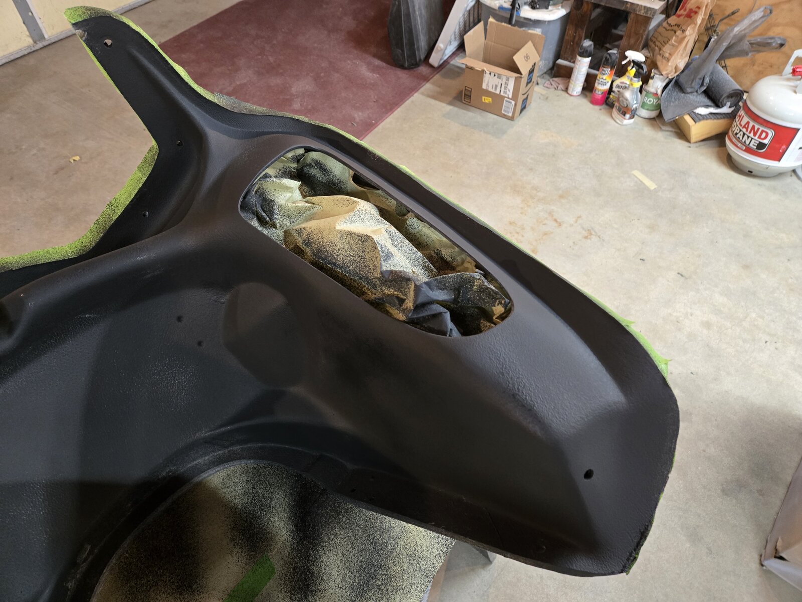

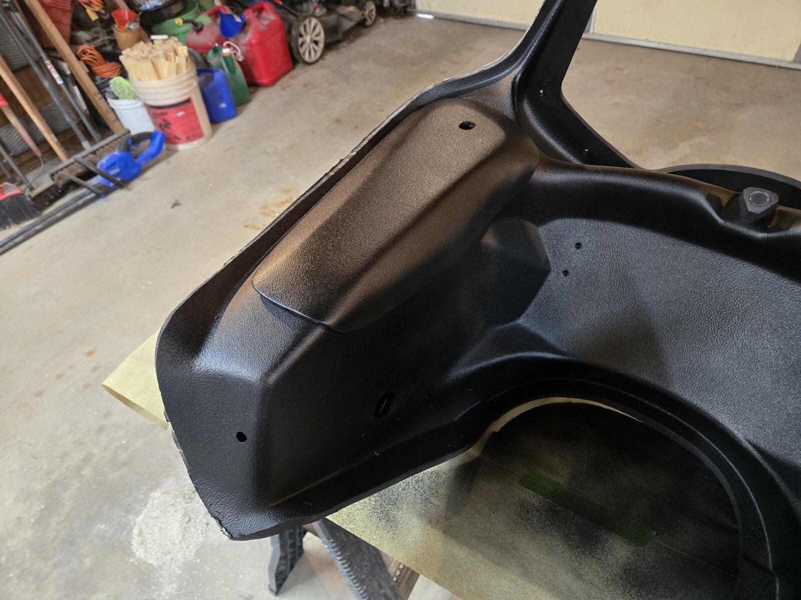

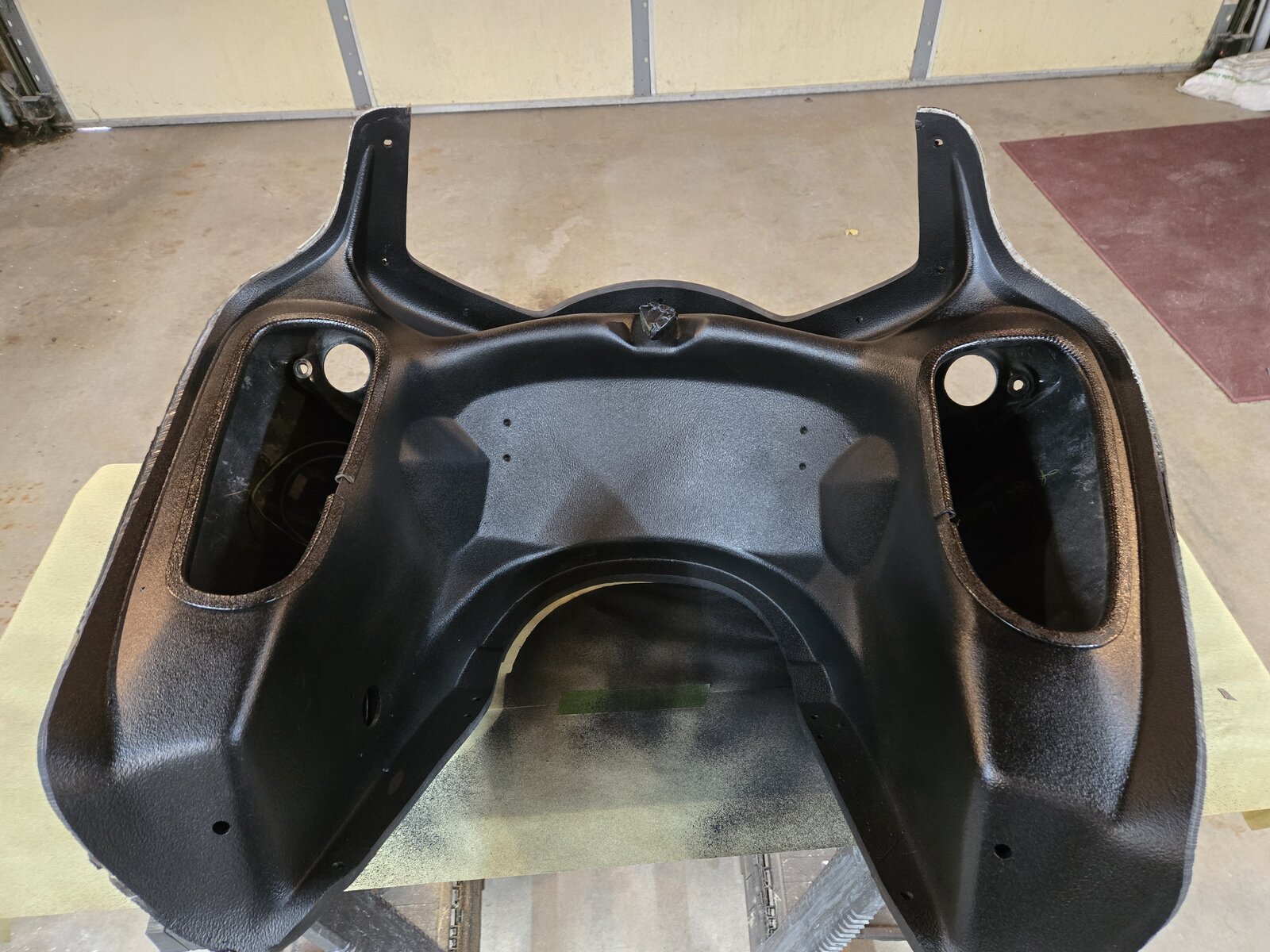

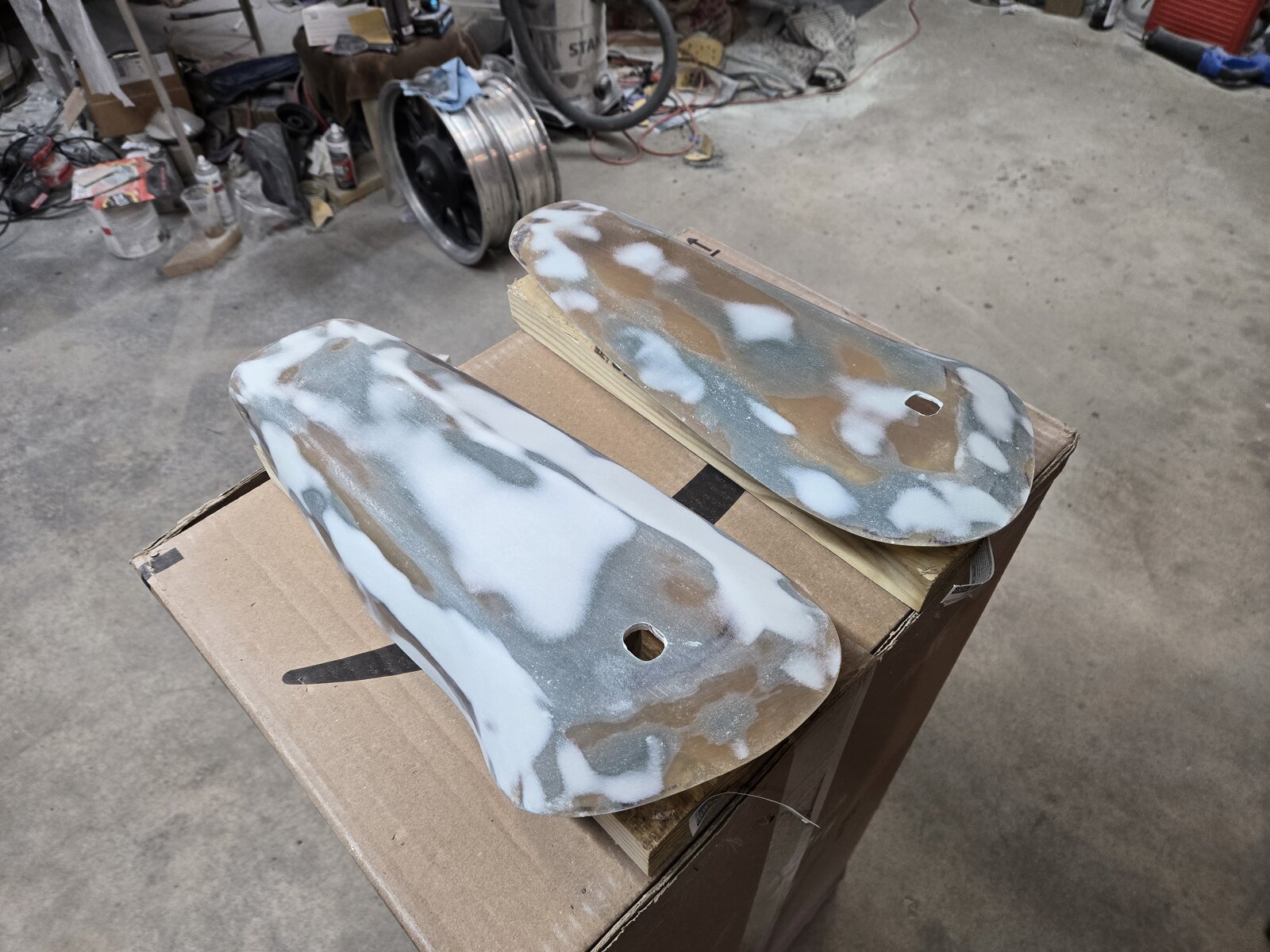

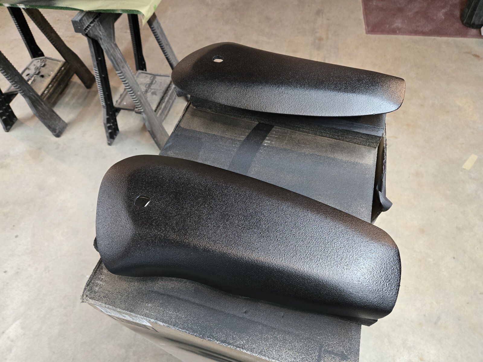

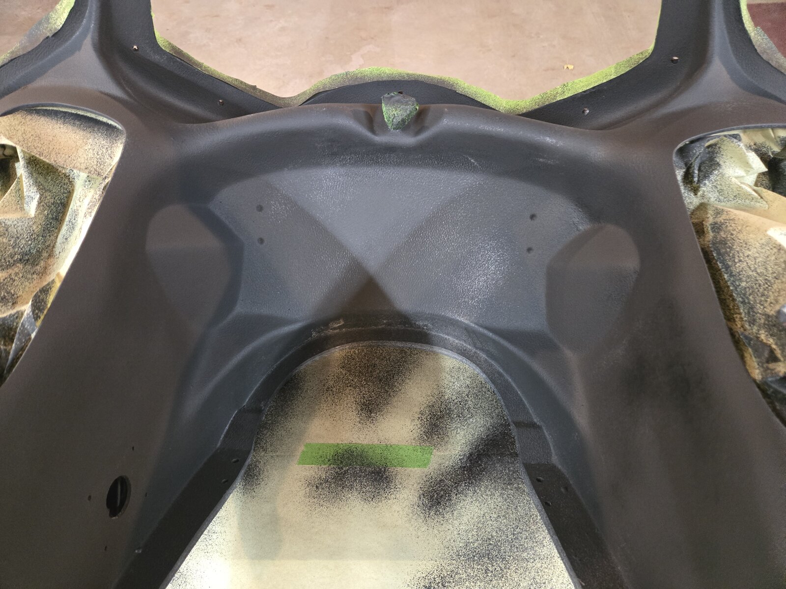

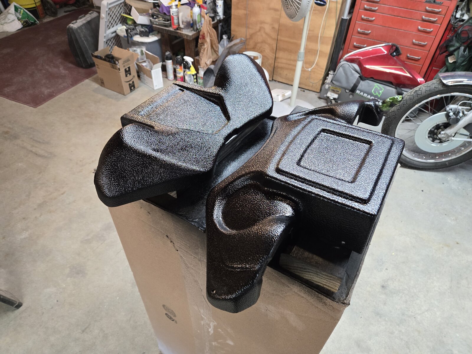

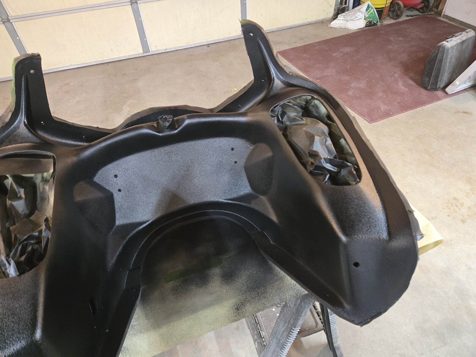

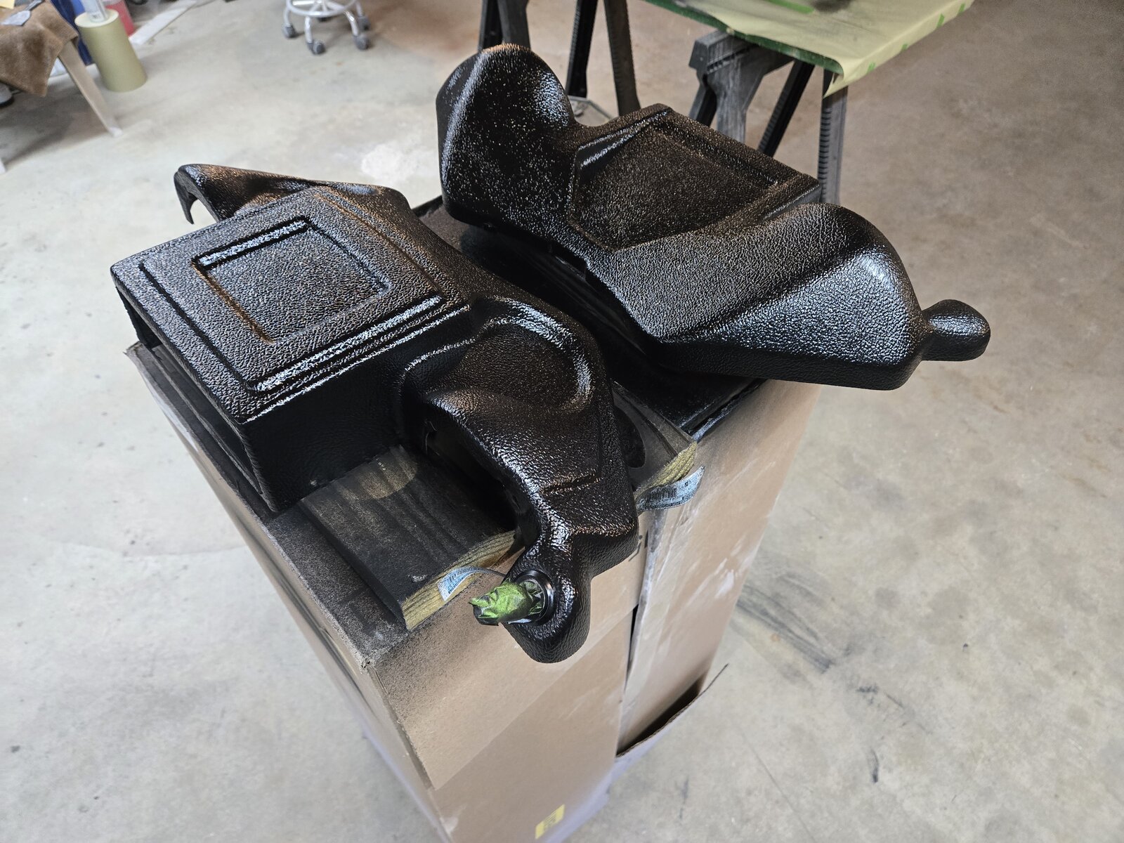

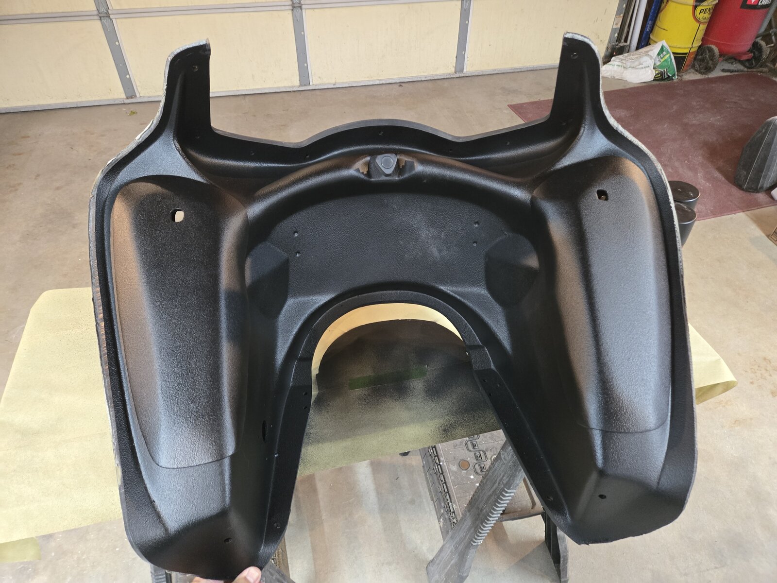

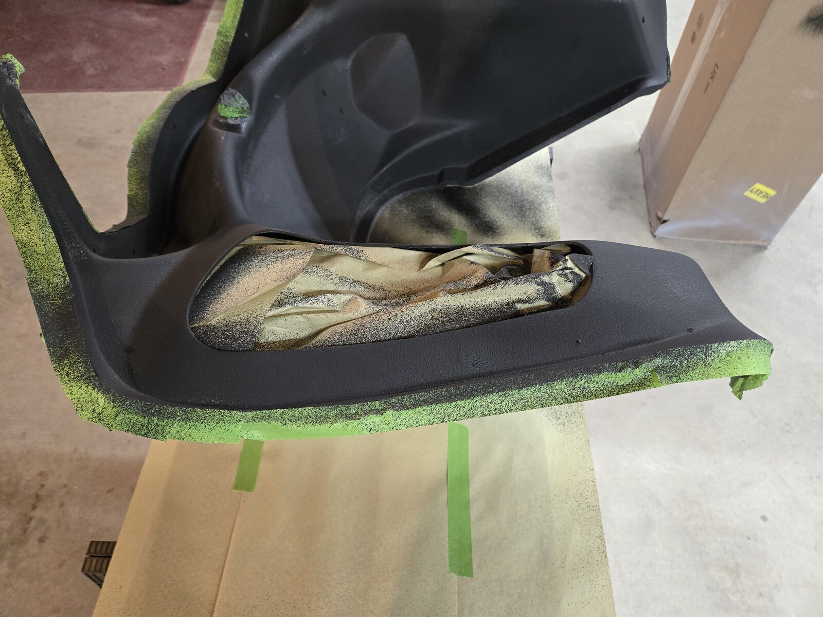

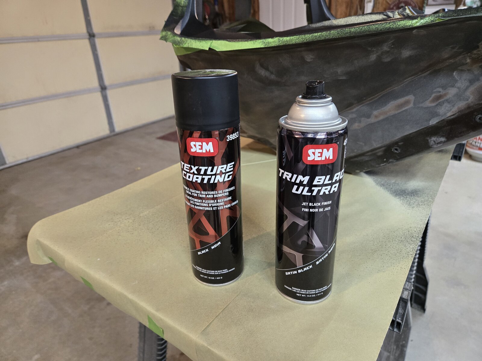

Over the past 3 or 4 months I've filled in the holes for the snaps by the left fairing pocket, filled in the cigarette lighter hole, and made a new set of lids out of fiberglass...Before winterizing two of our other bikes and rearranging the garage to "winter mode", I shot the lids with a texture product and paint...I used SEM texture in an aerosol can and their satin trim paint...I was of course hoping for the best, but also apprehensive it would be what I wanted....
As you'll see in the pics. It turned out great!!!....
