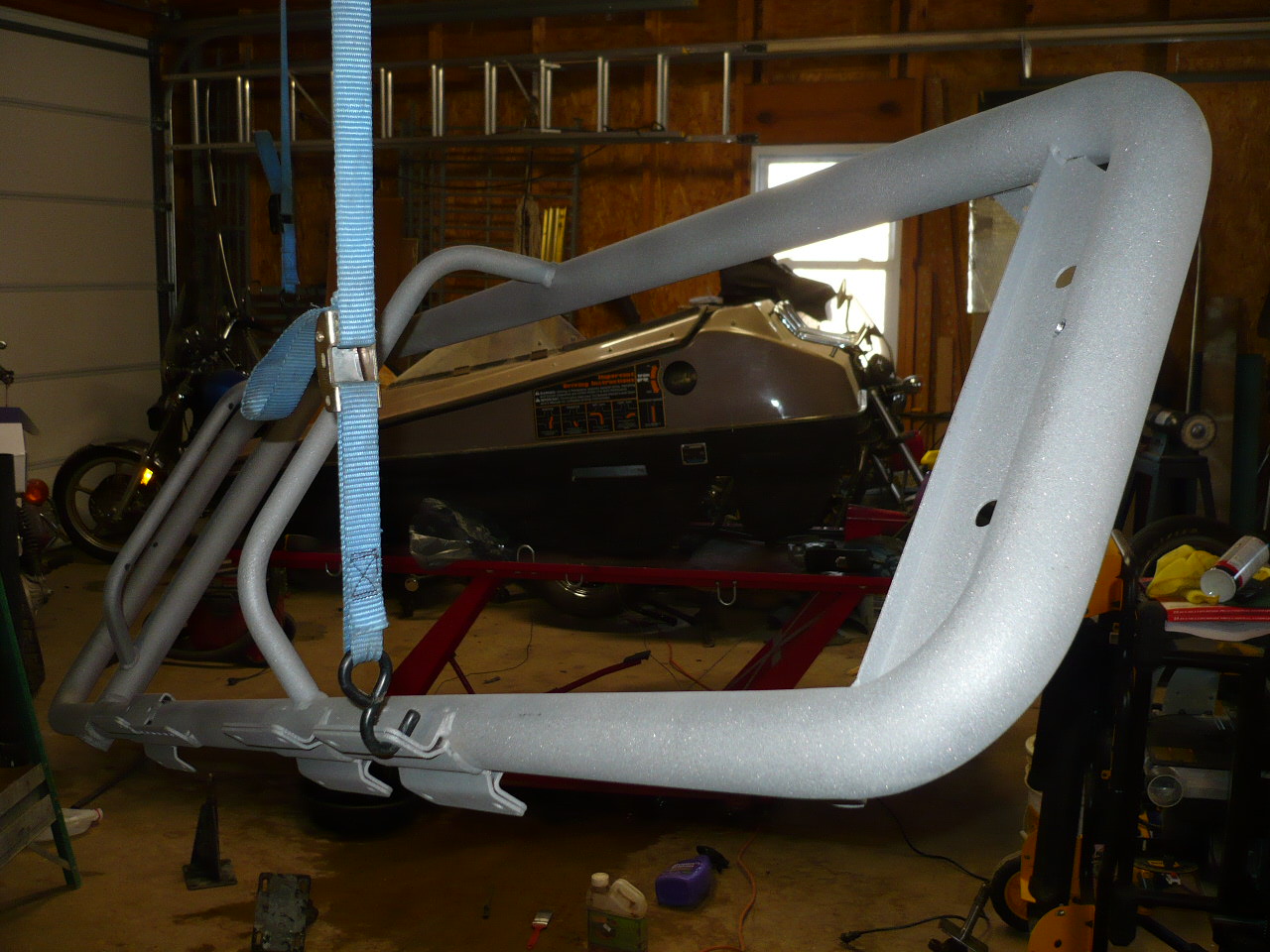

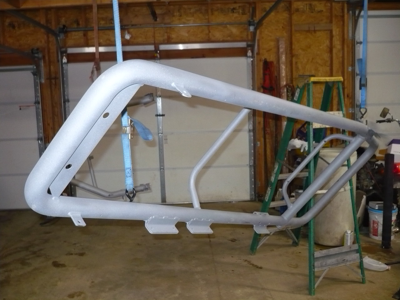

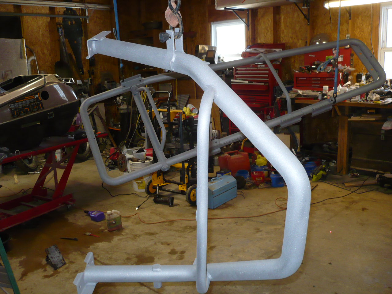

Time for pictures;

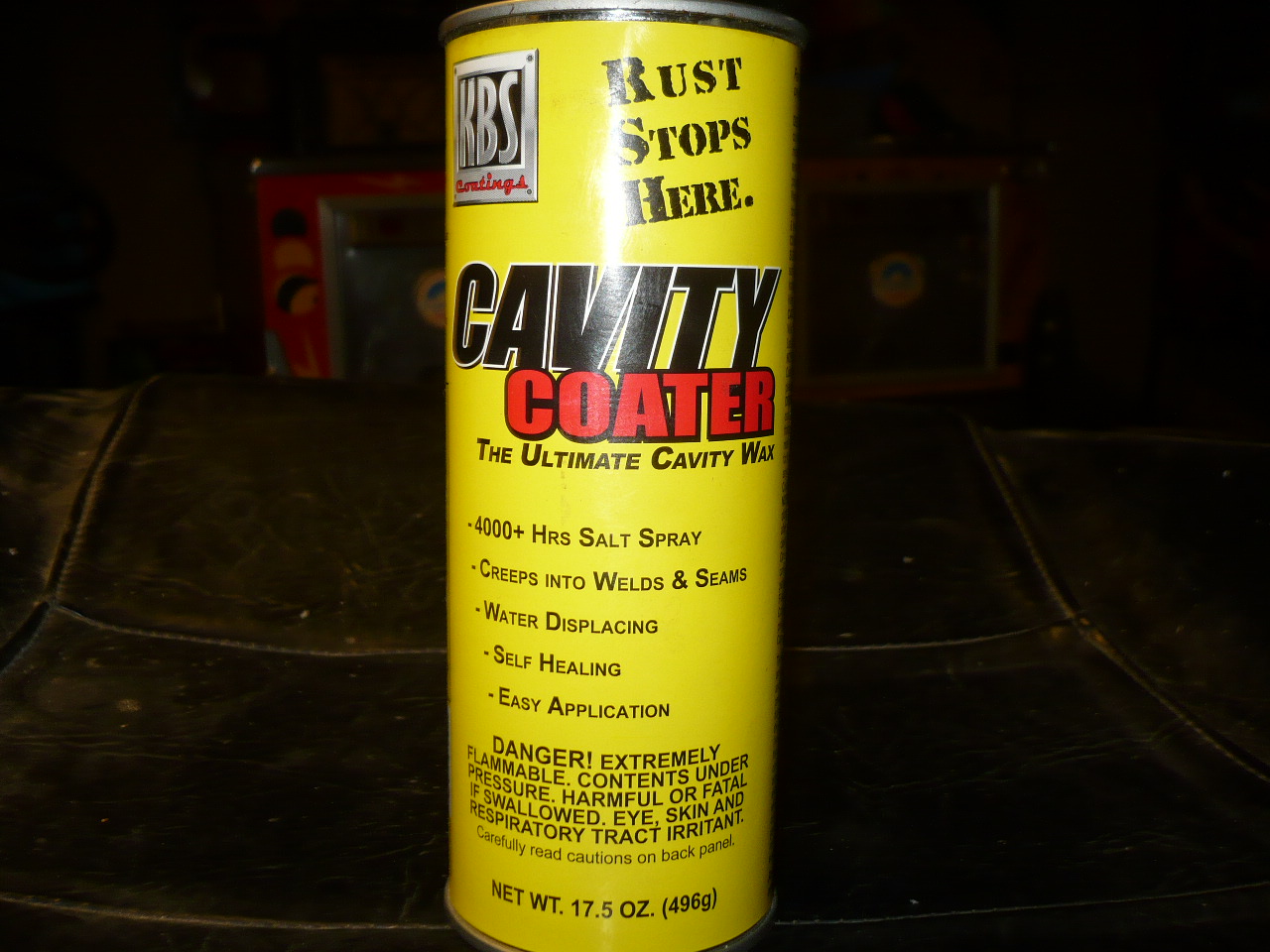

The frame back from the blasters. P1030178.JPG This is what i used to cover it with, I have used other products from them
with good results. P1030179.JPG P1030180.JPG While the end results are acceptable If I were to do it again I would probably opt
for a disposable spray system. The coating was much thinner than I expected for something you brush on making it hard to avoid
runs and drips. It is not UV stable so I will be overcoating with a standard paint.

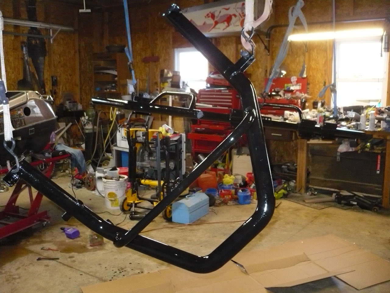

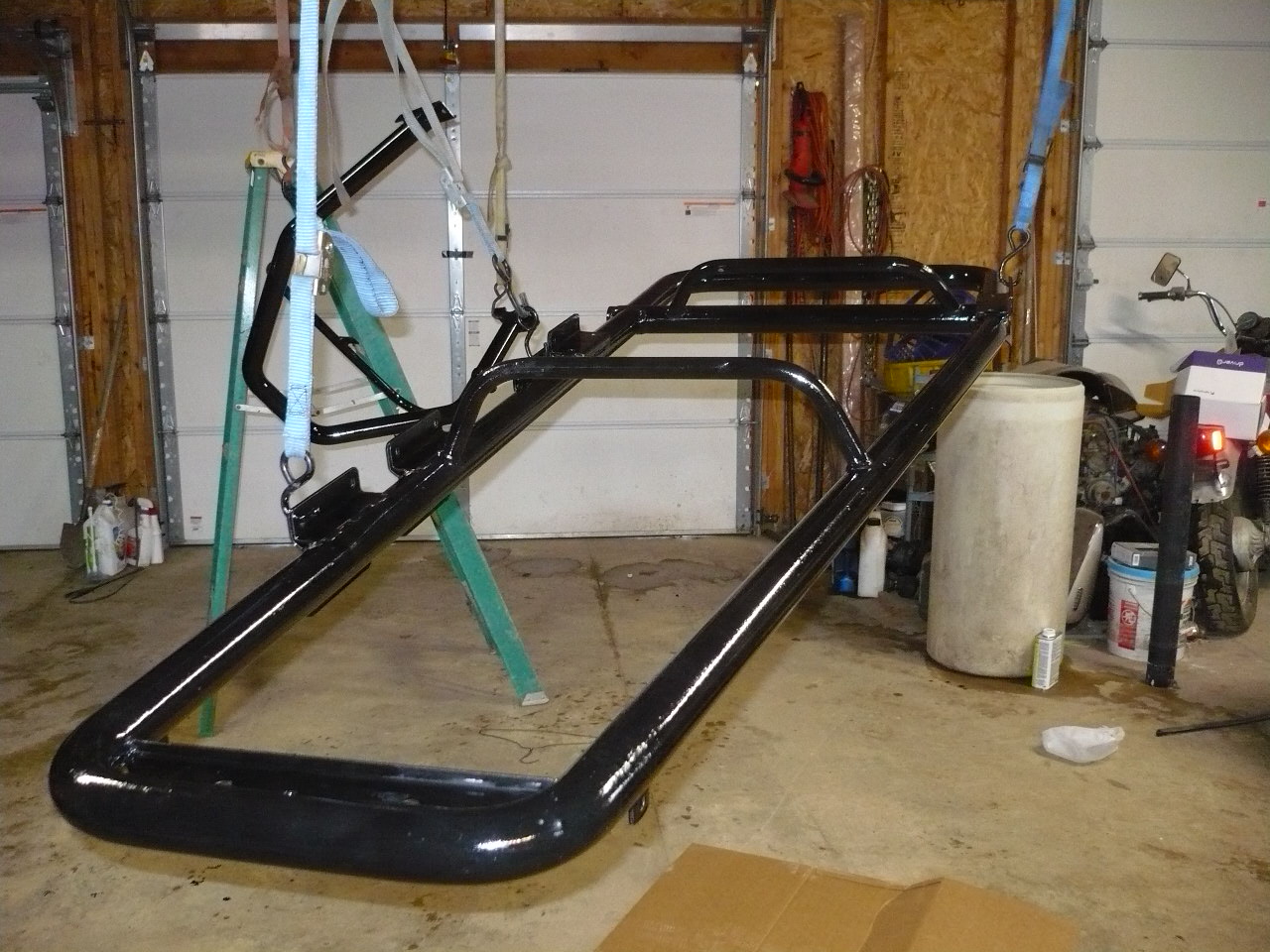

Ok time for an update.
After getting most of the frame done I sent the top body out for paint and started working on bike-side mounts.
I wanted to coat them the sane as the frame. When I went to get the body from the painter I was not pleased with what I saw.
hade a long talk with him and he agreed to redo it. Two weeks later I pick t up only to find sags and dimples in the clear cote needless
to say I was depress! Kind of pushed it to the back of the shop while I considered what to do with it.
Windbuchse; I have had other thing power coated and found that it chips nearly as easily as paint and if improperly applied the steel will rust
under it and cause flaking.
