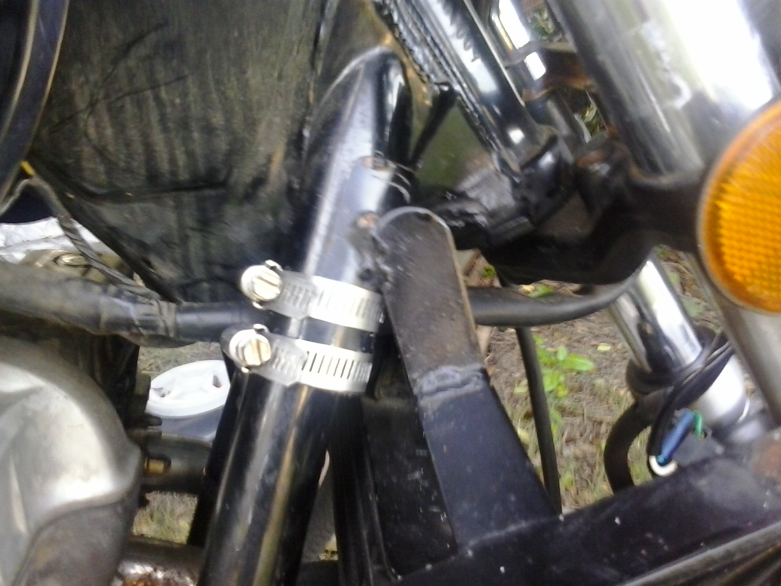

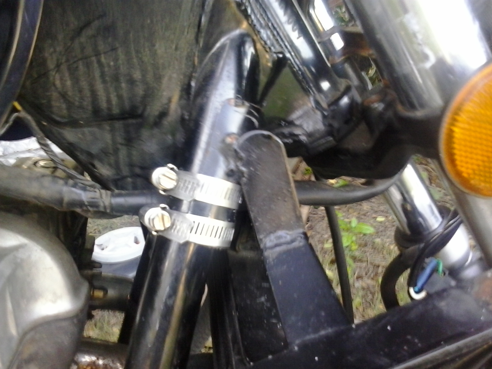

I am fitting the same fairing to a z1. Can you post some close up pics of the frame mount?
The original windscreen on those had some sort of hardened coating on them, Because of that, they are resistant to scratches, but incredibly difficult to polish. I tried to have a local glass shop make one years ago, but they couldn't get the curve right without it cracking. There are some companies that make new replacements, but they are not cheap. I got my last few on eBay. I see both new and used ones up there now. Hopefully you can find one in Canada to save on shipping.
As for the trim, the only trim that I have found that works right is the stuff sold by Vetter. Unfortunately, Craig and Carol shut down their online store not long after his accident. When last heard from Carol, she was talking about moving to an eBay store, and maybe one of their sons were going to run it, but I haven't seen it yet. They are both mostly retired.
I'll get some pics later today, and post them in the next day or so.
The fella that had the bike before Brazed/welded the bracket on the frame.
Famous last words ( " It ain't goin no where" )
They normally were clamped on with hose clamps or U bolts. At least that's what I remember when I had a windjammer on a KZ back in the 80's.
Hello Iboone
I hope these pics help a bit. The bracket is held in place on the bottom by hose clamps. The top looks like it should have U bolts holding it in place.
The friend I got the bike from, chose to weld it on instead.

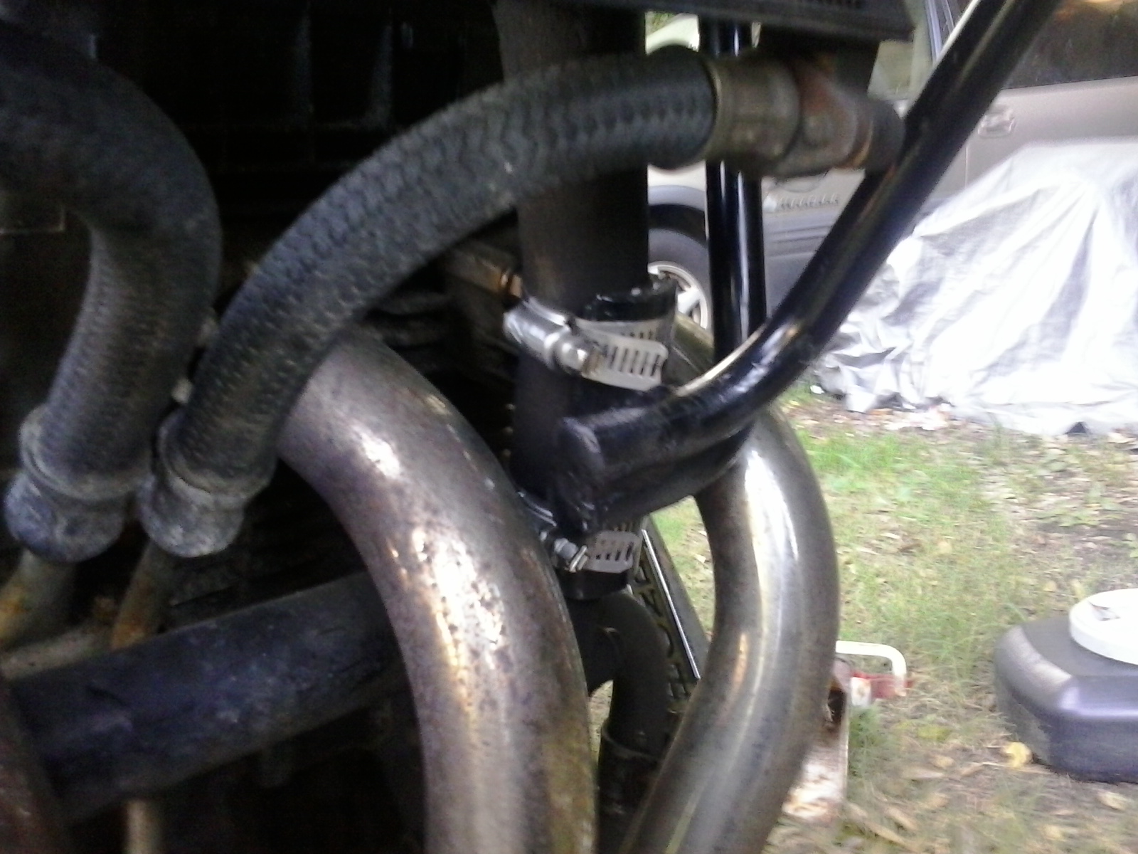

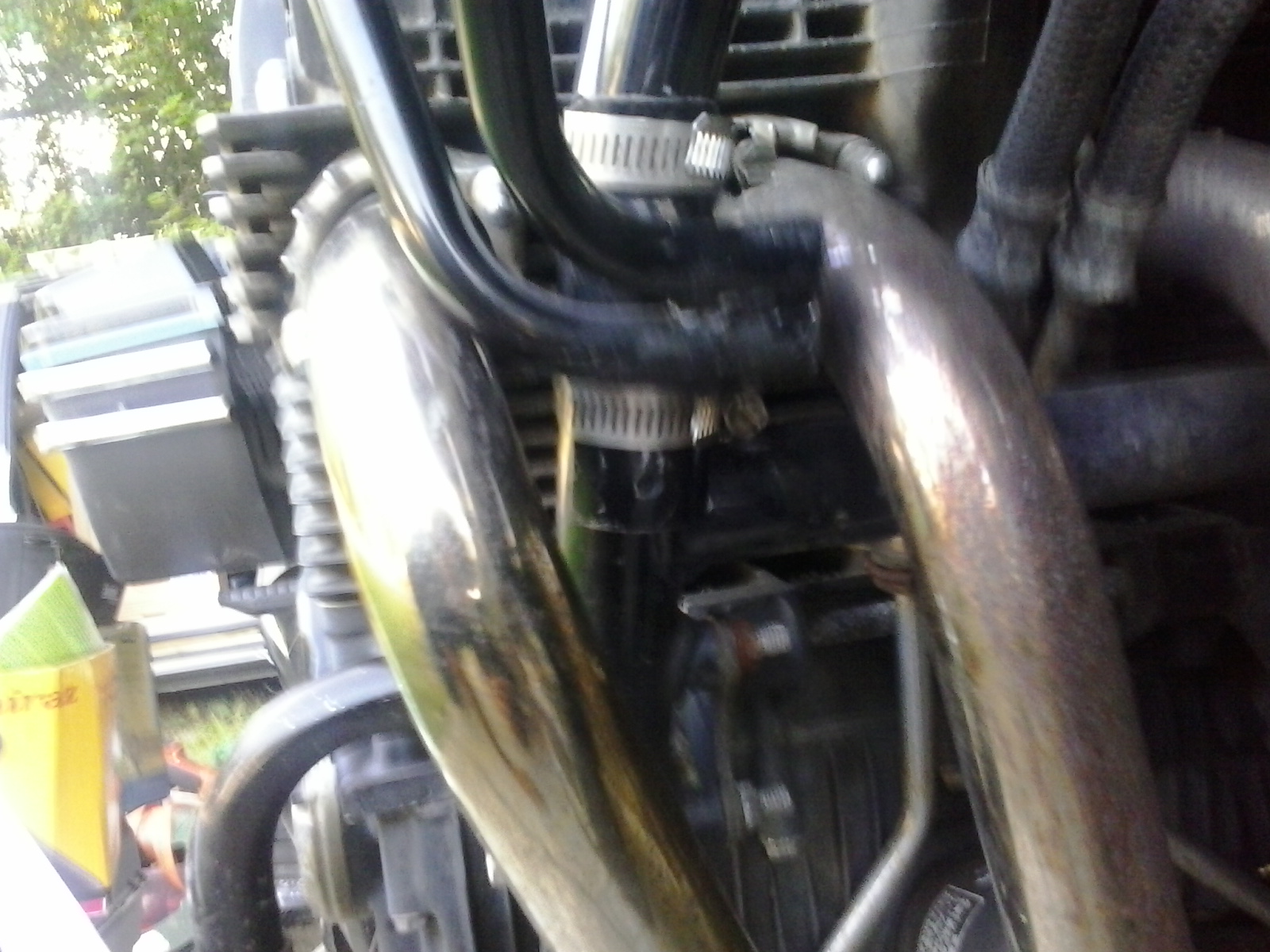

In case this helps, there are a few close-up pics in here where I used two clamps for each mount foot:
It looks like the bottom of this bracket had to be cut and removed to mount properly is that correct?
That mount on my bike, yes. The mount was from an '82 Honda 750, and my bike is a '96 Nighthawk 750. The exhaust pipes sit at a different height relative to the frame, which is why I cut it.
You really should read through my thread about the installation. I posted these pics only to show how the hose-clamps attach the mount to the frame. As noted, some mounts use U-bolts.
