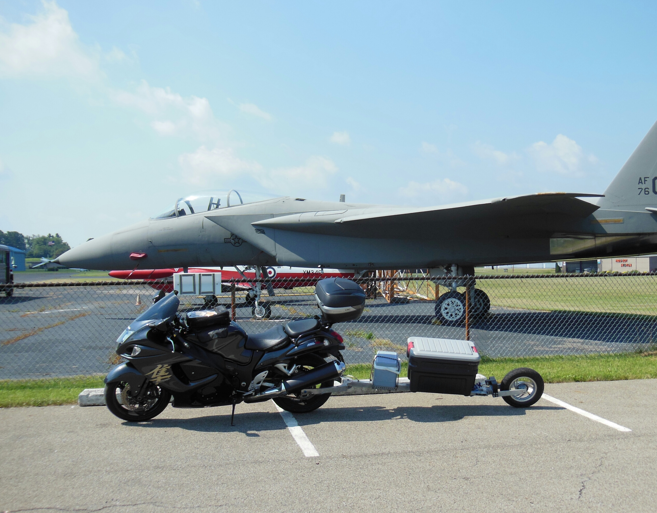

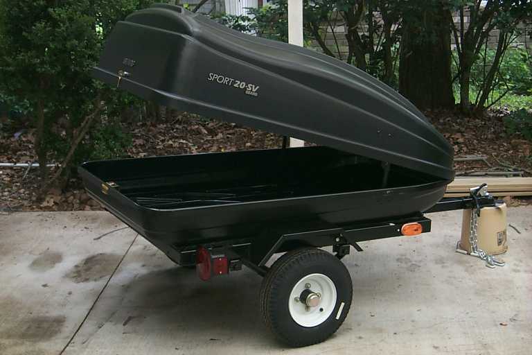

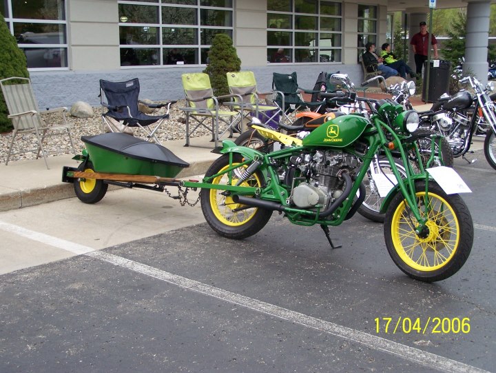

I'm thinking of building/buying a trailer to pull behind the bike. I've heard of people using "U" joints from a truck, or a regular ball type hitch for pulling a trailer. Any recommendations? I'm not opposed to building and fabricating.
I was thinking something like this,
or this...
