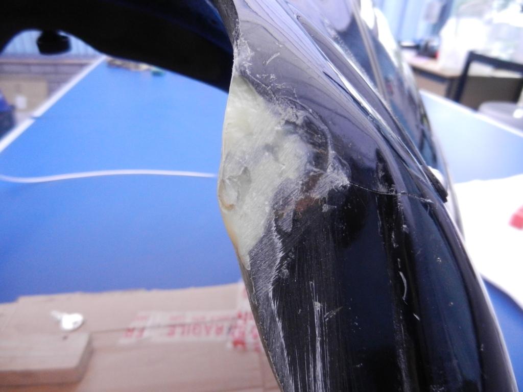

Repair to WJ SS mounting point with Devcon plastic welder, seems to have done the job well.
Mounting area before repair, mount bracket is from Rickman hence being short of the damaged area.

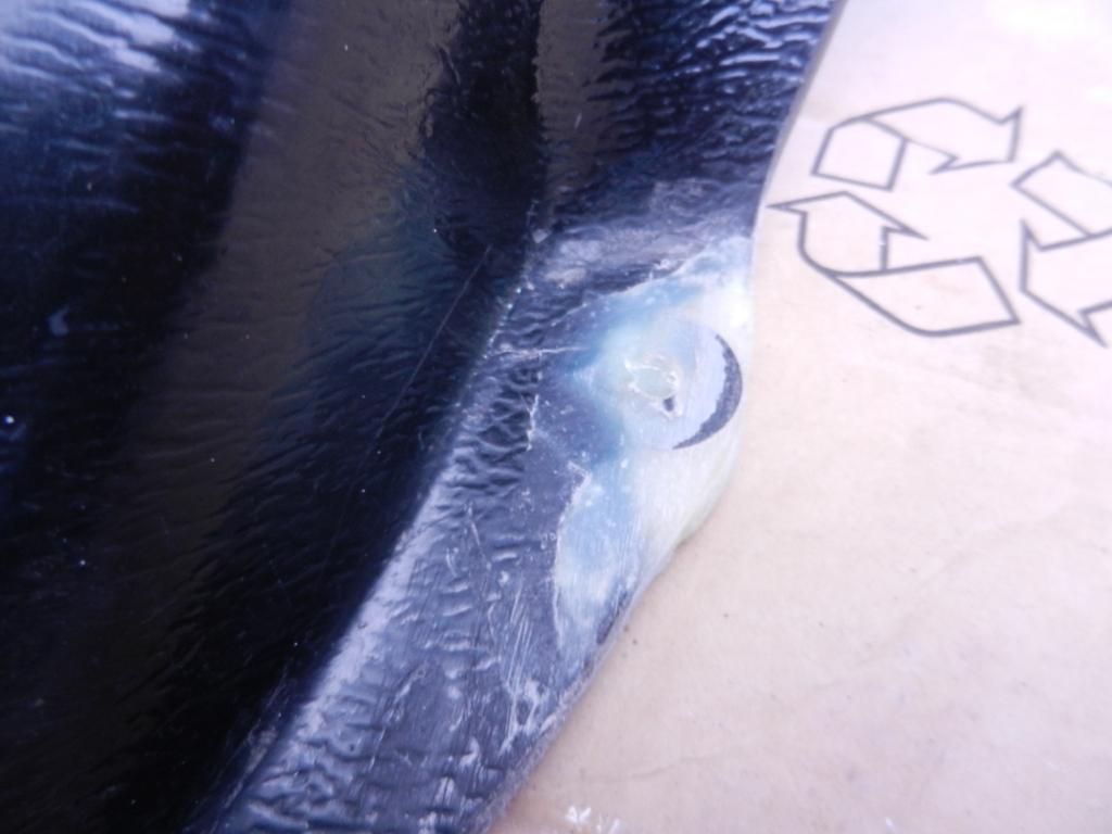

After repair, I embedded a nylon spacer in the Devcon to give some extra support to where the mounting hole will be drilled if I ever need to use it (not required with my Rickman / Vetter combination mount bracket)
I can only seem to get Devcon plastic welder here in Ivory colour but believe in the US it may be avaliable in black also.
